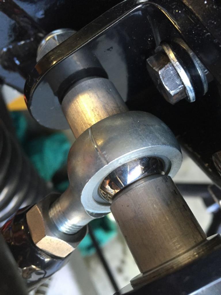

Attached the picture of the provided rodends.
There is no brand mentioned on the parts.
They claim being using this particular ones in racing.
With this kind of endplay there is no chance to pass the MOT inspection.

Andy,
Having no brand marking may indicate the inferior quality you've encountered. The Aurora series you reference would be a good choice at a reasonable price. I have used them on some race cars of mine with pretty good results. The very best are NMB ones at $100+ in the size you reference. NMB's last a very long time, but obviously are very expensive if you're replacing several rod ends.
