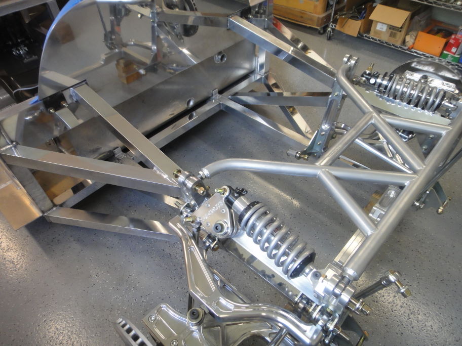

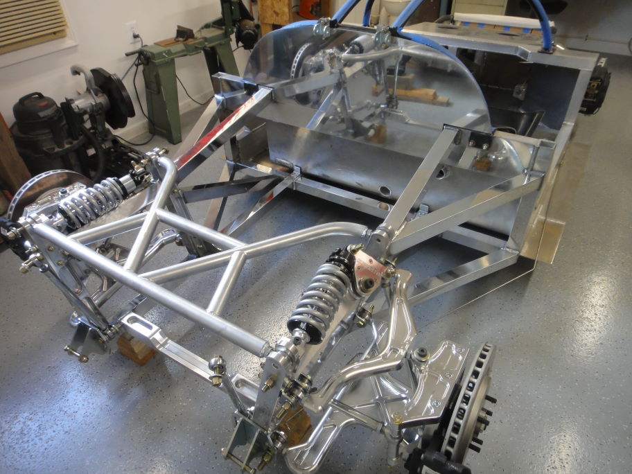

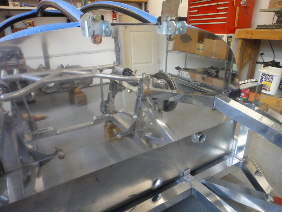

Shortly after our car arrived in the shop, I looked at the empty engine bay and thought it would be cool to spend a couple of hours polishing the aluminum.
Ignorance is bliss. 50 hours later, I'm not sure it was the brightest idea I've ever had.
Of course, much of that time was spent in do-overs. I've never polished aluminum before and there was lots of trial and error.
Here's what I learned and did. Hopefully it might save other inexperienced masochists some time:
There are three types of structure which asked to be polished:
i) The tubes
ii) The suspension bits
iii) The firewall (sheet aluminum).
Each one required a slightly different technique.

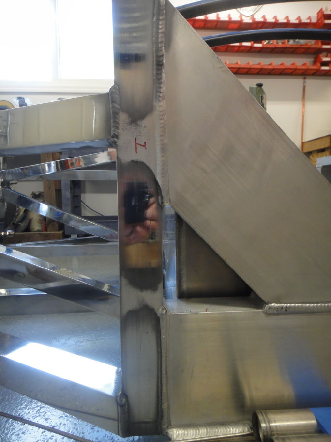

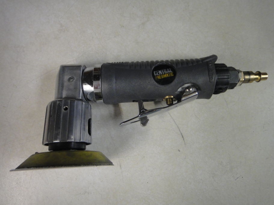

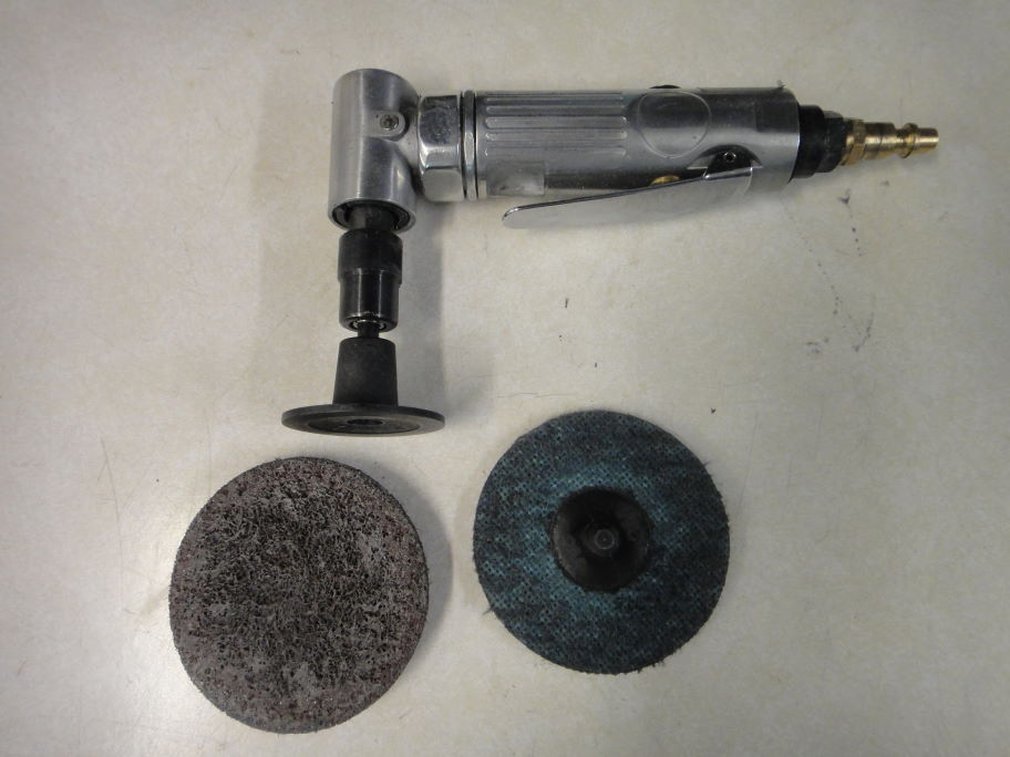

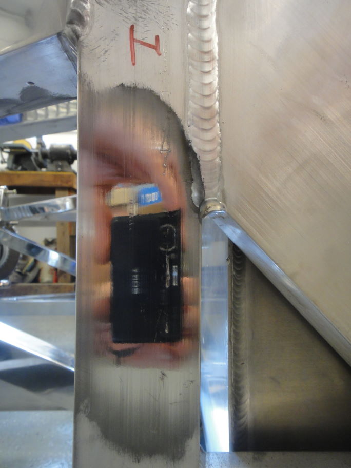

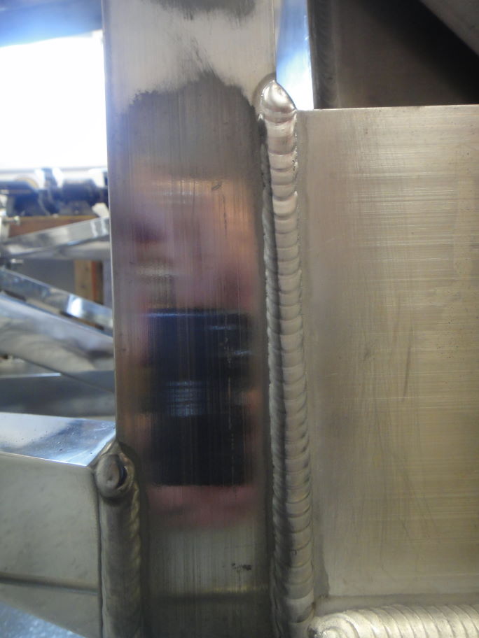

i) The tubes have lines in them which are left over from the manufacturing process. While they can be polished to a shine without removing the lines, in order to get a mirror finish, the lines need to be removed first. This was done with a right angle die grinder using two different 3" scotchbrite wheels - a purple one (more coarse) to remove the lines, followed by a green one (less coarse) to remove some of the marks left by the purple one. After this, an air driven polisher with a 3" foam backing pad and 1200 grit 3M hookit discs was used to remove the scratches left by the green scotchbrite pad. As it turned out, this was probably a bit too fine, as the pads loaded up pretty quickly. Probably something around 600 grit would have been fine, but I had purchased a box of 50, so was determined to use them up. At this point, the tubes were ready for polish. I tried a few different brands and polishing methods, but settled on Nuvite "C" grade with a 4" cotton disc or cotton cone in a drill turning around 2,000 rpm. Note that the cotton disc loads up with polish after several minutes of use and then starts being less effective. When this happens, it needs to be cleaned with a "rake", by dragging the rake across it in the opposite direction from the direction it spins in. Once under way, this needs to be done every few minutes. You can get some good tips on the actual polishing technique from www.PerfectPolish.com. I found it took 3-5 passes before the tubes had a nice mirror finish, but there were still some small swirl marks and cloudiness in spots. These were removed using Alumapolish and either hand polishing with microfiber cloths or using a 3M 3" Perfect-It sponge pad in a drill. I found that even with the microfiber cloths, it is easy to put scratches in a mirror finish, so a light touch is required at the final stages.
ii) The suspension bits were done using Alumapolish and microfiber cloths. No pre-sanding was necessary as the parts have already been machined smooth. These bits are probably the biggest bang for the buck in terms of not taking much time and coming out with a nice gloss.

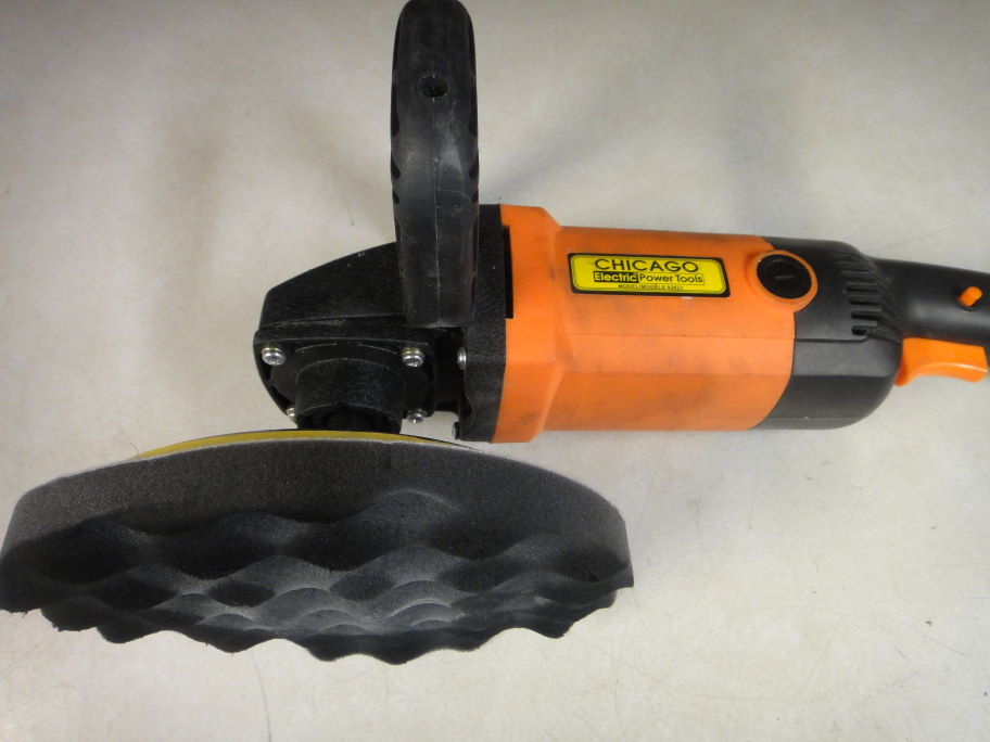

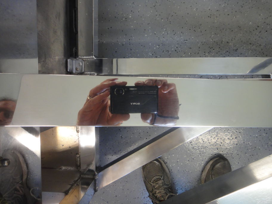

iii) The firewall is sheet aluminum and doesn't have the manufacturing marks that the tubes have. That being said, they did have some scratches (gouges) in them, which were removed with the scotchbrite wheels. They also have a grain which will show through unless mechanically sanded smooth, first. To do this, a random orbital sander and 6", 400 grit hookit discs on a foam pad was used. After sanding, a rotary polisher with a 7" 3M Perfect it pad was used along with Nuvite C. 3 passes were needed to get a mirror finish. This was followed by Alumapolish and another 7" Perfect it pad. Any leftover polish was removed using lacquer thinner and a blue paper shop towel. The blue towels are much better than normal white paper towels, which easily leave scratches. The blue ones will scratch, too, so a light touch is required. The lacquer thinner itself leaves a slight cloudy depost behind, which was removed with a dry microfiber cloth (again, a light touch is required).

2) Air Polisher: Harbor Freight, Harbor Freight $30: Mini Orbital Air Sander

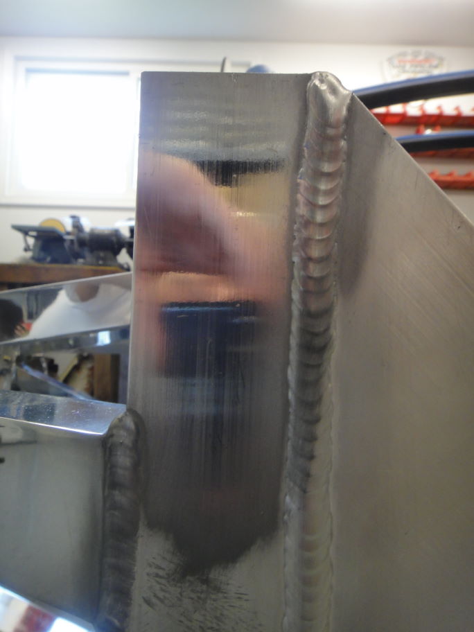

I tested one patch for each polish on the passenger upright at the front of the engine compartment. This gets covered up on a finished car, so I hadn't done anything to it before the test.
The top patch was done with the Purple (California Custom), the middle with Busch's and the bottom with Alumapolish. Each area was applied by hand with a microfiber cloth and polished for approx. 2 minutes before wiping clean.
As you can see by comparing the pictures, the Purple and the Alumapolish do comparable jobs, but the Busch's is a clear winner; you can almost make out the reflection of the lettering on the camera used to take the picture. Because of the extrusion marks on the aluminum, I don't think you would ever get a distortion-free mirror polish using the Busch's by hand, but if the extrusion marks were sanded smooth first, you could probably do it.
