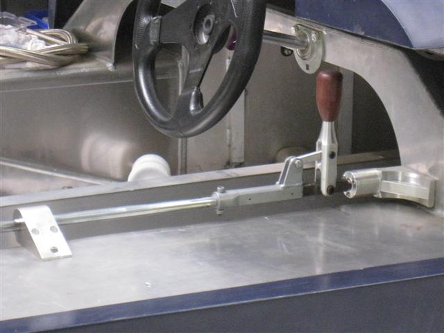

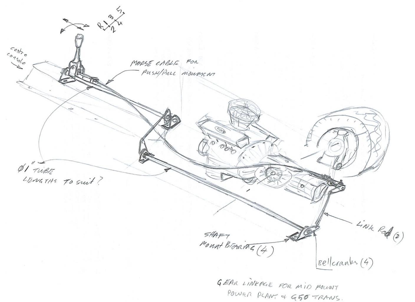

DRB uses this set up which works really well --the shifter is usually on the centre console but can also be used to the right of driver

Thanks Chris.
I was not so sure for what ever reason I could do that set up on the right, so thats good news. Chris do you have a all rod setup? I kind of like that idea of just rods and joints and pivots.

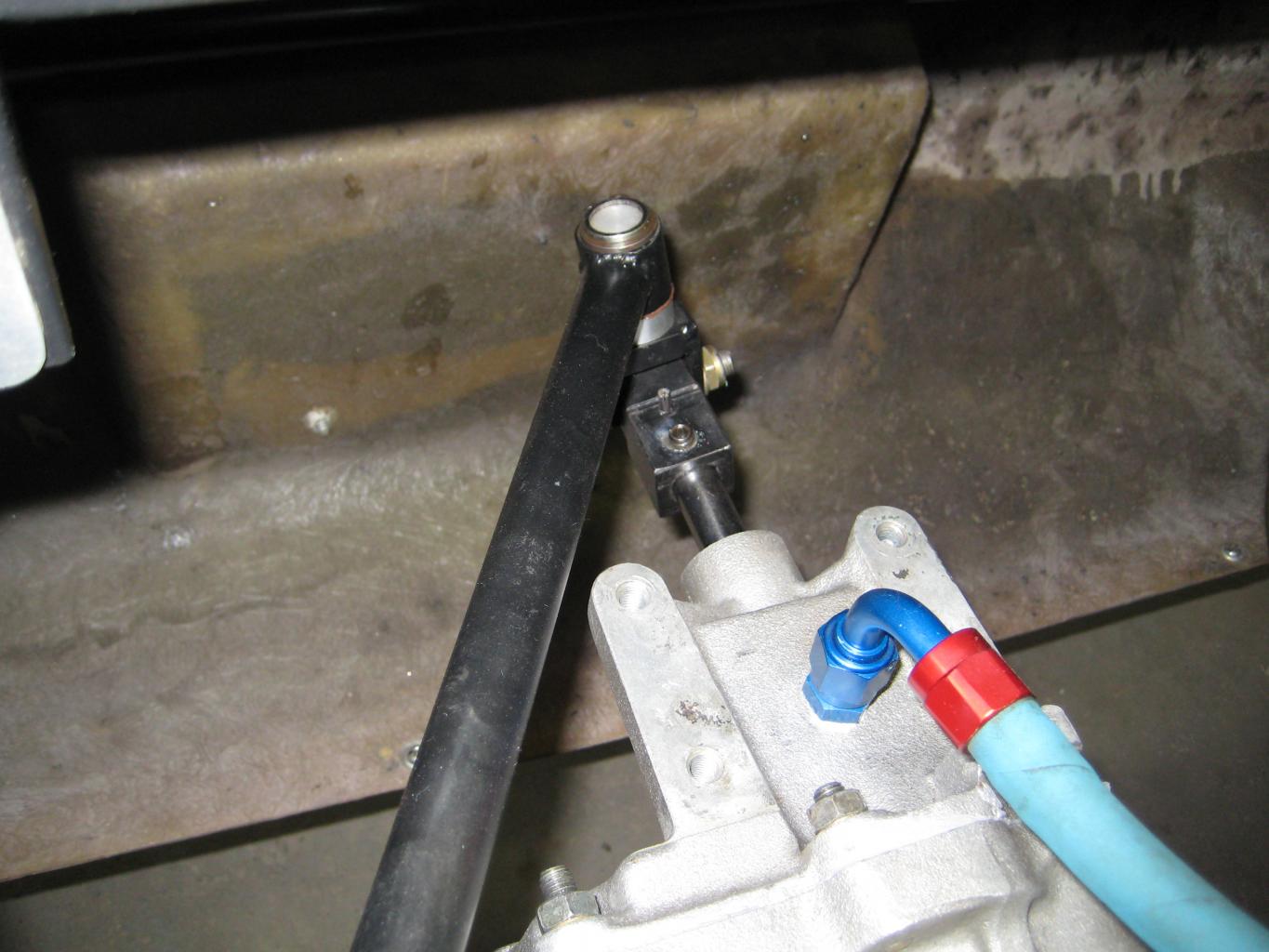

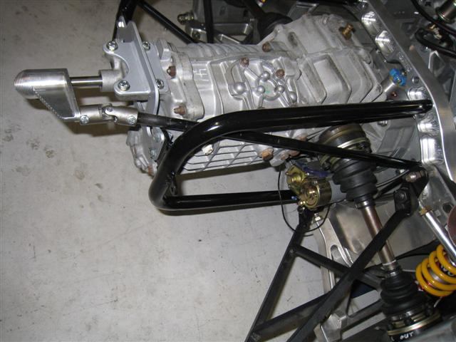

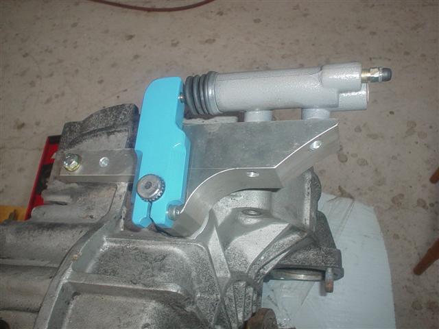

I use a single rod shifter in the "Lola" for the 930 4 speed -- it works really well although could do with a bit more refinement, especially reverse which needs some careful placement and patience --so, we only use it to back on the trailer:laugh:

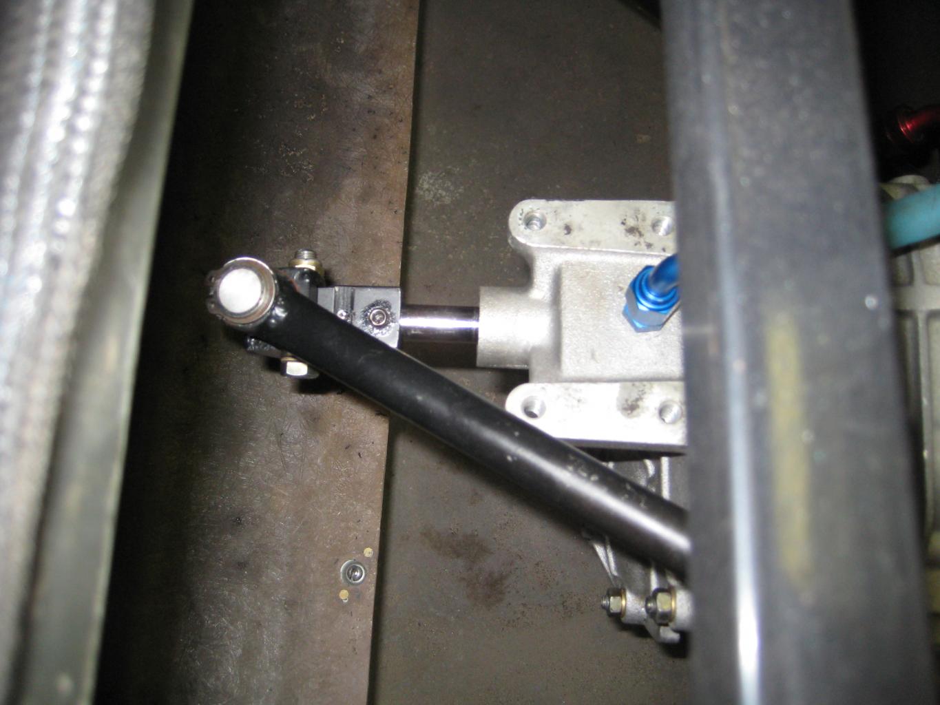

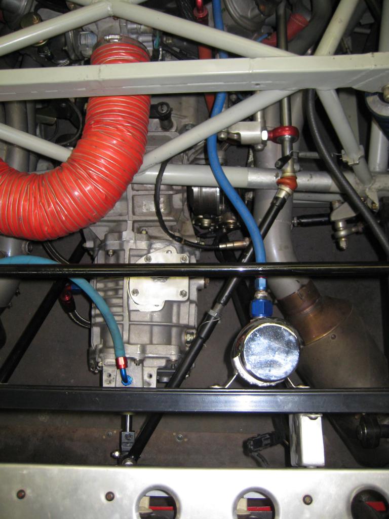

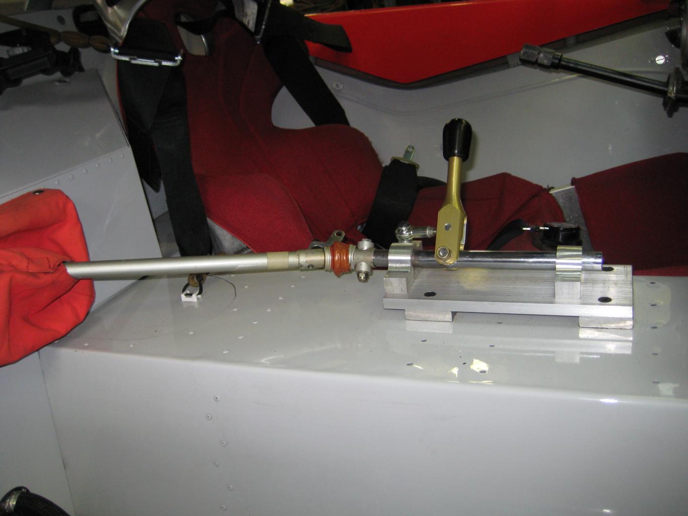

Here's what I use for my 930 box on an LS6 in my tube chassis race car. I basically copied the linkage of a Porsche 962 in how it mates up at the trans with a simple joint/pivot which gives me a better shift feel than an offset "hockey stick" style such as how Flatchat showed. Disregard how my shift lever is pivoted,as the internal shift linkage/rods are very different in my trans than standard( will post info on this project/experiment after testing next week!).
Be mindful of the stock Porsche shift rod travel fore and aft as the distance from neutral to engaged can be quite long for some "racing" shifters designed for Hewlands and their 1/4in travel each way. My 930 was almost 7/8in from N to engaged forward and back due to those big honkin' Porsche style syncros. My Albins dog ring gears by comparison are 1/4in!!
