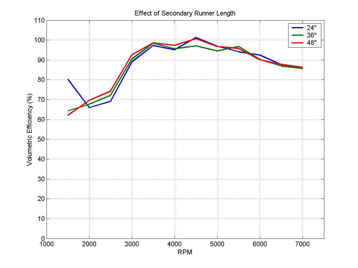

Now we look at secondary runner lenght effects.
The effect here is much less than that of primary runner length. The results are also somewhat mixed. In general, longer secondaries seem tgo be better at low RPM, while shorter may be better at high.

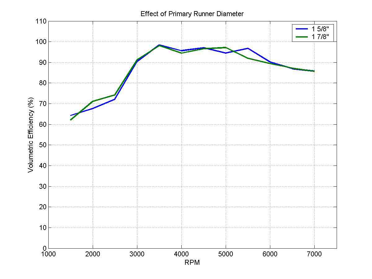

Next up is primary runner diameter.
Again, not much here.

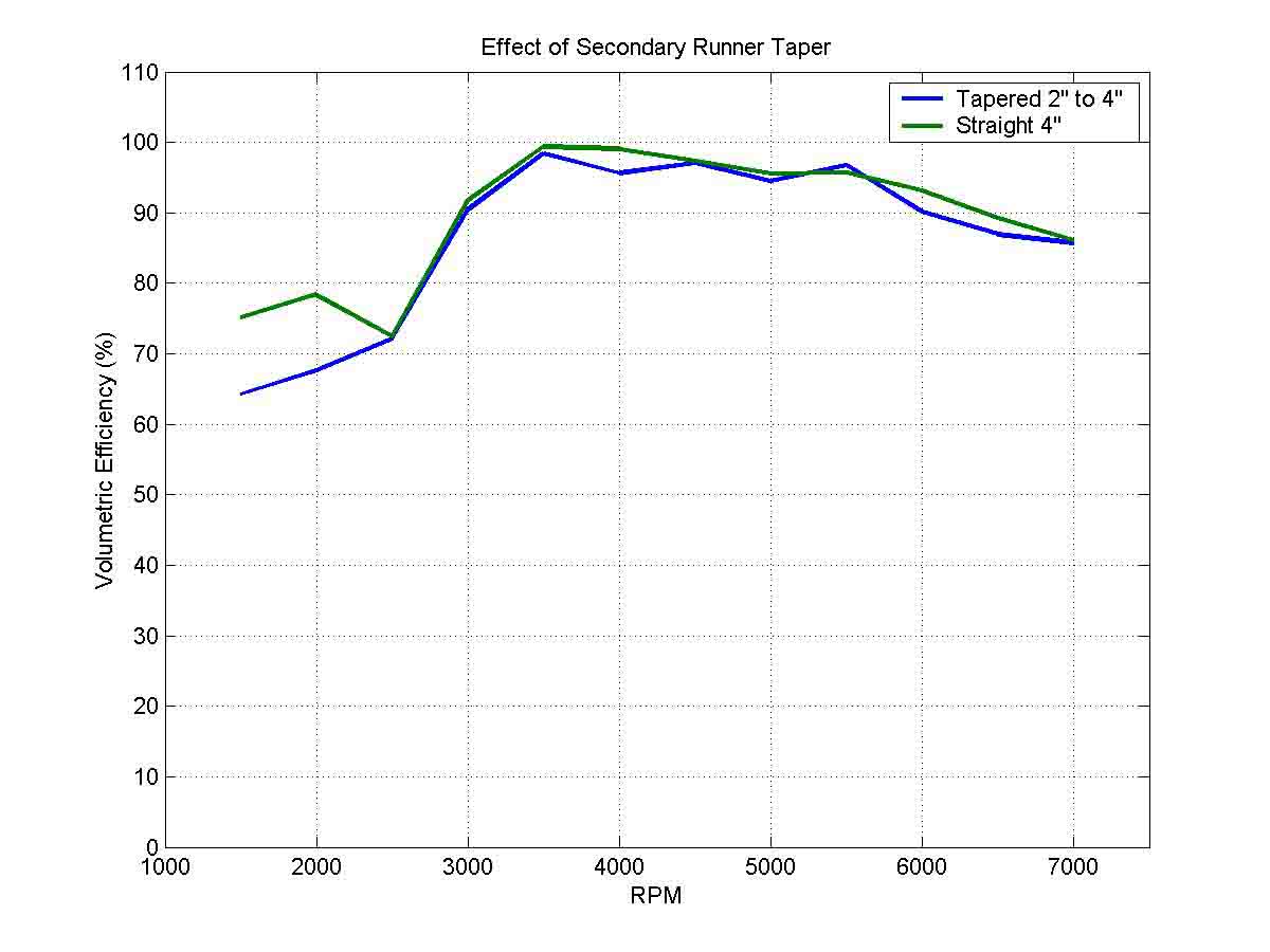

It is often said that merge collectors and tapered secondaries make more power. Here we compare the tapered secondary that starts at 2" and increases to 4", with a straight secondary that is 4" allong the entire length.
Here the straight duct wins. It should be noted that the code does not take into account the difference in flow losses between the tapered and striaght ducts.

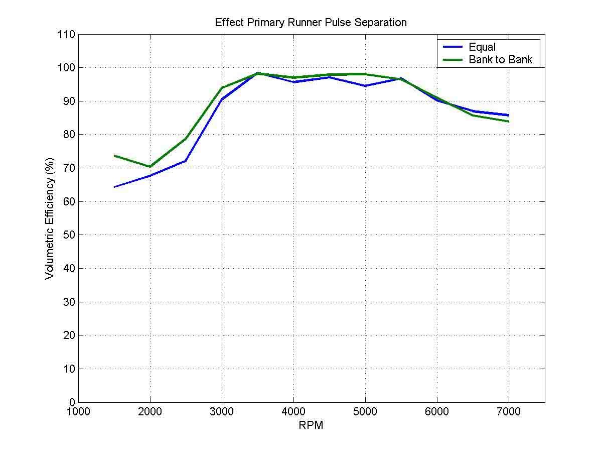

Finally the mother of all. The effect of pulse separation. On this plot is the GT style 180 deg. exhaust compared to the bank-to-bank system like that used on the lowly Mustang.
The equal pulse system performs slightly better at high RPM, while the bank to bank system is better at low.
It should be noted that these are cylinder averaged vol eff curves, and that the cylinder to cylinder balance on the equal pulse system is far superior to that of the bank to bank.
The equal pulse system also has that great tone.

I was surprised by the graph of Primary Tube size. I would have expected the large pipes to have moved the torque peak up noticeably on that small an engine. Also the VE was very good – 95% up to 5,500 RPMs with those Heads (Is the exhaust flow really that high compared to the intake flow? That seems like a very high number for the exhaust.)

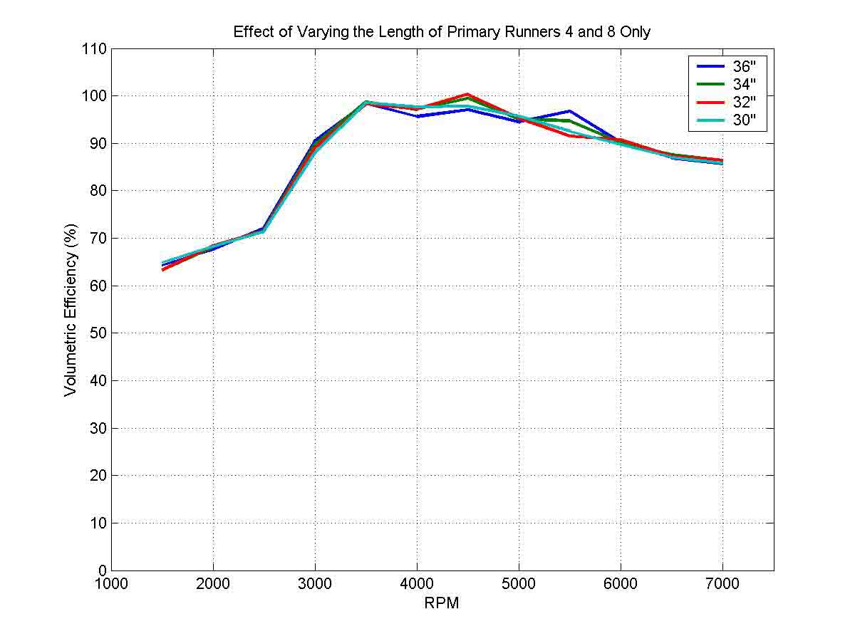

I told you what differing the primary runner lengths would do in general, but lets look at a specific case.
According to Dave, the two rear cylinders are the hardest to get equal length. I would assume that they would end up short since they are closest to the collectors.
So using our trusty 5.0L with our original GT exhaust, I shortened these two primaries in 2" increments from 36" to 30".
As you can see there is little difference. As I predicted, making the lengths uneven tends to smooth out the VE, and therefore torque curve.
On the exhaust side, the cylinders don't really work together. Each one is singing its own song. It is not important that they all be singing exactly together. Of course it will sound better if they are. Also, the cylinder to cylinder variation will be less in an equal-length design. For unequal length, the VE curve is different for each cylinder. As a consequense, if you are injecting the same amount of fuel for each cylinder (as in most port injection systems) some cylinders will be rich, while others will be lean. In the model here, we are assuming that each cylinder gets a stoich mixture.

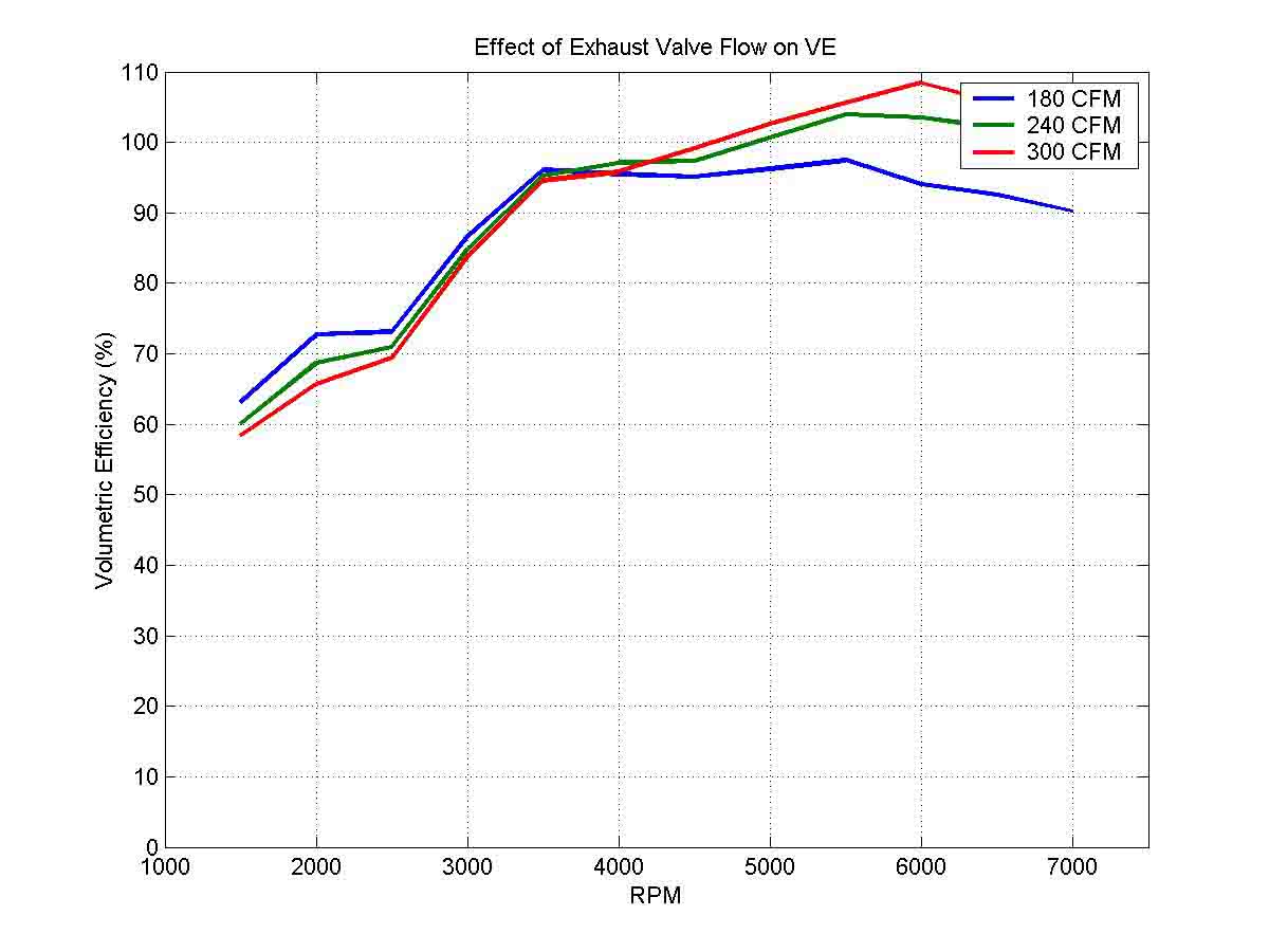

The exhaust flow of these heads was a little out there. I ported the heads a few years ago. I simply cleaned up the bowl on the intake side and had a good valve job done. The peak flow number hardly changed for the intake, but at mid lift it actually well outperformed the TFS TW.
I ported the crap out of the exhaust, hence the high numbers. They were flowed by Fox Lake before I had access to a flow bench (I now have access to one of the best). The superflow bench that is the gold standard in the hotrod industry doesn't do so well measuring flow out of the cylinder. The measured flow of 230 CFM actually is theoretically impossible for a 1.54" exhaust valve, so the numbers are deffinitely botched.
So why did I use the exhaust flow numbers then? Because at that range, the exhaust flow has little to do with VE. You can never have too much exhaust flow, but you can have too little.

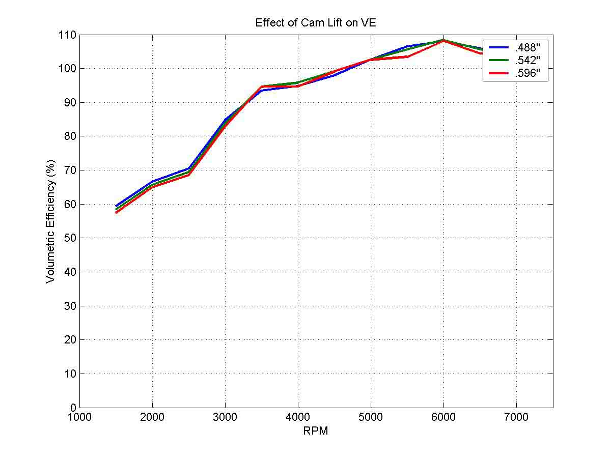

In this plot we look at the effect of varying the exhaust valve flow. Beginning with our initial maximum flow of 230CFM, I decreased the flow ability of the exhaust valve in 25% increments until it really began to hurt VE.
VE doesn't really start to take a hit untill the exhaust is flowing about like the stock E7TE head (115 CFM). There is a small penalty at low RPM for using the high flowing head. This is primarily because it is easier for the exhaust gases to back flow during valve overlap. This could be remidied by using a cam that had less overlap, but then power up top would suffer.
Maybe if you all like this, I can set aside some time to do an induction expose'.
