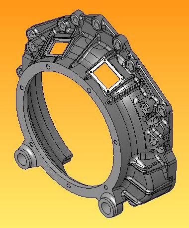

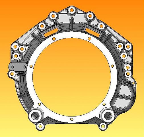

Hi guys
the ZFQ design team have developed a new proposed bellhousing that will be machined for the small block Ford but can alternatively be machined for the LS Chevy engines.
It is designed for 157 tooth Ford flywheel with 10.5" clutch and Ford Starter motor. For fitment to the Chevy the flywheel would need to be machined to take the Ford ring gear.
The ports at the top of the bellhousing allows the transaxle to be fitted or removed separately from the bellhousing making installation much easier specially on monocoque cars with limited space.…
We expect to have the first batch read by march. you will also notice that it has the authentic lower GT40 mountings essential when fitting to a GT40.
regards
Chris.

Chris,
You need to keep those design team members happy during the Holiday Season so the energy and drive to complete the "package" hits the shelf for end users by your target date. The attached images look great, and I can see many units going out to folks that want to update their 40. Will your housing require any special starter?
Great job, and wish you a Merry Christmas and Happy New Year!!!

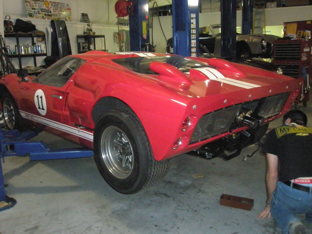

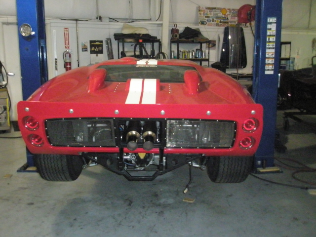

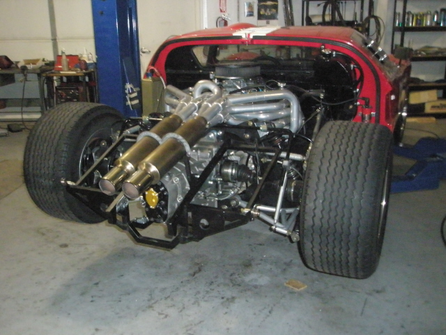

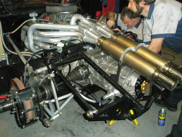

we are working very hard testing and developing the ZFQ, here are a few shots of the ZFQ in an SPF car with 500+Bhp in the USA two weeks ago. After testing the trans was returned to Quaife for further inspection.
Have a happy Christmas
regards
Chris

The Spf/Olthoff cable change worked well.
regards
Chris

Hi Guys
the time frame on the bellhousing is the end of March and the price is £450. Our testing of the ZFQ has proven to us that the lower mountings designed in to this bellhousing and on the original GT40 bellhousing's (small flywheel) are essential to anchor the whole drive train package.
Regards
Chris.
