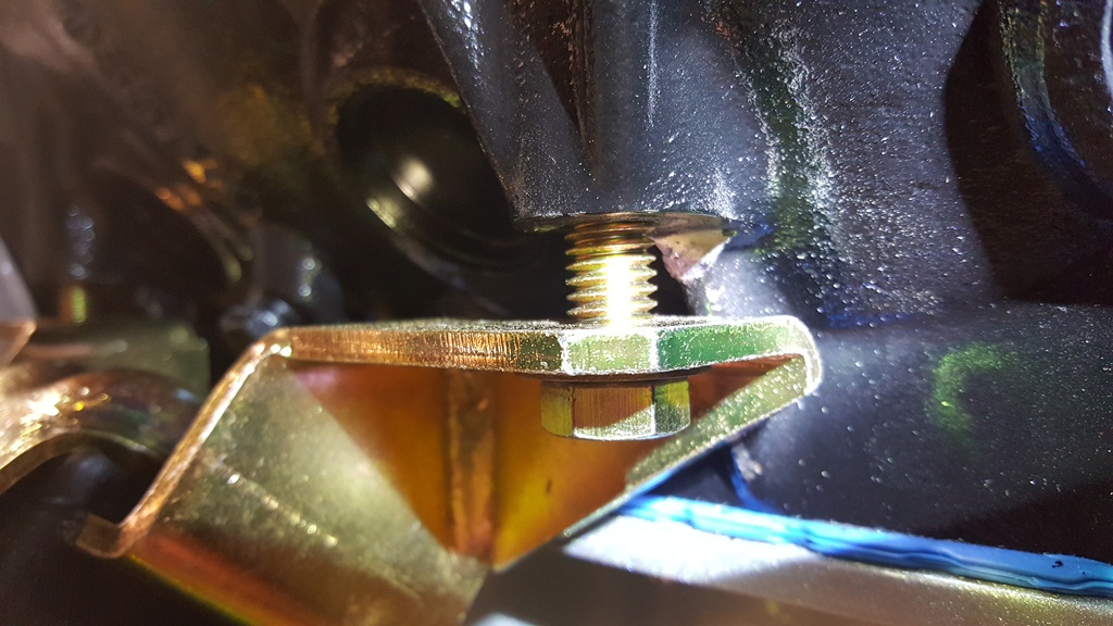

We completed mating of the Quaife gearbox to the Roush last evening. Proceeded to the motor mounts, but didn't get far.
I have the Prothane 6-503-BL mounts recommended for this install. However, the mounts can't be tightened to the block on the Roush 427SR. There is webbing on the Roush block that prevents this (see photo). I don't believe the webbing can be clearanced enough, so I think it's time for a different motor mount - one with a narrower flange.
Thoughts? Recommendations for this install?

Don't alter the webbing on the block, just use a 3.5" cutoff wheel on a high speed air tool to cut a relief into the mount.
Update: One call to Olthoff and the problem is solved. As mentioned above, their motor mount kit uses a BB Chev insert, available from AutoZone. Along with the brackets supplied on the chassis and in the parts box, we should have the drivetrain installed very soon. Thanks again.
