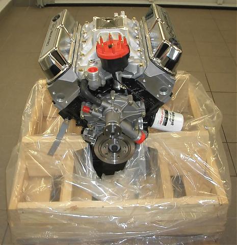

Hi,
after long waiting Santa Claus came and brought me through Sean Hyland Motorsport the largest christmas gift, which I ever got.
So I can start with the next steps for the building.
I need pulleys and brackets for the Ford crate engine 392 (351). Ford no. is M-6007-C392FT.
Ford Racing Performance Parts [M-6007-C392FT*]
I will change the water pump and will use the Meziere electric water pump WP311.
Meziere Enterprises
The drive is on the left. The A/C must bee on the driver side, the alternator on the other side.
Knows someone where I can buy a set?
