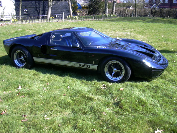

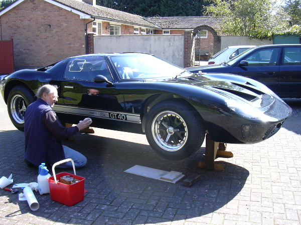

Cheers Bill, nice sunny day today in the UK so took a spin round to Brian's to get some cill stripes made/fitted. Thanks Brian top job, I can't believe how much they change the look of the car. Hopefully get some photo's tomorrow as I've spent most of the day cleaning the car outside and in.

Done 1000 miles in it (Her ???? need to think of a name - The batmobile ????)
Anyway had a great drive yesterday going up to Brians - about an hour half motorway and half A roads.I find that the car seems happiest when you are cruising over at least 50 mph and can throw it into bends that normally you would slow down for. I have the shocks set fairly soft so it doeesn't rattle your fillings out but also corners pretty well - given the low centre of gravity this isn't hard to achieve and I seem to have the best of both worlds. I'd imagine on the track a much stiffer setting is preferable - we'll see.
I have never been that happy with the brakes and just put it down to them being off a granada and not really upto the job, untill an anoying squeek made me investigate things a bit. When I first assembled the brakes I hadn't got the correct size pins for the calipers so just got some that fitted and also didn't have and anti-squeel plates behind the pads. Having got a new set of pads given to me I checked the pins and the standard ones are a little thinner in diameter than what I had fitted. Needless to say the pads haven't been sliding along them very well and made braking effort quite hard. Having swapped out the old and fitted the proper ones my brakes are now great - I'll probably upgrade anyway in a few months time (as I'm sure repeated track use will cook them) but having wound the bias completely to the rear calipers it stops really well and I now have a bit of confidence in them.
I've re-alligned the wheels as I had a little bump steer on the front which is mostly gone now, having lowered the rack slightly. Cleaned the car last night for photo's today - here's one taken in Desmonds paddock (Thanks Desmond)........
