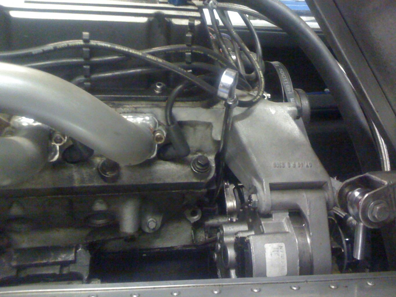

Time to get the car ready for the next season - starting with a new cast ally alternator bracket.
