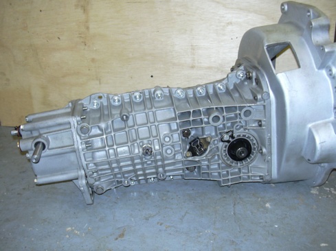

UN1-013 with SBF bellhousing.

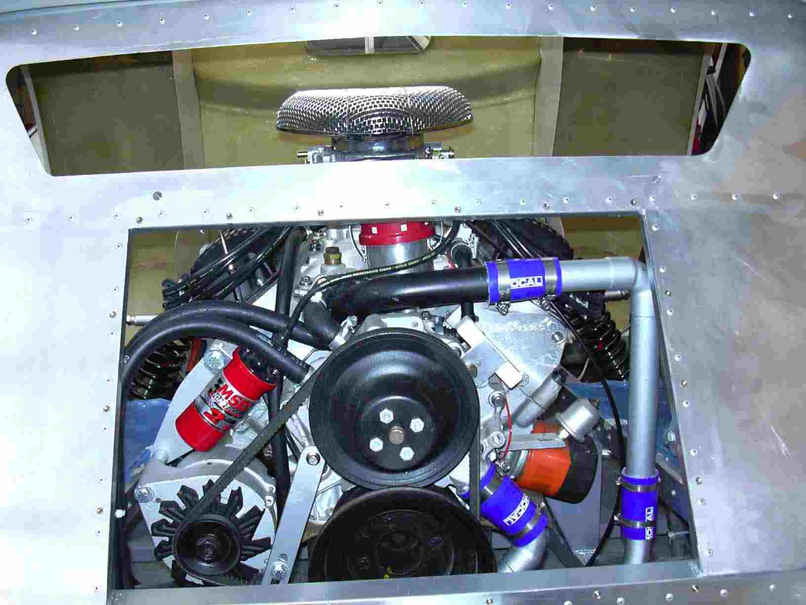

Paul-
You are making spectacular progress. Q: What are you going to use to cover the dash? And will you drill the gauge/switch holes before or after it's covered?
Bill D
Hi Bill,
To start with I'm just going to spray it black as the switches have to be bunched up behind the steering wheel in order to pass UK SVA. Once it's through I'll have it covered with leather and move the switches into the usual locations. I will have to cut all of the holes before it's covered as you make the holes slightly oversize to allow the leather to lip over into the inside.

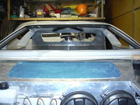

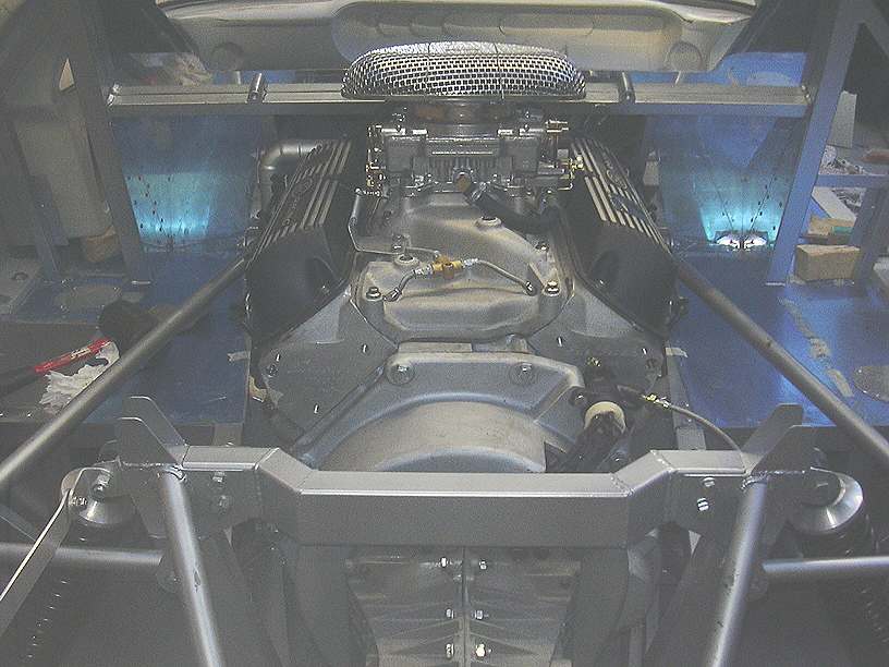

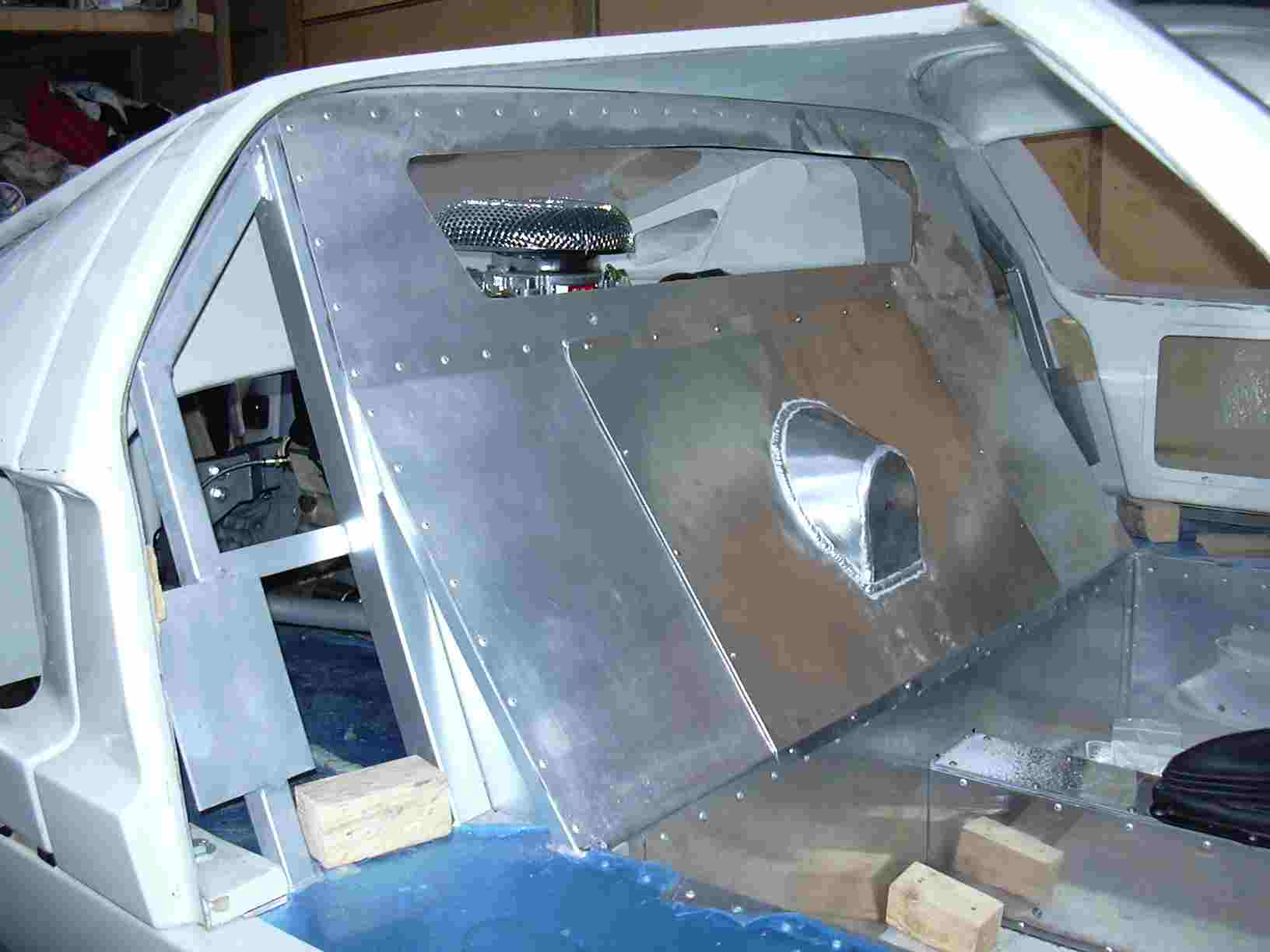

It's been a while since I've posted mainly because there haven't been any pictures of stuff I have done. I put oil in the gearbox, the clutch and brakes are all bled and work. The accelerator is operational and I've been working on a gearchange setup. I have just got the car back from having a custom roll cage fitted here are a few pics.
Paul-

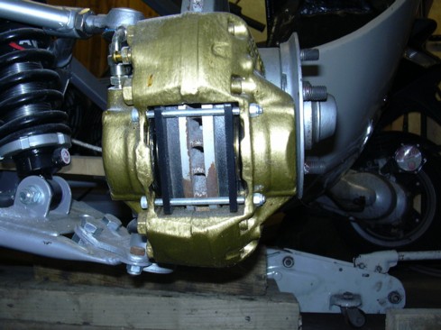

The car is really coming along beautifully. I would love to see some pictures of the front brakes.
Bill D
Thanks Bill / Pete,
Heres the front brake pic. Granada MK2 UK standard - probably the first upgrade after SVA.
