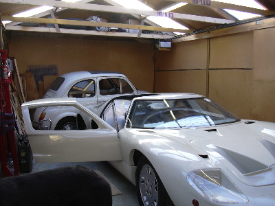

Rebuilt the garage - a bit more space ........

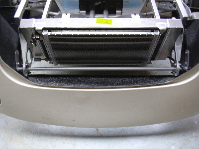

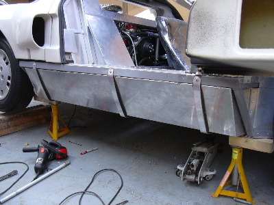

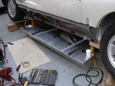

Been fitting/modifying the wiring loom so not many pics to post - most of its done now so onto the fuel system. Fuel pumps / filters / cutoff valves all fitted and onto the tanks.
Fitted - there is foam between the tank and the chassis/brackets but this pic makes it look like there isn't any.

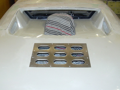

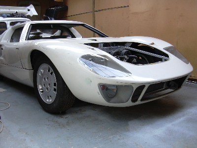

Change of plan on the lights - moved the indicator from the outside (gulf position) to inside the lower recess and made up some tinted lenses.
Now in the dash fitting / wiring mode.

How do you do for minimum height from ground (SVA) for that indicator?
Or are you going to fit another for the SVA?
The lower recess will be blocked off for SVA (Tape over the light cover) and another indicator mounted in the headlight recess temporarily. I don't think there is any way of mounting an indicator in the lower recess that will pass UK SVA. I'm about to mount the side repeater above the body catches that I have just mounted : -

Paul, it looks nice! I have just one suggestion though on your tank mounting - you might want to take the time to weld some "ears" about 1.5" wide and 6" long on the outside of the tank parallel to the front and rear down tubes that are in front of and at the rear of the tank. These ears would overlap on the downtubes. Then, you could drill holes in the ears, holes in the down tubes and secure the tank firmly using bolts and do away with the three folded straps that hold it in place now. It would be a little more secure and eliminate any virbration that might occur with the compressed strap method.
It might already have something like that though.
R
Ron, I considered this when i was designing the tanks but my welder man thought that any sort of "ears" would create a stress point on the tank. The straps I have used have foam (compressed) all the way around the tank so it is held firmly in place - they are very tight on the tank. It's a bit hard to see from the pic I posted.

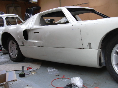

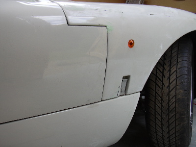

Side repeaters ,body locators and catches fitted. The side repeator is from a peugeot 505.

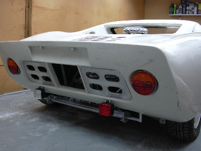

Fitted the rear vents and fog / reverse light for SVA. I will move them once I am through it.
