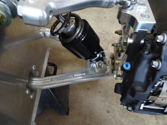

My car arrived some time ago with the front lift and QA1 shock oriented as shown...the lift kit on the bottom, and the shock installed with the shock strut on top and shock adjusters on the bottom (as I would expect). In this orientation, the lift kit's hydraulic connections are on the bottom of the lift tube.
I have noted that some installers have reversed (simply flipped it 180 degrees with no configuration change) this reversal now places the coil spring next to the lower A arm vice next to the upper A arm (aka in my mind the shock is upside down).
The build manual states the lift kit can be on top or below the spring, but is not specific about the shock itself (can it be installed "upside down"). The lift kit suggest the lift kit can be located either below or on top on the spring.

I have been contemplting the same question regarding the front shocks and lift ram on the SL-C. I was at the PRI show on Saturday and specifically addressed the issue of inverting the front shocks with an engineer at the QA-1 booth. According to the engineer, because of the way the shock is designed, it makes no difference which way you mount the shock. I have my shocks inverted with the ram on top, close to the upper A arm.
Not exactly on the ram. In closer study of the QA1 billet top that secures the spring to the shock, it has a radiused inside edge. If you try to set this on top of the lift puck, it will fit, however the corresponding edge on the lift puck that mates with the top billet radiused lip is square. So a square edge will ride on a radiused lip with all the weight of the car focused on that contact point. Something would have to give.
If additional spacers were used as shims, then the top billet and the puck would join and disperse the force across two circular flat surfaces. Since the additional spacer were not part of the delivery, I assume at this point a configuration with the puck at the top and the shock oriented with the shaft up, is not a part of the design spec?

I agree.... The rod end retaining cup of the shock is radiused. The coil siting should go at the location. This would mean that your original installation is correct. That really blows since it's a true pain in the ass to invert them.

I made a thin washer as a transition to accommodate the curved edge. Just cut them out of sheet 6061 aluminum. It takes a couple of hours to cut them out but it saves a trip to a machine shop. The pictures show two different ways of using the shims. The first picture just shows the shim used as a replaceable wear point. I made the shims when I was originally going to mount the setup as in the picture in post #3. I changed my mind and inverted the shock and no longer needed the shim. I kept it however to use as a replaceable wear point. The second picture would address Dan's concern if he chooses to mount the ram at the top (with bleed port up) and the shock not inverted.
The shim is not required in this picture. I just chose to use it as a replaceable wear point.

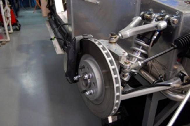

Here is a picture from Grants build. It shows the shim used to take up the mismatch.
