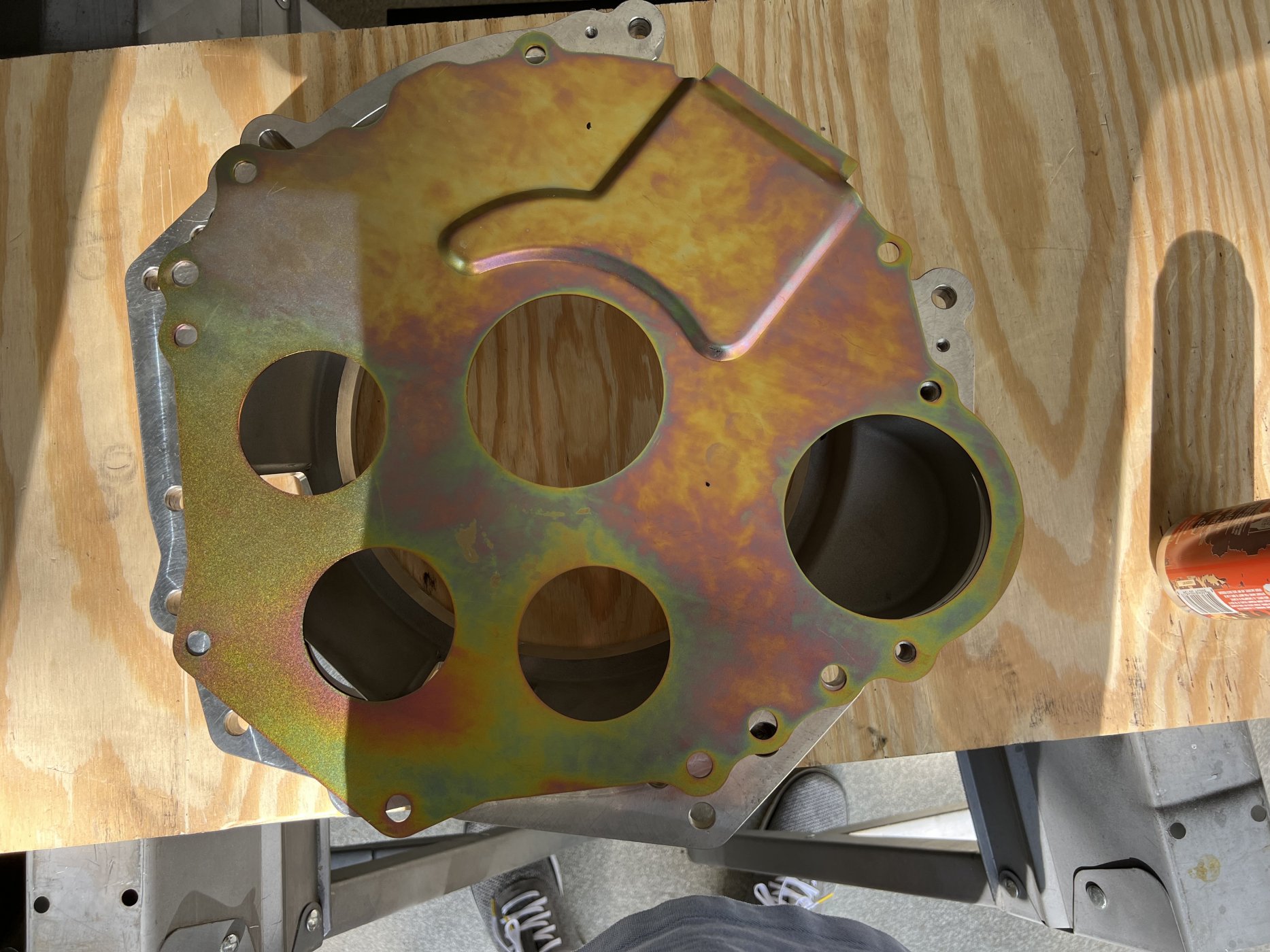

S Klaf Supporter May 10, 2023 #26 Last question I promise. Where did you get the black plate? I have one from Summit but the holes are off 1 inch if I line up the started bolt holes Attachments IMG_4372.jpeg 402 KB · Views: 109
bryanf May 10, 2023 #27 It's a D9ZZ-7007-A block plate. I got it from Mustangs Plus, but they are closed now, owner retired. I did have to modify it to work with the Quaife bell housing.
