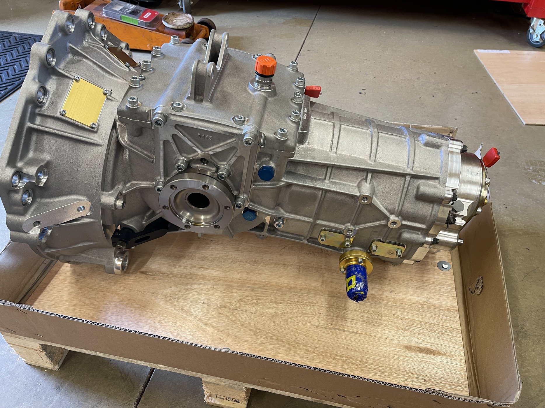

Quiafe QBE62G arrived today!! What are you guys using for a clutch slave cylinder?

My Quiafe QBE arrived today, it's pretty! What are you guys using for a hydraulic clutch slave cylinder and mount?
It's a standard Girling slave cylinder unit (as used on the Hewland MK9) with a 7/8" bore, R/H inlet (note, they come as R/H and LH inlet units). Your bell housing has the bores for the 2 mounting bolts (as seen in your picture) . I used a shim to make sure the cylinder push rod goes in straight and is of proper length. I use a modified adjustable push rod from the Jaguar E-Type (S1). Of course, you'll need to flip the clutch lever from the position shown in your picture ;-).
Thanks for the info. Ordered them both.

My Quiafe QBE arrived today, it's pretty! What are you guys using for a hydraulic clutch slave cylinder and mount?View attachment 144124
Joel. who's clutch and flywheel are you using/?
