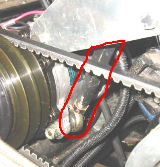

Does anyone know where I can get one of these adjusters from in the UK? The type which is basically a tube threaded with a right hand thread in one end, and a left hand thread in the other. A r/h and a l/h rose joint can then be attached to either end.
Someone must have them ready made in the UK, but what are they called? Who has them? They would be easy enough to make from a bit of hex or square tube, except that l/h taps are so expensive.
Any ideas please?

I bought something similar from Grand Prix Racewear at Silverstone earlier in the year and I am sure Demon Tweeks also stock similar items. I am at work at the moment until 20:00, so cannot help further, but will post later tonight if no-one else chips in.

It looks like your link is in single shear, ie the rod-end is supported on one side only. In high enough load or vibration applications the bolt through the ball will fail or fracture the support. Can't tell if that's the situation, and the rod looks pretty stout, but it's something to keep in mind.
