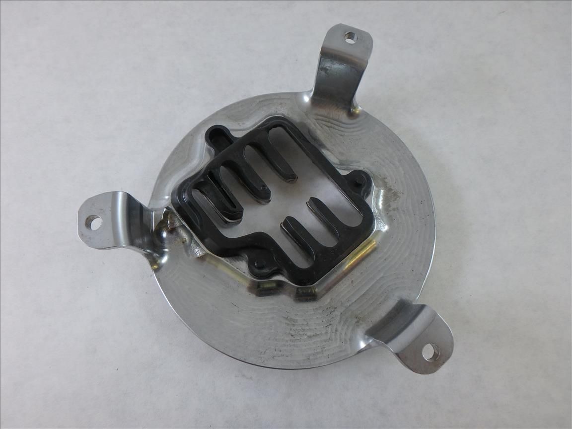

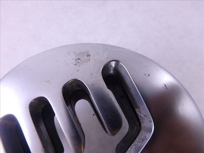

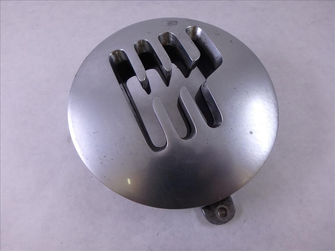

If anyone is still looking for a used Audi R8 shifter gate(I only have the gate, Audi P/N 420713109C3Q7), I ended up with an extra one, that I don't need. I will part with it for what I paid for it (which is about a third the price of a new one), plus shipping. It's condition as shown in the photo's. The car I am working on is my RCR SLC with Graziano trans. and BMW N73 engine.
Pm sent
Any idea on when the gated shifter may be available through Fran?, I just ordered my kit and wanted to get the Audi upgrade.
