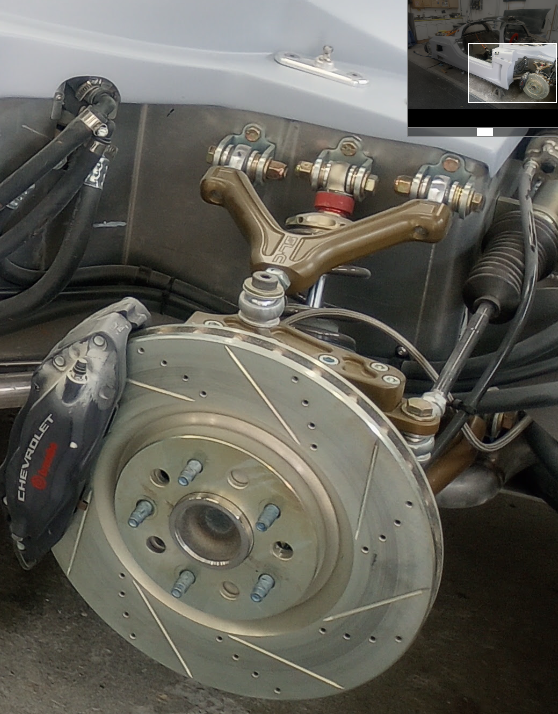

Yeah, I’ve seen them mounted both ways. I think I read somewhere, QA1 shocks can be mounted either up or down. Apparently that is not the case with all adjustable shocks.
Old photo, but this is how they are mounted on this car.
Just spoke with penske and ram lift. This entire system can be mounted either way. so I just need to bleed the system some more and maybe adjust the pressure.
Well it's gonna stay how rcr installed it. Also it all works now. Simple pressure adjustment! Guy at ram lift was great in telling me was it most likely needed.
