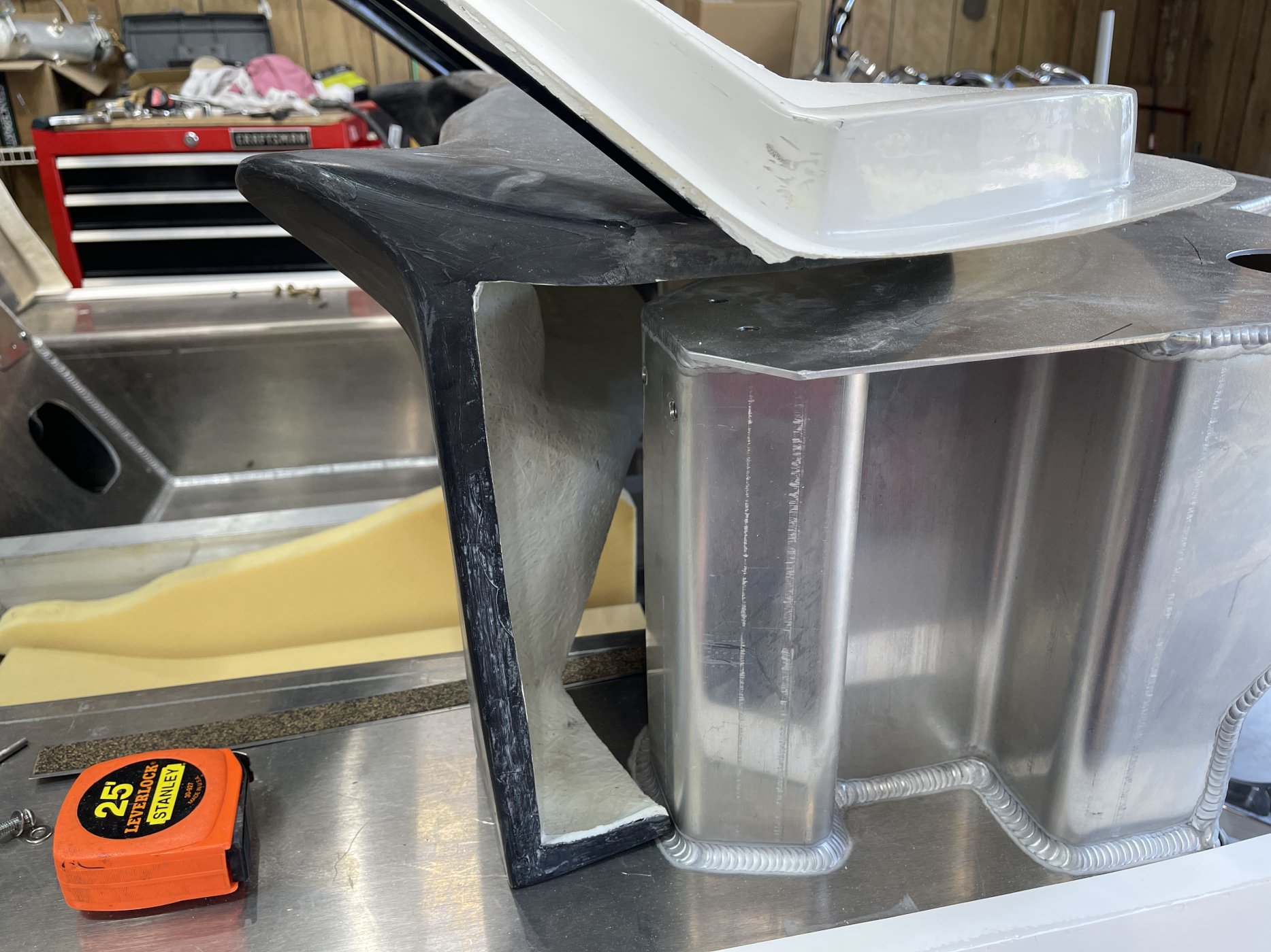

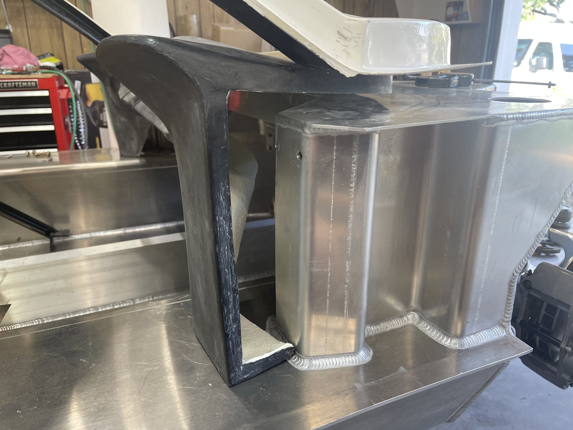

Just curious if anyone has had to trim the bottom of the dash where it contacts the sponsons on the RCR 40 to achieve the level the dash should be at with the doors. I might be right where I need to be without trimming but it's hard to tell from other's photos. Most of the photos I'm able to locate, both of the doors are open. Please let me know if it looks right or if I need to do some cutting...

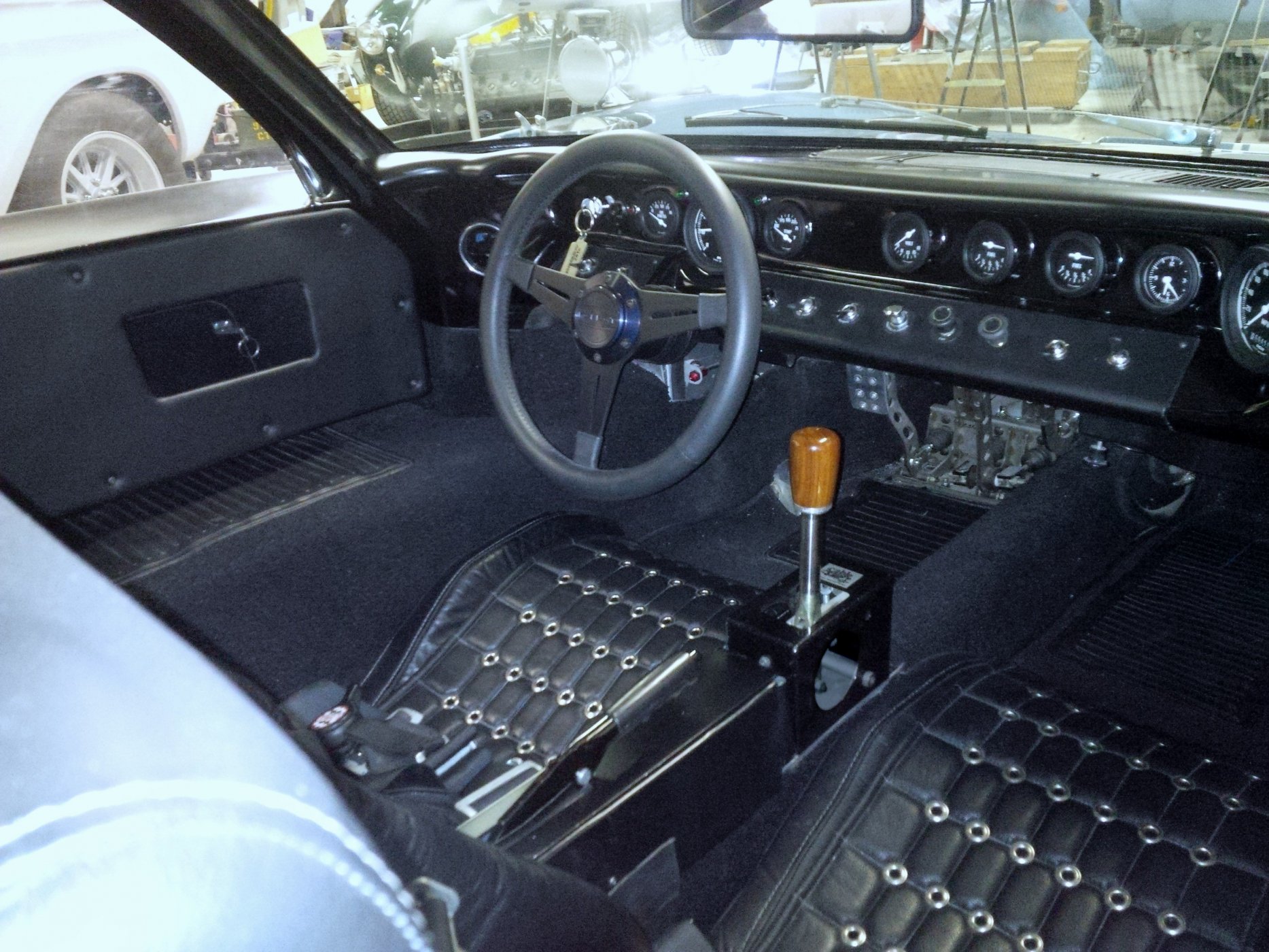

Chris,
Could you snap a couple of photos for me with your doors closed so I can compare? Does the height of my dash in relation to the doors look correct to you?
Chris Kouba
Looks a little high. Check your fitment with the spider in place and see how it sits with the base of the windscreen.
Can't post pics from my phone but will shortly.
Chris, thank you as always for your help. I think I might be a little high but it's definitely close to where it needs to be. I'll wait a while before I do any trimming.
Ian Clark

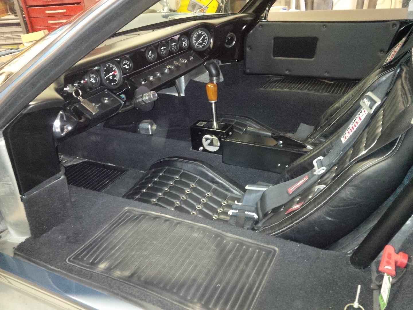

Hi Sean, from the photos looks like the dash is sitting a bit too far forward (close to the windshield). Once you straighten the vertical portion of the dash it will look like the photo from Chis. You can expect some trimming here and there as the build progresses. On the RCR 40 pictured here I cut the bottom portion of the dash off much like the original race version GT40 Mk1. The cut off sections were then carpeted to bring back a road car trim level. Still have a little trimming to achieve the desired effect...

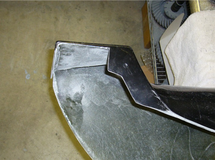

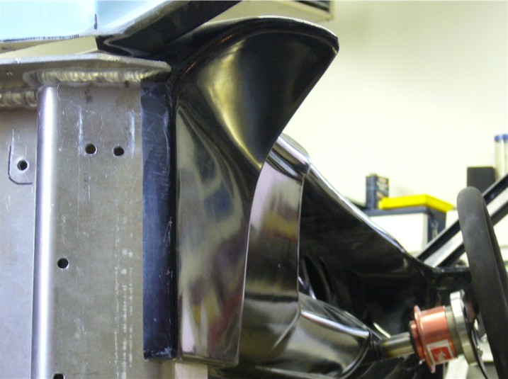

Just getting started with the dash. It looks like it needs a lot of trimming. My question: is it supposed to be elevated above the aluminum deck or flat on the deck.
These are pictures from the online manual. It looks like they cut the bottom of the feet off well short of the sponson. But it also looks like there are still feet on the bottom for a mounting screw. Both can’t be correct. They also mention trimmings something flush, but it is not clear to me what. From the manual: “The mating surface to the dash vertical pillar must be trimmed flush.”
I have no idea what this is a picture of

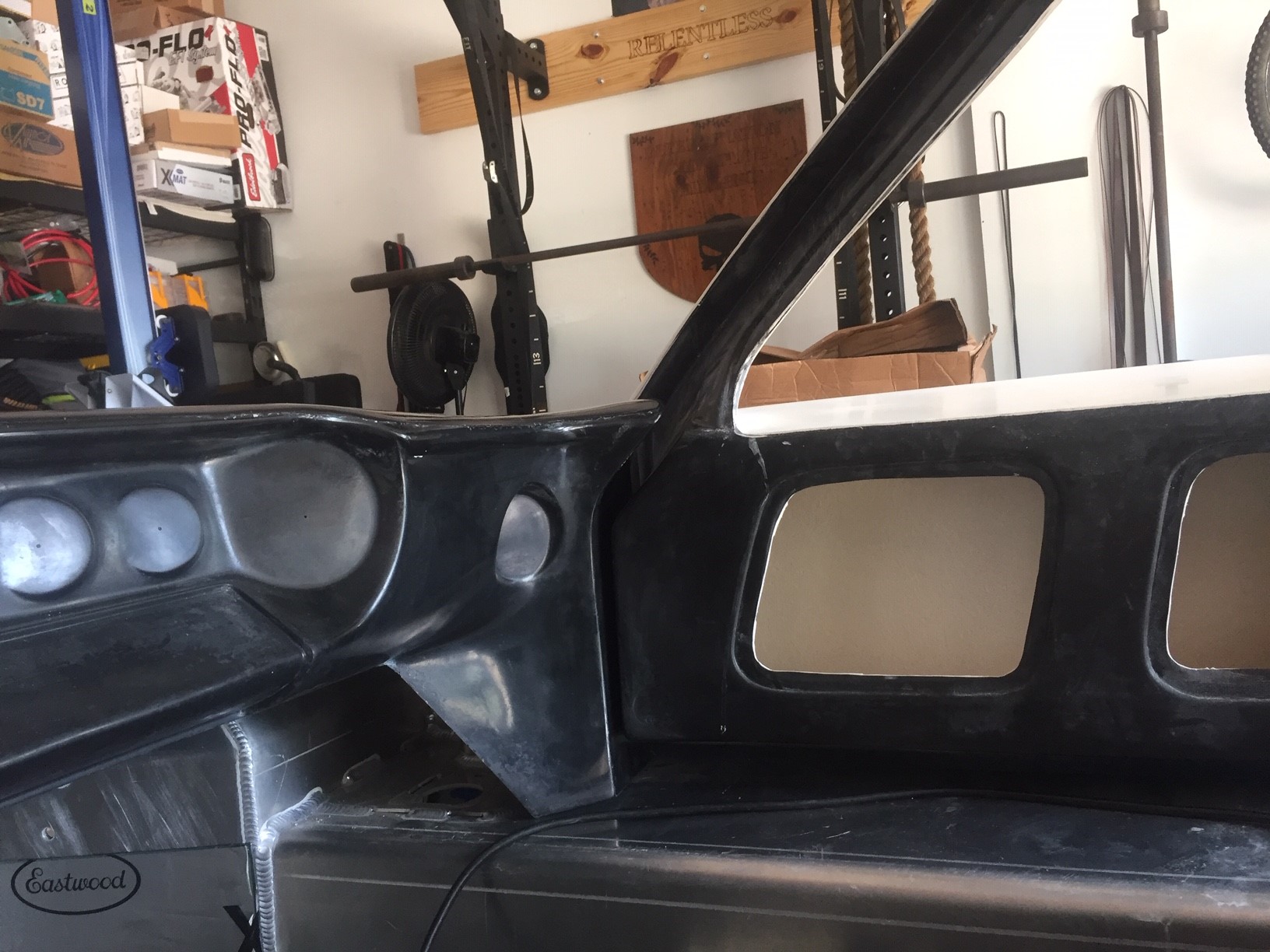

Ian,
Thx much for the detailed body fitting outline.
The reason I want to see how the dash fits before the rest of the body is so I can figure out the front hoop mounting. I am not using the RCR provided hoop.
I don’t want to cut off the bottoms of the dash pillars if I’m not supposed to. The bottoms of those pillars look too nice to be just convenient for making or shipping the dash, but that is the case.
Ignore the spider height in this picture. It is sitting on top of the dash because the dash is in way.

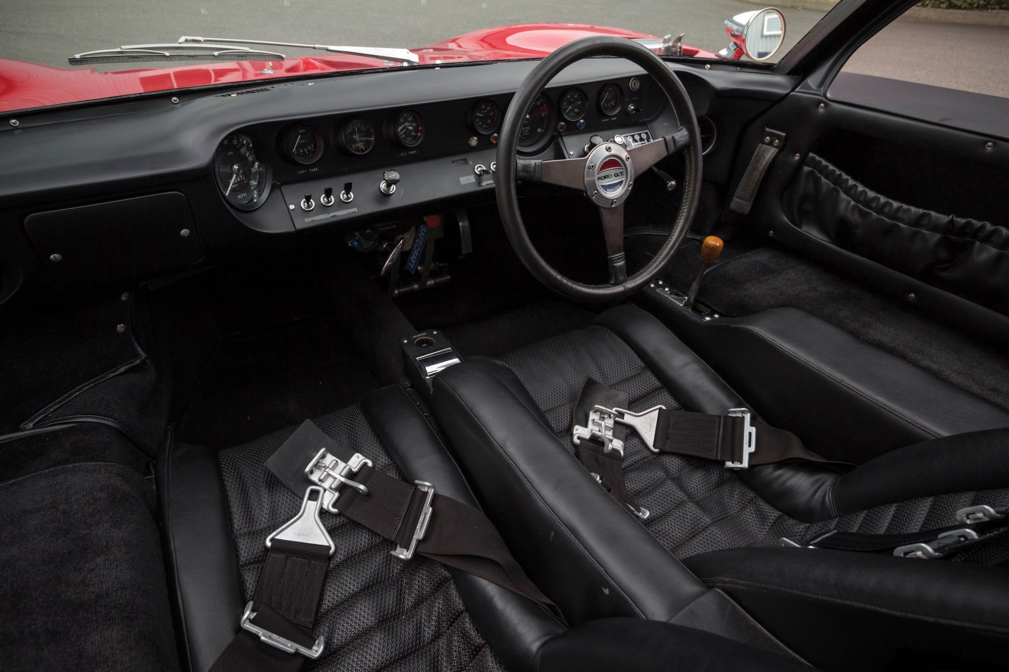

Randy - mine was cut off on the bottom so it would lay down on the cowl.
As I recall, the originals and RHD RCR dash stopped a few inches above the top of the sill / sponson..

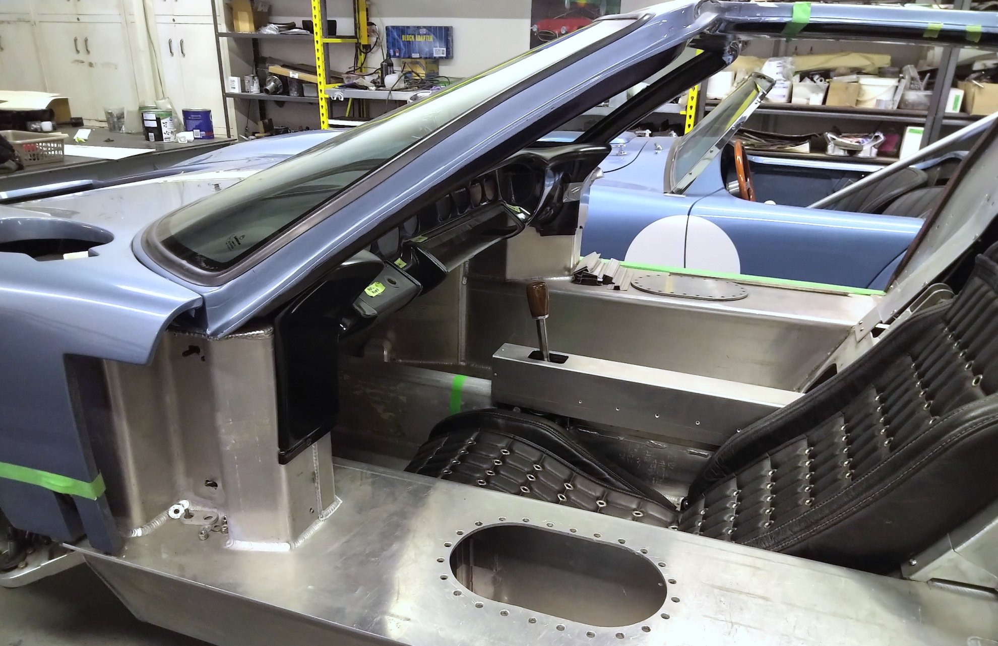

Ian Clark
Hi Randy,
Here's a pic of the RCR GT40 in our shop. It also does not use the front half of the roll hoop. It's not a track car. The lower portion of the dash was trimmed up (like the race cars) so carpeting could be fitted to the exposed part of the cowl bridge.
The dashes in these cars (like many brands of replicas) can be extremely finnicky to fit. Avoid cutting off too much flange in a rush to get the instrument panel in.
Also be prepared to get creative with defroster and eyeball vent ducting... so concentrate on the fitment of the roof spider to the cowl bridge, then work on the dash fit and ducting later.
Following my guideline ensures the body panels and interior all line up making assembly / reassembly is easy and repeatable. You will have this car car assembled and unassembled several times, so plan ahead:)
