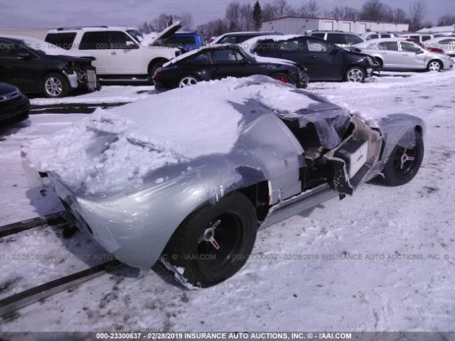

Na...……..they opened the front clip so that the drivers door could be opened. The rear clip had been pushed forward preventing the doors from being opened. They broke the passenger door opening it also. The big thing is if the gearbox is damaged but it looks OK from the pictures.
The real beauty of the RCR tubs is the foot box strength. No way to bend it and not break the windscreen. I can see he hit a pole or tree going backwards. The repair cost is estimated at 150K. No way it would cost that much. Take it apart, order bodywork from RCR and cut off the bent tubing at the rear. Weld new tubing on and put it back together. If I had the time and extra money I would bid on this one and fix it.

Looking at this pic:
I agree with Lee that the tub looks bent. The seam should be straight along the entirety of the sill. It does not look straight in front of the RT rear wheel.
If I had the bandwidth to deal with this, I'd want to check out the pick up points for the radius rods and see what they look like.

Chris the area in front of the rear tire is an overhang that the pontoon bolts too the overhang is at least an inch wide. I have four of Frans chassis and like Howard says they are tough and would be hard to Bend. The front structure as well as the back structure that the clam shells bolt to is aluminum [some early ones may have been square tubing] it bolts too the tub front and back, my bet is that it absorbed the impact without it transferring into the tub. The only way to tell for sure would be a close look, I think this could be a great car for someone but not without that close look. I think most of us on here would agree these things can sometimes be a challenge to work on but this good be a good deal.......m

Mahlon, thanks for the input and help. From the best I can tell from the pic it does look like square tubing myself which could mean an easier fix on the structure. I’m hoping to talk with someone at the yard to get a better pic of the area and see if they can tell me more about it and the details on buying from out of state. Still would be great to have someone knowledgeable on GT-40s that could maybe take a look too.
