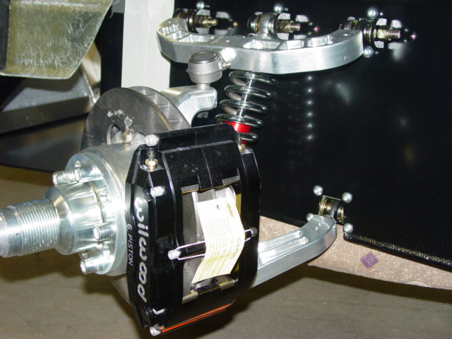

You had better call us to discuss your thoughts....we manufacture everything in house, so anything is possible.
Our standard brake package uses Nascar style 1.25 thick rotors and six piston Caliper up front with four piston in the rear.....
Regards
