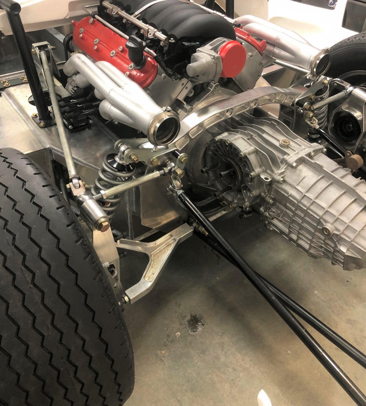

Has anyone come up with a clean method of limiting the lower travel limit of their RCR project. If I lift the car on a jack the CV joints bind and the lower trailing arm hits the chassis. Straps? Bump stops? Other methods?

As I recall, RCR said that the +2 suspension needed to have the lower windows into the chassis cavity opened up for clearance of the lower trailing arms. I did do that on mine, but I have no photos here. I had bought limiting straps for the rear suspension, but sold the car before they were implemented.
Your CV joints should not go into bind before the trailing arms contacted the chassis - I know mine didn’t..

Seeing this image gave me something new to think about that I never really considered. No bundle of snakes, why not, probably a less costly option to do it this way. Admittedly it looses that wow factor.
Tom, I have the same question. My car is not ready to be driven, but wander if this limit in the traveling of the suspension will generated some drive difficulties?
