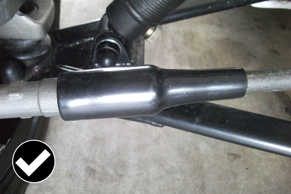

Take a look at this:
5.1 How exterior projections are inspected
DVSA will look for sharp edges that could cause injury to a pedestrian.
Not allowed: tape wrapped round 'non radiused' edges.
If a pedestrian managed go get all the way into contact with this part, its "sharp" edge would be the least of his worries.
Not allowed: tape wrapped round 'non radiused' edges.'non radiused' edges.
Many of those regulations are good as recommendations but as requirements too many are Draconian. How did these regulations come into being? Were they voted on by the public or simply foisted on you by bureaucrats?
Neil,
Don't what to clog up Chris's build thread with noise so guess we will have to agree to disagree. You are right about the pedestrian if they got that far, however the solution suggested by the authorities in my opinion is a good one, as it actually looks a lot neater and is hardly draconian, but each to their own

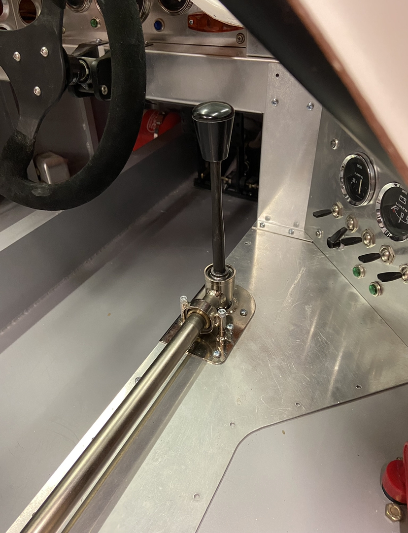

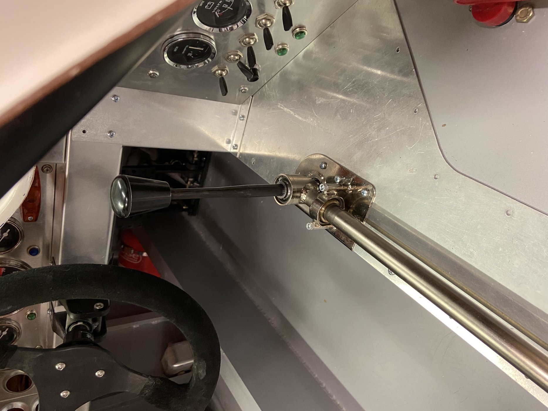

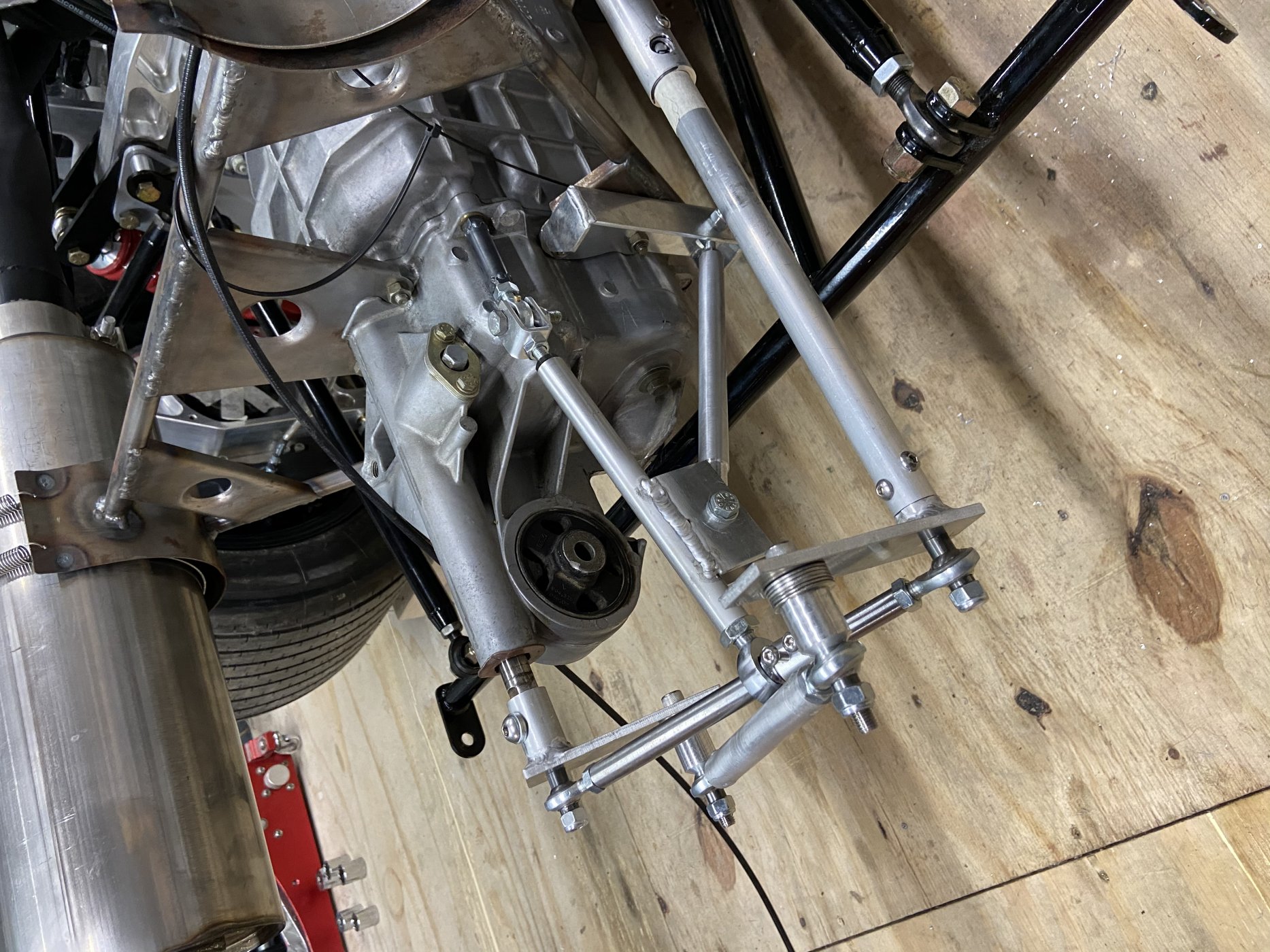

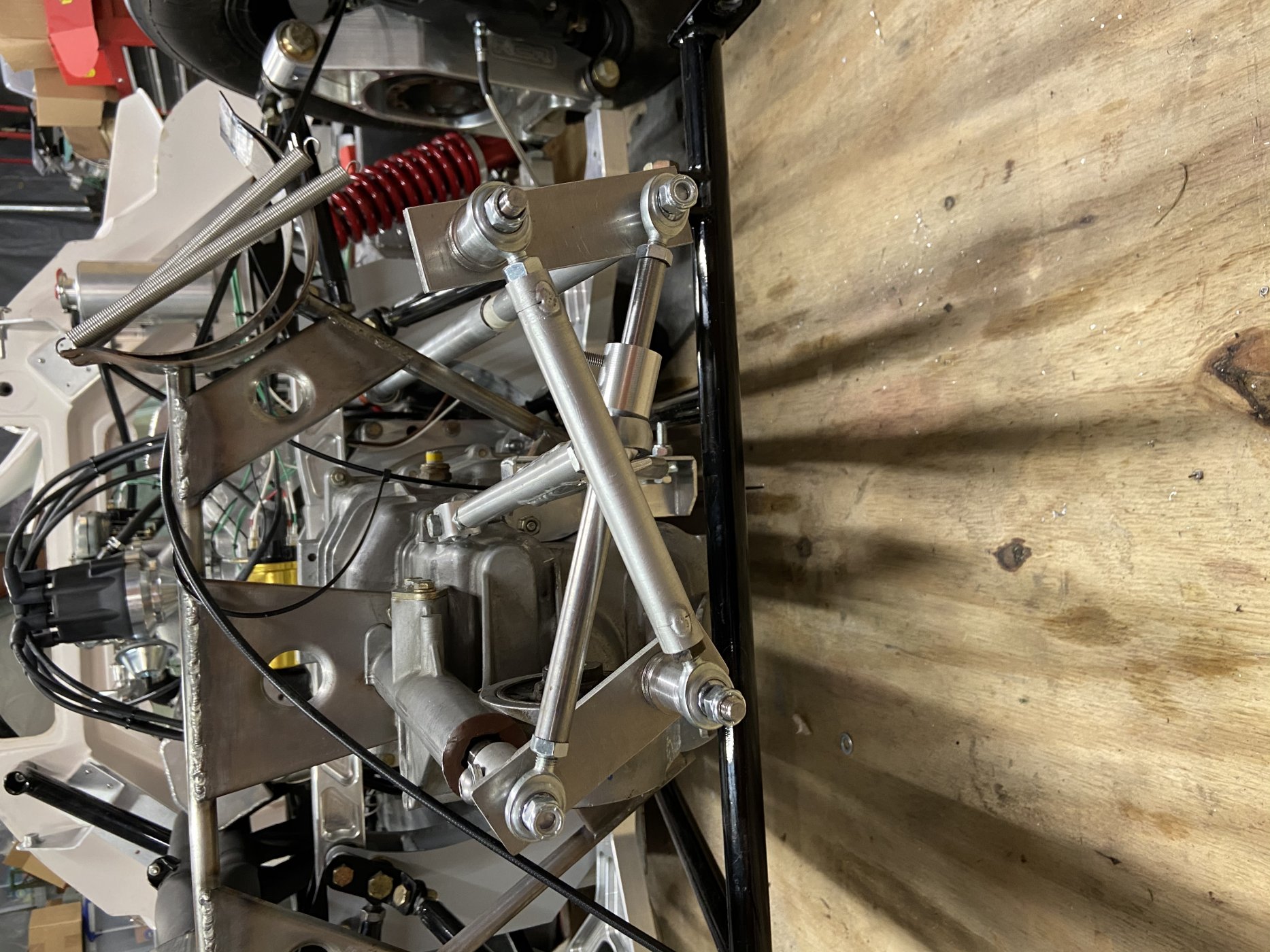

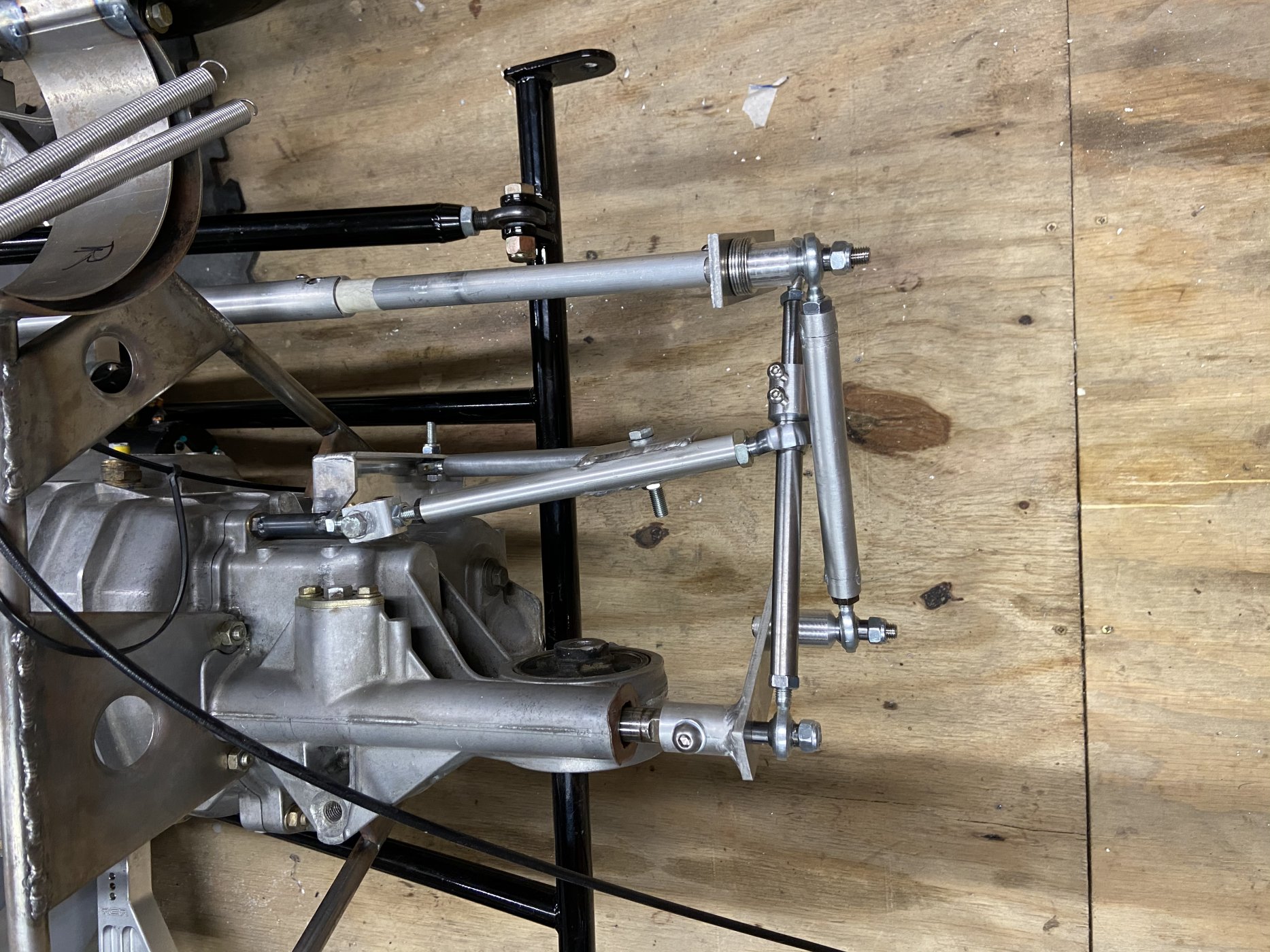

Just finished the prototype gear linkage for the RCR70. I’m using the T70 Right hand gear shift for authenticity so had to devise a linkage that flipped pull to push and left to right to work with the G50 box. Works a treat, even reverse! now going to make it all from steel.

Ian Anderson
Looks good Chris
Bit lots of parts that may add slop in the system.
it looks like you are picking up the movement below the pivot on the gearstick.
Could you pick up the movement above the pivot?
Or use a “rifle bolt” type mechanism to start the movement?
Looks good Chris
Hi Ian, the lever assembly is ‘pure’ lola T70 (original) so I want to keep that ‘as is’. Yes, there are quite a few parts so i may have to ‘refresh’ the spherical bearings from time to time.

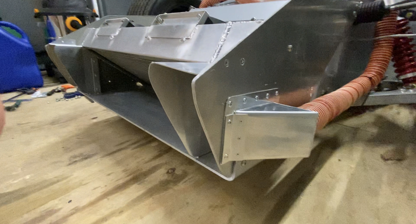

Just finished plumbing in the ventilation pipes (no aircon in this car....) . I think I’m going to go for red with a white stripe!
