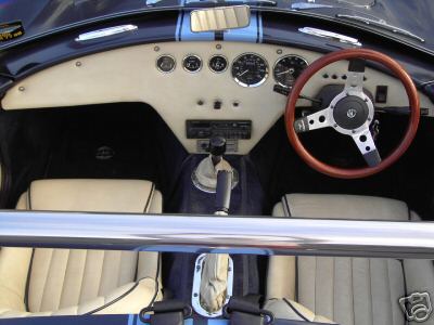

Ok guys, I know this is gt40 forum, but I noted many of u also have (or had) a Cobra.
A friend of mine pointed out Cobra dashboard usually doesnt have any air points for heating the cockipt.
I think Cobras can have some air intakes UNDER the dashboard, but I am not so sure.
Can somebody tell me a little more about?.
Is "cold" maybe a problem in such vehicle (I've already killed this stupid friend..never mind..)
Many people put the duct work in the tops of the foot-boxes, under the dash and some through the sides of the transmission tunnel.
Check on the ffrcobra.com forum for more info, there are a wide variety of ways to make it work..
I've got heat and AC in my Cobra. It is a tough fit to get an AC unit in but it can be done. I have two vents under the dash and two in a center consol.
