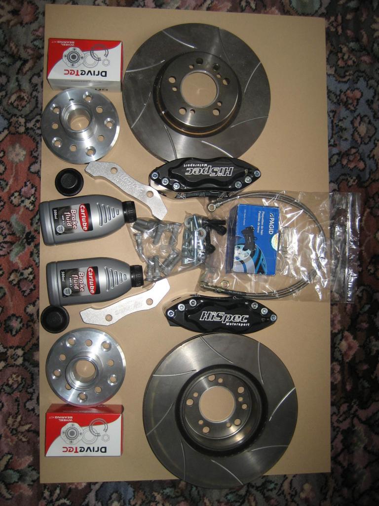

I have the GTD standard fit Granada Mk2 uprights at the front so I got the HiSpec 4 pot brake kit for these uprights.. They also do an alloy front hub (separate from the brake kit) which is much lighter than the standard cast iron lump which helps with the unsprung weight. I have attached a pic of the brake kit for Granada Mk2 upright with the alloy hubs. You get nearly everything you need in the kit as you can see. You will need to order from them the bolts to attach the disks to the hubs as they don't come with the kit.(why I don't know)

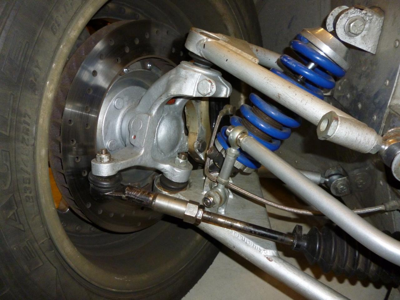

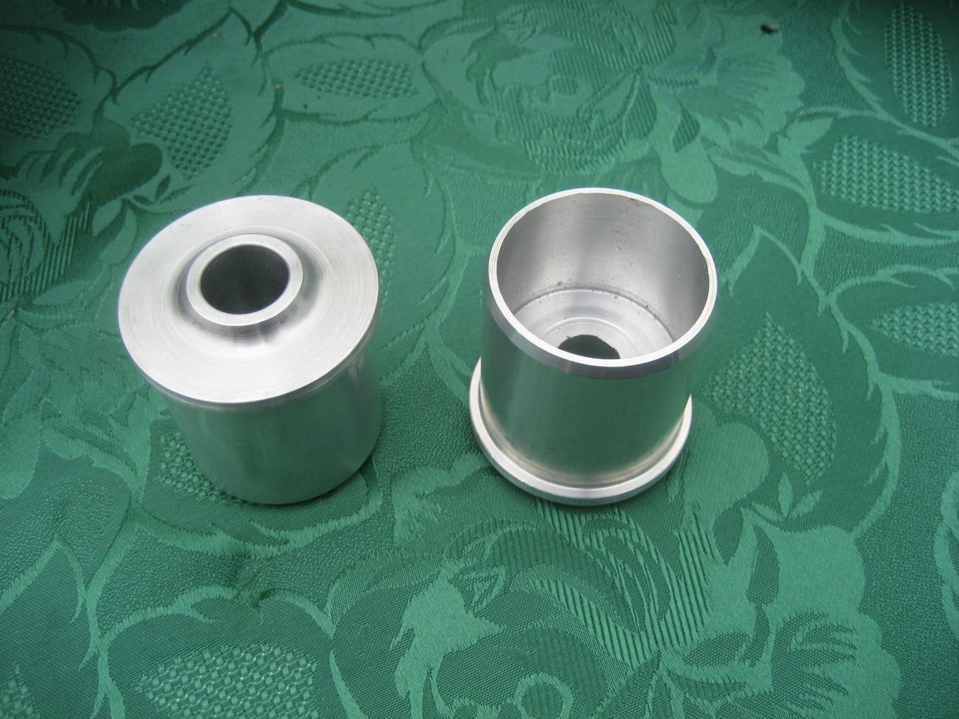

If you don't like the Granada Mk2 upright you can use the Granada Mk3 upright which has a better king pin inclination. However you will need the "mushrooms' to fit in the place where the strut usually goes and get some wishbones made up. Mick Sollis does all these bits. Pics of "mushrooms" and the final set up attached.
