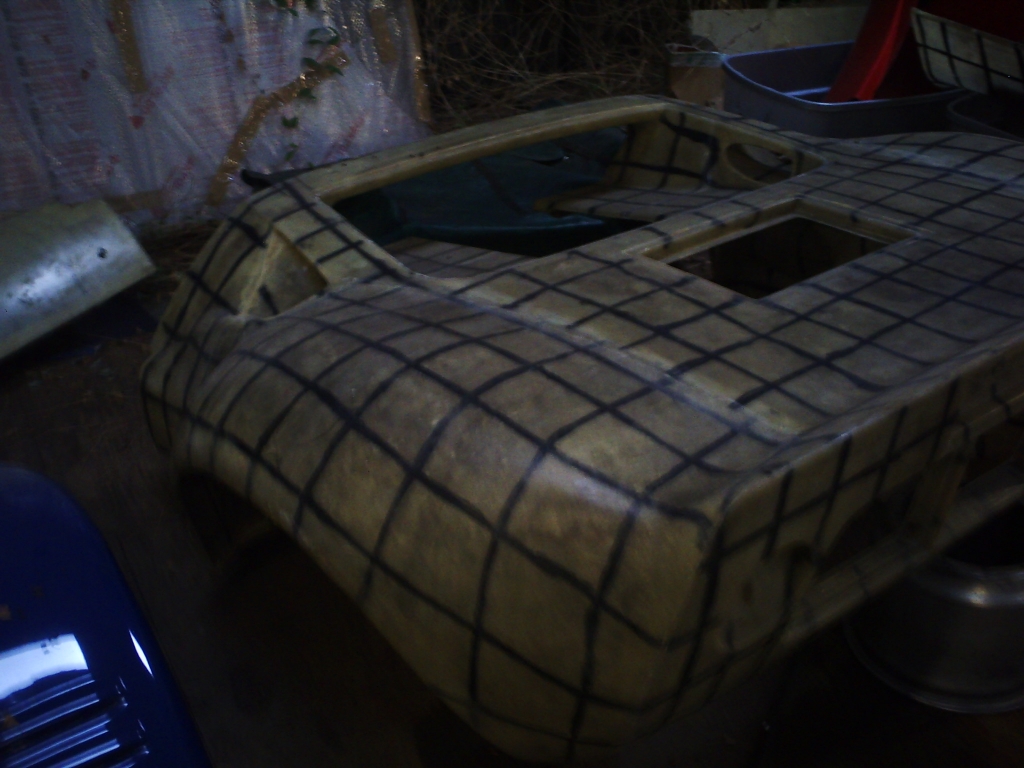

Is the rear vent hole in the clip normally this deep.
My glass body only has the top surface rebate for the vent sheet.
In the pic the vent panel apature seems to house a more elaborate vent.
Can anyone shed light on this.

My vent opening looks like that, the shallow opening measures 18.25" X 12", the deeper cutout measures approx 16.5" X 10.75" and is a little less than 1" deep, there is also 3/4" lip all around the bottom.
This is an original rear decklid so copies may have had the pocket deleted.

The depth of the opening on my GTD is very shallow - just enough to accomodate the sheet metal. ie a few mm.
