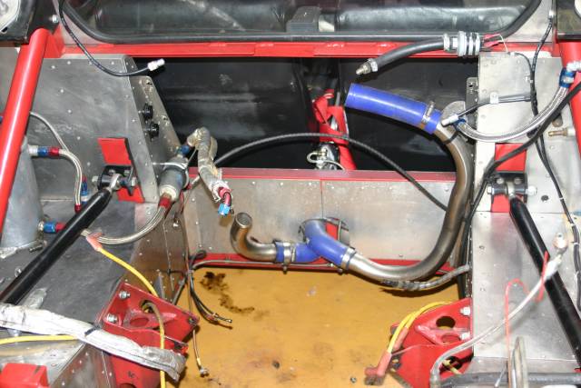

Hi Daniel
We moved the pipes to run down the centre of the cabin, one above the other. There is only one fuel tank, down the LHS but it is wider than normal, filling the space the coolant pipes normally occupy. Thus:
Subsequently, we moved the engine feed pipe by fitting pipework behind drivers seat (hidden by a panel). This was done as we now run a dry-sump and the nose of the pump was too close to the existing pipework. (oh, and there is no measured increase in cabin temp as the pipes are well lagged with some very effective insulation Roy sourced - in fact you can put a torch on one side of it and not feel any heat on the other!) Thus:
