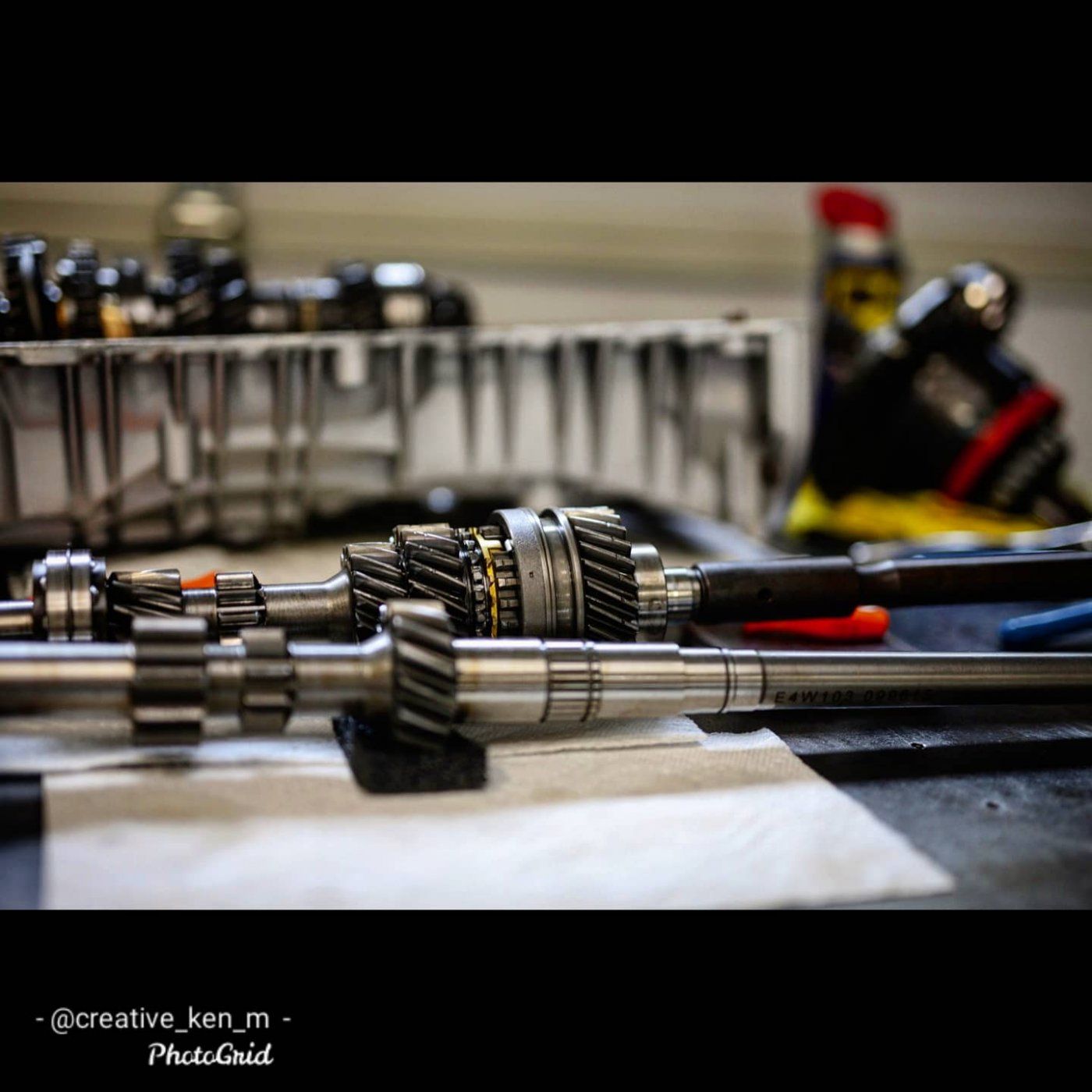

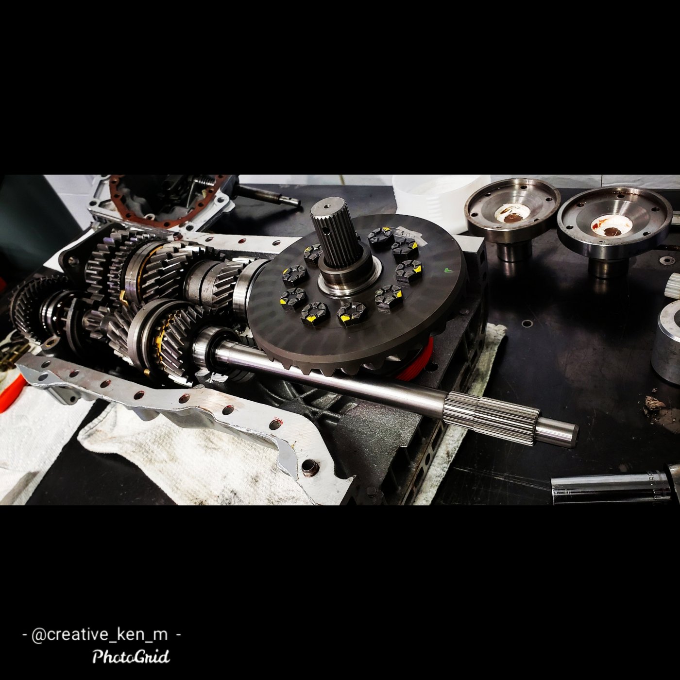

That is good to hear! I have just upgraded my UN1 with the GTO Race Engineering goodie package! One piece shaft, 1st-2nd, Quaife LSD. After I destroyed the pilot bearing, and damaged the original 2 piece shaft collet from dumping the clutch and doing donuts in my back parking lot. Oops! I guess hot Pilot 335s and a clutch dump or two can hurt.

Nothing is indestructible!! And remember these cars are track racing machines not drag cars ! Totally different set ups !!!! Just saying
