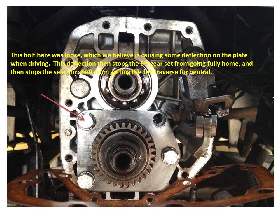

Strange.....Mine has just done the exact same thing. Had it out for a blast, running great with no issues. Parked it in the garage then came out 2 days later and it's all jammed up. I spoke with Chris this morning and he said that you and I had both called him on the same day with the same issue!
It'll be interesting to see what it is.....I'm taking the rear end off the gearbox now (with a little bit of phone help from Chris!) If I make any progress then I'll let you know.

Hi Steve,
I tried to find your number, but if you drop me a pm with it then I can give you a call. I've taken a pic, so hopefully this makes sense and might shed some light on your issue, as it sounds identical.
