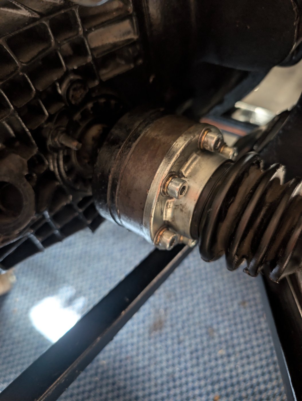

Evening guys,
I require the seals, o rings and pins...
Can anyone guide me as to where to get these in the UK .. Mines leaking!! Tia

I phoned up a main Renault dealer parts department and placed an order…..arrived in the post a couple of days later.
But that was a good few years ago now.

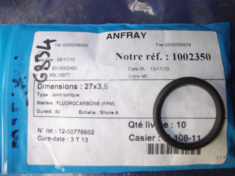

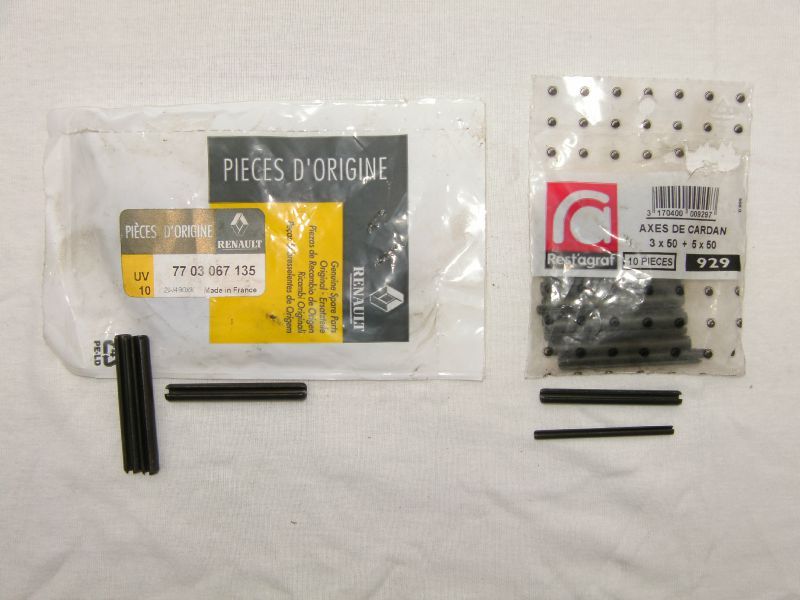

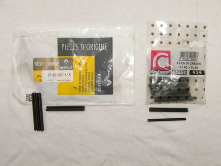

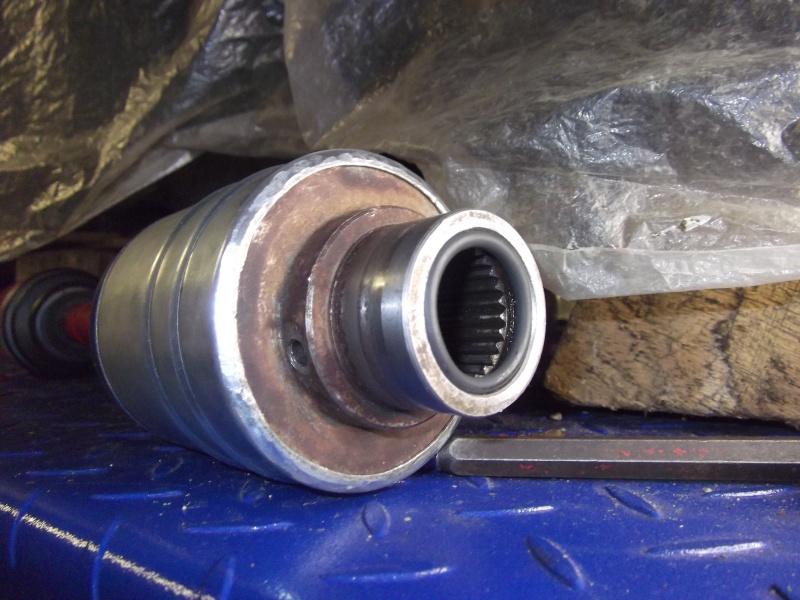

Paul Hendrickx
Réf. 21216 44 , de tailles 40-58-10 reference Peugeot gearbox ex 306 but also 206 just a fraction smaller on inner diameter to sit snug on driveshaft
outerpin and inner pin size
drive shift inner Seal
