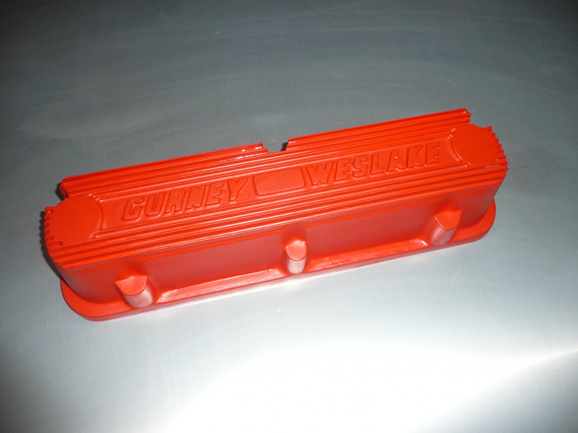

Those are our earlier version with the broken top fins.
The latest version has an unbroken top fin like in the attached picture.
Andy

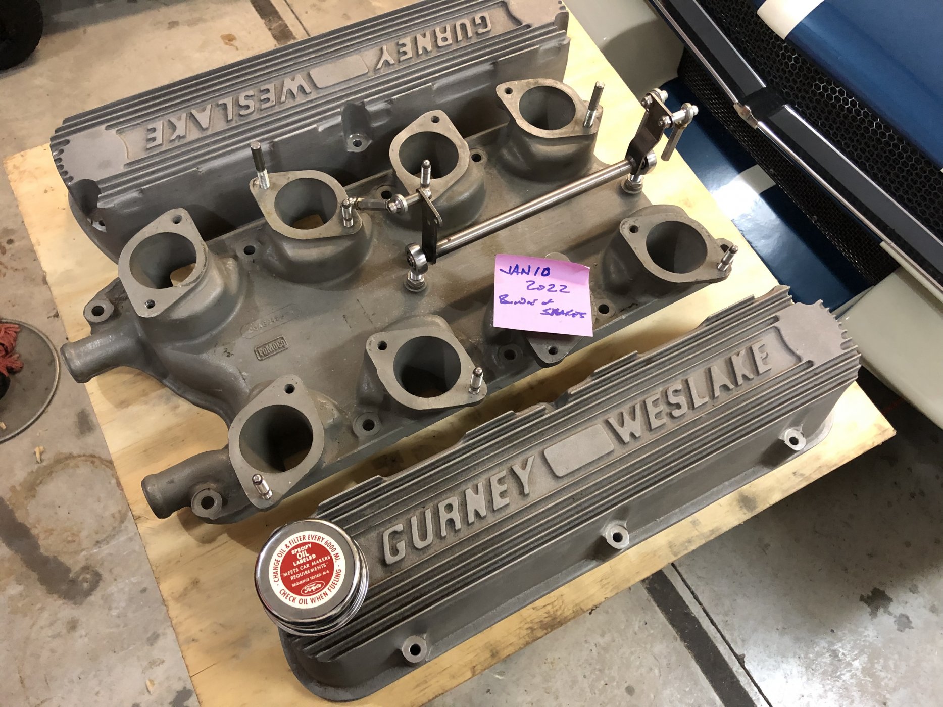

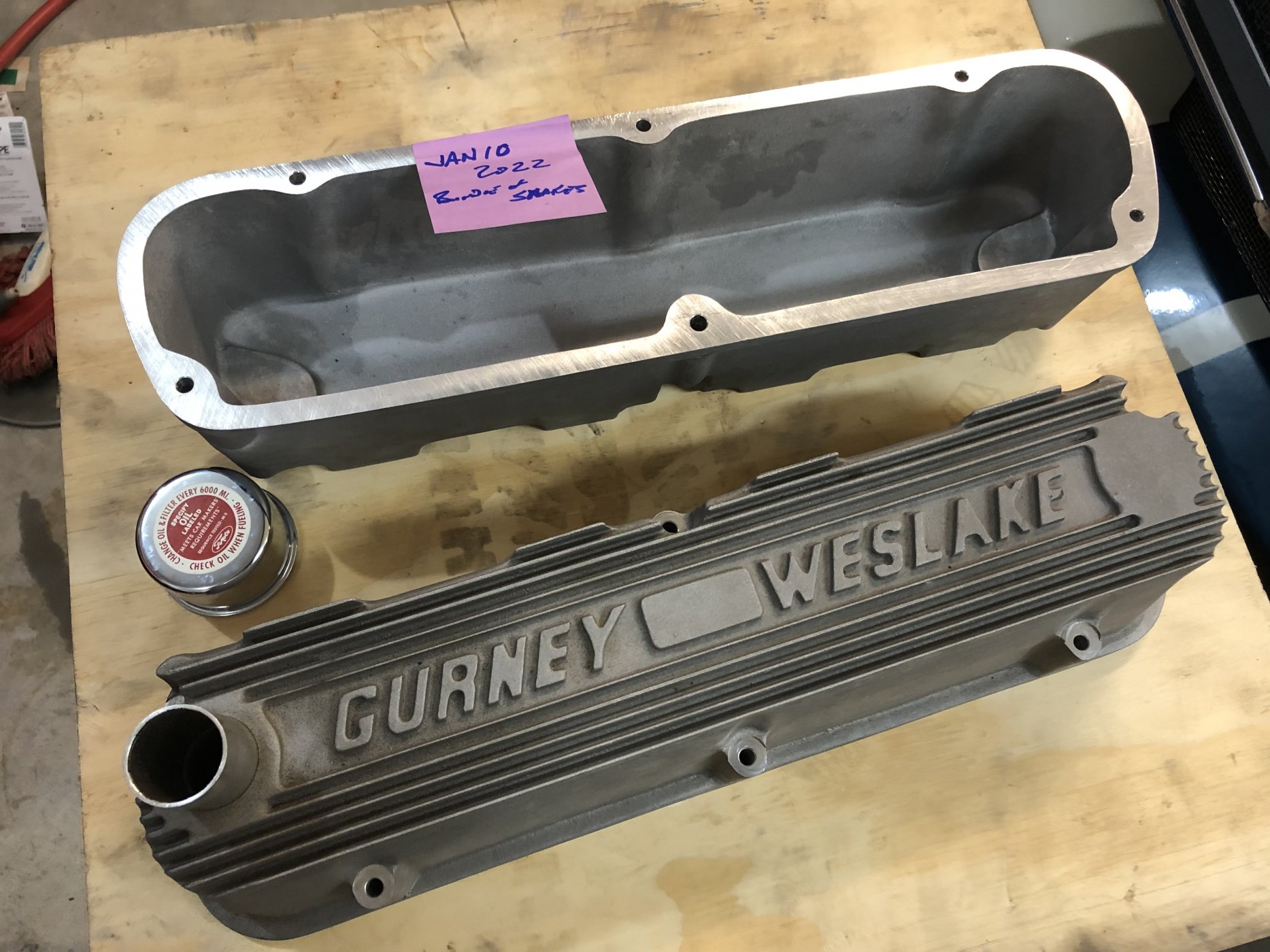

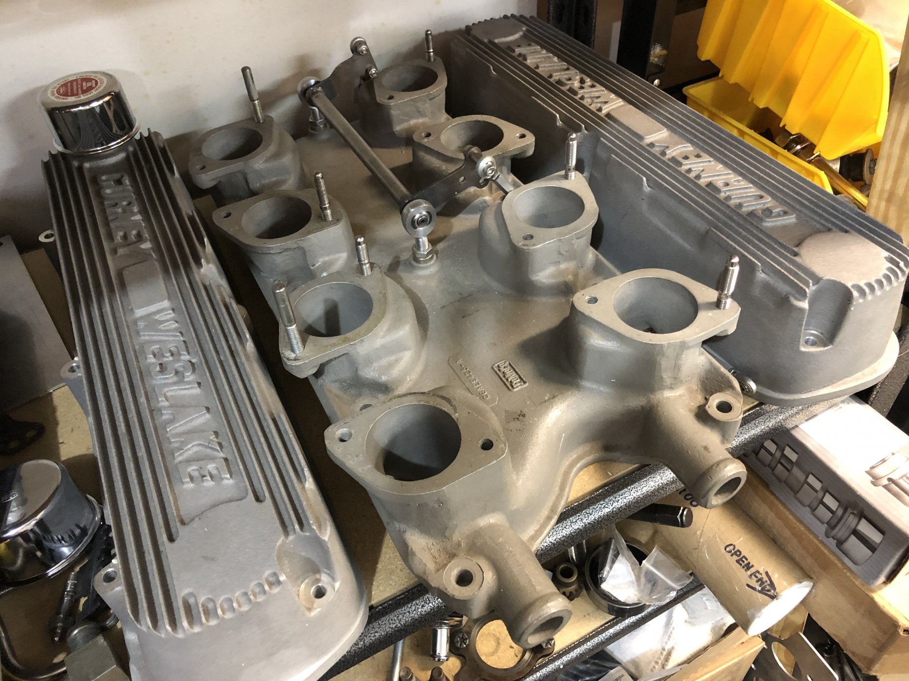

Hey guys, I haven’t been on this forum in quite some time. Anyway, I have a set of these Gurney Weslake valve covers. I don’t know if these are the early or late. I bought these from Chris Melia (sp?) I think back in 2010-11ish if I remember correctly. I’ve had the gasket surface corrected as well as the mounting holes corrected to fit 289-302,C6FE as well as any aftermarket SBF head.
I’ve test fitted them to my 65 350 and they clear my Crower roller rockers. I also have ab NOS C6AE FoMoCo Weber Manifold identical to the C6FE version. Currently collecting dust and occupying shelf space, but I’m not ready to part with them just yet.
