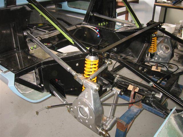

Let me explain it this way. With a reverse "A" arm the toe in is fixed and controlled by a solid attachment at one point ie the inner pivot. If the wheel moves backwards and forwards in plan view it scribes an arc about that centre pivot. If it moves forward you get toein if it moves back you get toeout. When you go to twin paralell lower links although the points on the upright remain the same the toein is controlled by an additional pivot point on the chassis. So in plan view you have a paralellogram instead of a triangle to locate the upright and so get no change in the wheel alignment as it is displaced fore and aft. A picture's probably worth a thousand words, but unfortunately I don't have one.
Pete McCluskey.
Thanks guys I now understand. (I think)
Ross a great idea to share your knowledge in the chassis Forum. That would
would be of great benefit to all of us I'm sure.

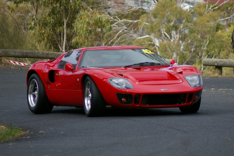

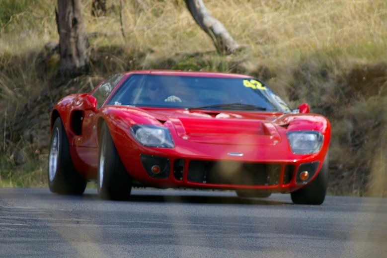

Here's a couple of pic's of RF085 car in it's first official event. It was used as a course car, and driven quite slowly but hey it's got a number on it. :)
I was busy in another car so the GT was driven by a friend.
Tim.

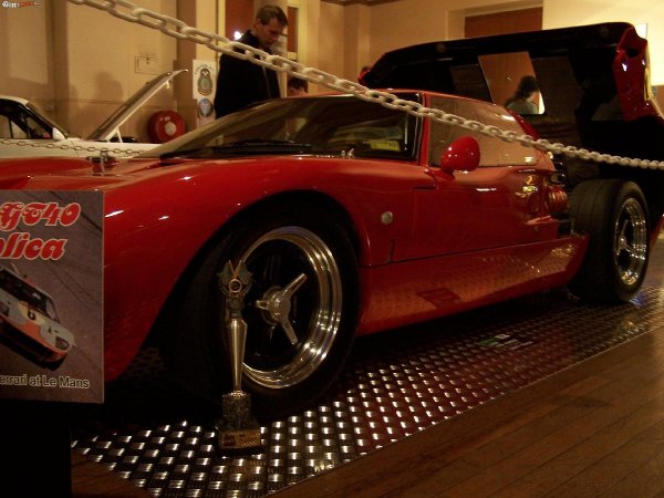

Here's a pic' of it at a recent show. The trophy is for "Best engineered".
I am very proud of this car. I had quite a lot to do with it's "development" and specification.
I have always maintained my appreciation to those at RF who did such a spectacular job. It is a hard thing to do that in an environment where so many feel burned by what's happened since.
Tim.
