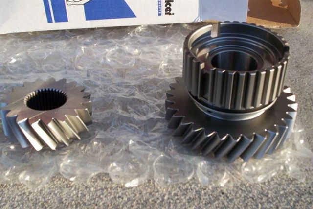

Mike, apologies if it's already been asked, but what was the cost of the RF 5th gear and what specific component(s) were included?
Hi Mike Any chance of a picture, and any thoughs why it would make more noise.
Regards
Graeme

Believe I paid RF $ 520 US. I'm sure Robert can provide
you current price/availability. I'll post a photo next
day or two.
MikeD

Looks to be somewhere around .7:1 based counting the teeth on half the cog and doubling it. I get 19 teeth on the little one and 29 to 31 or so on the larger.
Should translate into roughly 20% RPM reduction. Maybe Mike DD could count the teeth for us if it's still out of the car(?).

Mick, I was just checking the possible ratio’s in a speed calculator and I have to agree with you 100%. Unless we want to do 330 kph there would be little advantage other than very good fuel economy on the highway.
The Porsche 944 uses a fifth gear that is .7297:1 (27:37) p/n 016.311.353.E shifting gear 5th speed and p/n 016.311.159.R gear 5th speed. It's a popular conversion for the V8 944 guys for the turbo transaxles.
