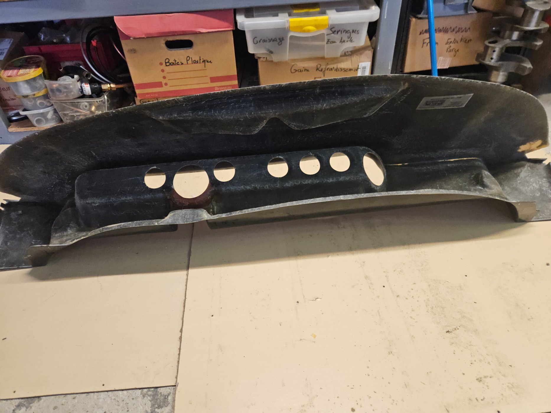

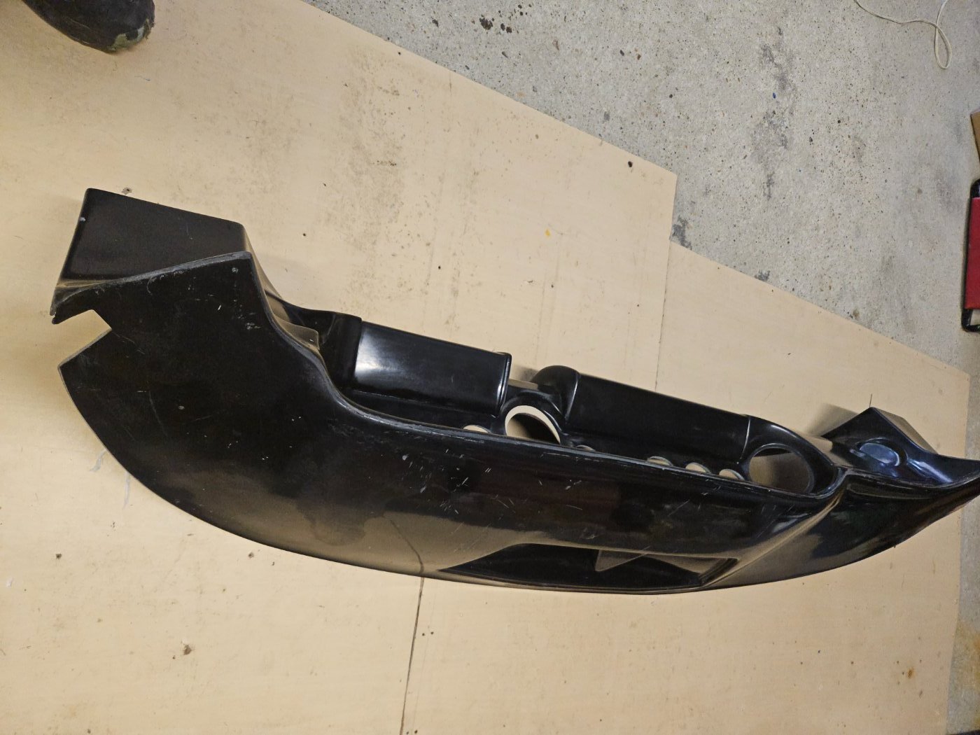

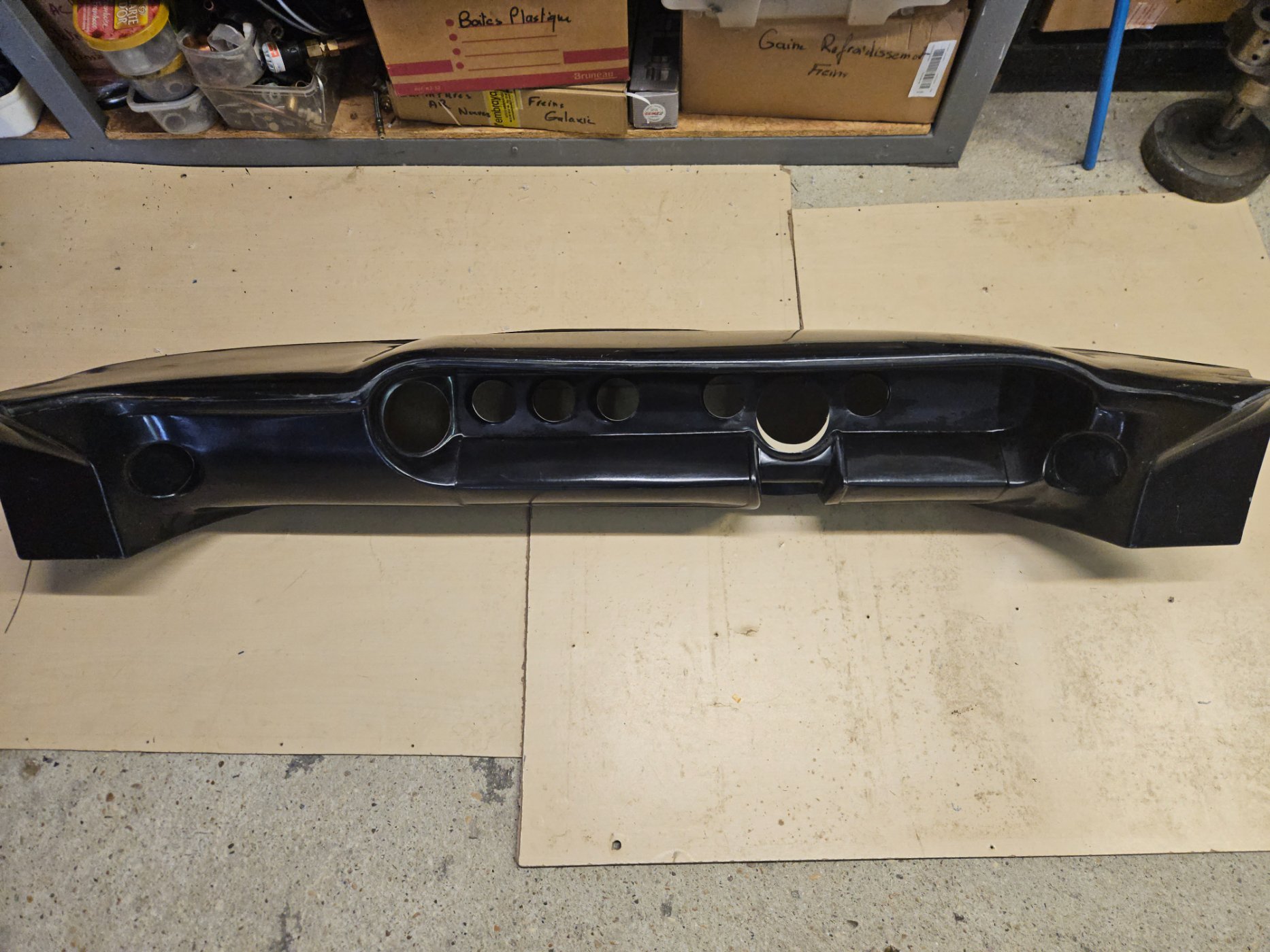

As posted above but converting a RHD to LHD is far more involved than just swapping the dash. You need to consider a new steering system, brake pedals and even the chassis spine will need to be cut out and shifted over because they are not symmetrical. In the long run it may b cheaper and easier to sell your chassis and buy a LHD example. However anything is possible with time and money!
