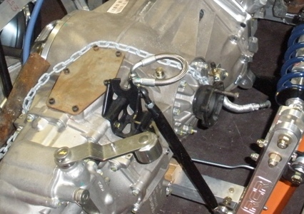

I was told the way to check the fill level on a Ricardo is to remove the nut just above the oil pan (drivers side) and check to see that the oil level is up to the bottom of that threaded hole. Then I've heard to fill, you squirt the QGT oil in that hole, hence the squirt cap on the Motorcraft 75w90 quart bottle. I also heard you can also fill through the vent cap located on top of the ricardo (PS).
I just want to make sure, I've got to add for the tranny cooler and don't want to assume...
Drain plug is on the p/s
Strainer is on the driver side
Level plug is on the driver side
Add oil until you bring the level up to the level plug.
W/o a cooler it should take 4 - 4 1/2qrts.
W/ the cooler installed, start car, depress clutch, run it through the gears several times, time car off, and you should be able to add 1/2 - 1qrt more until it dribbles out. Supposedly you can also then remove the rear sensor plug, run some pvc tube into it and dribble somemore in, but it doesn't seem like many people do that.
Washers are crush washers - change them after every use or leaky-leaky
The ONLY oil you should be using in this transaxle is Energear SHX-M. It's only available in Europe or from your ford dealer.
Also, transaxle oil should be changed every 4th oil change since little bitties can accumualte in it - also be sure to give the strainer a good cleaning (or buy a new one if you so desire)
There you go, everything you wanted to know about your transaxle.
