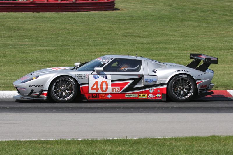

Alex, there are two shops that were or are running the GT 40 professionally, one was Kinetics Racing and the other is Robinson Motorsports both here in Georgia. They could probably answer the question about the length and pressure drop as well as how much air flow do you really need. My thinking is get fresh cool outside air instead of motor compartment air which is already probably 165 deg. I also have run my lines over my exhaust. The total length over the exhaust is about 6" and I wrapped and shielded it from the heat. Based on the limited space sometimes you have to place and plumb the best it can and that is how it has to go, then protect it as much as possible.
Robertson racing , and neither teams ran the stock street Ricardo transaxles...they both ran full sequential race only EMCO/Xtrac transaxles..
