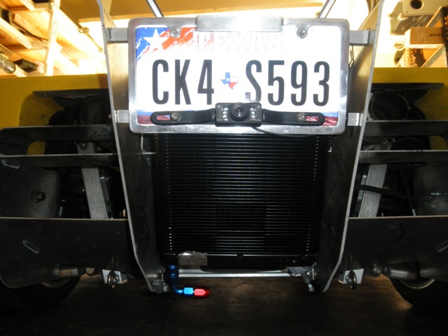

Probably not the optinal place for cooling but it looks bad ass. Not sure if yo have race or street tail.
