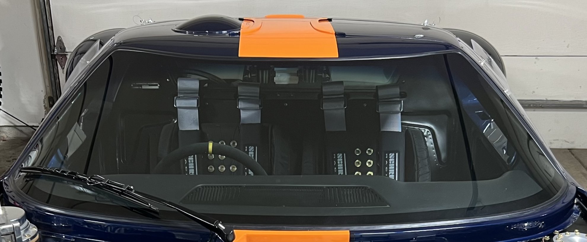

Rob Klein
This gives you an idea how close you are to being basically in the center of the car.
