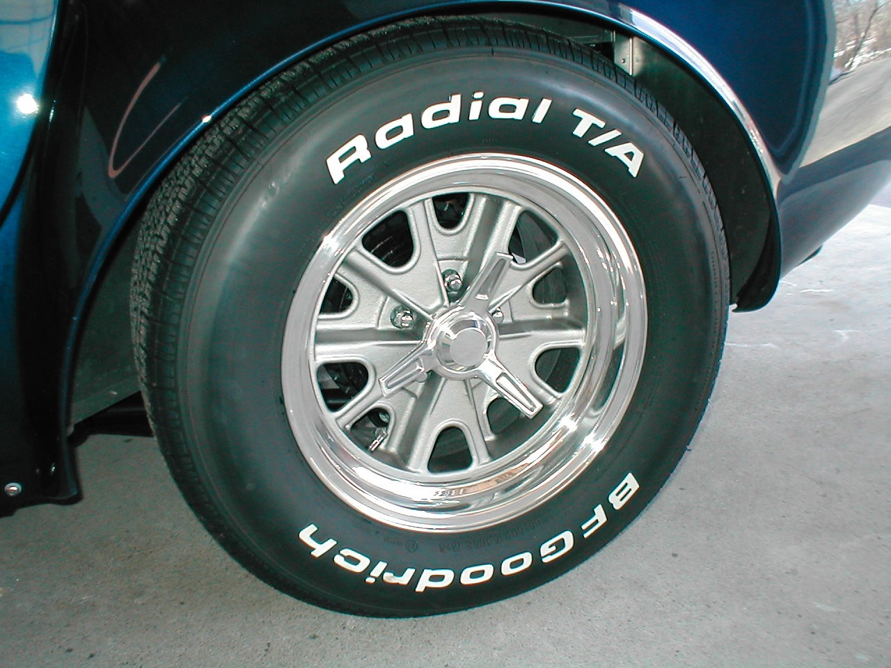

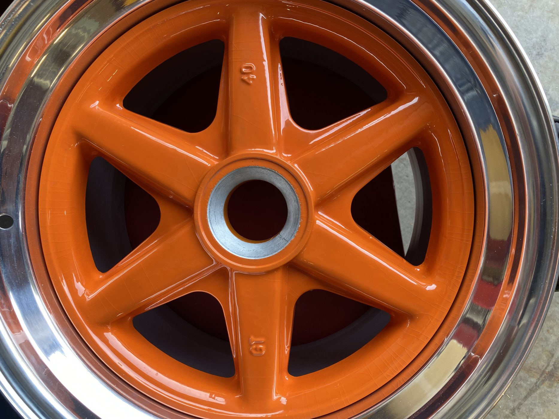

I used image wheels in the UK. They make 3 piece wheels so you can get any spacing you want.

X2 with vintagewheels. I had them do my cobra wheels, Bob was a pleasure to deal with and very helpful.
