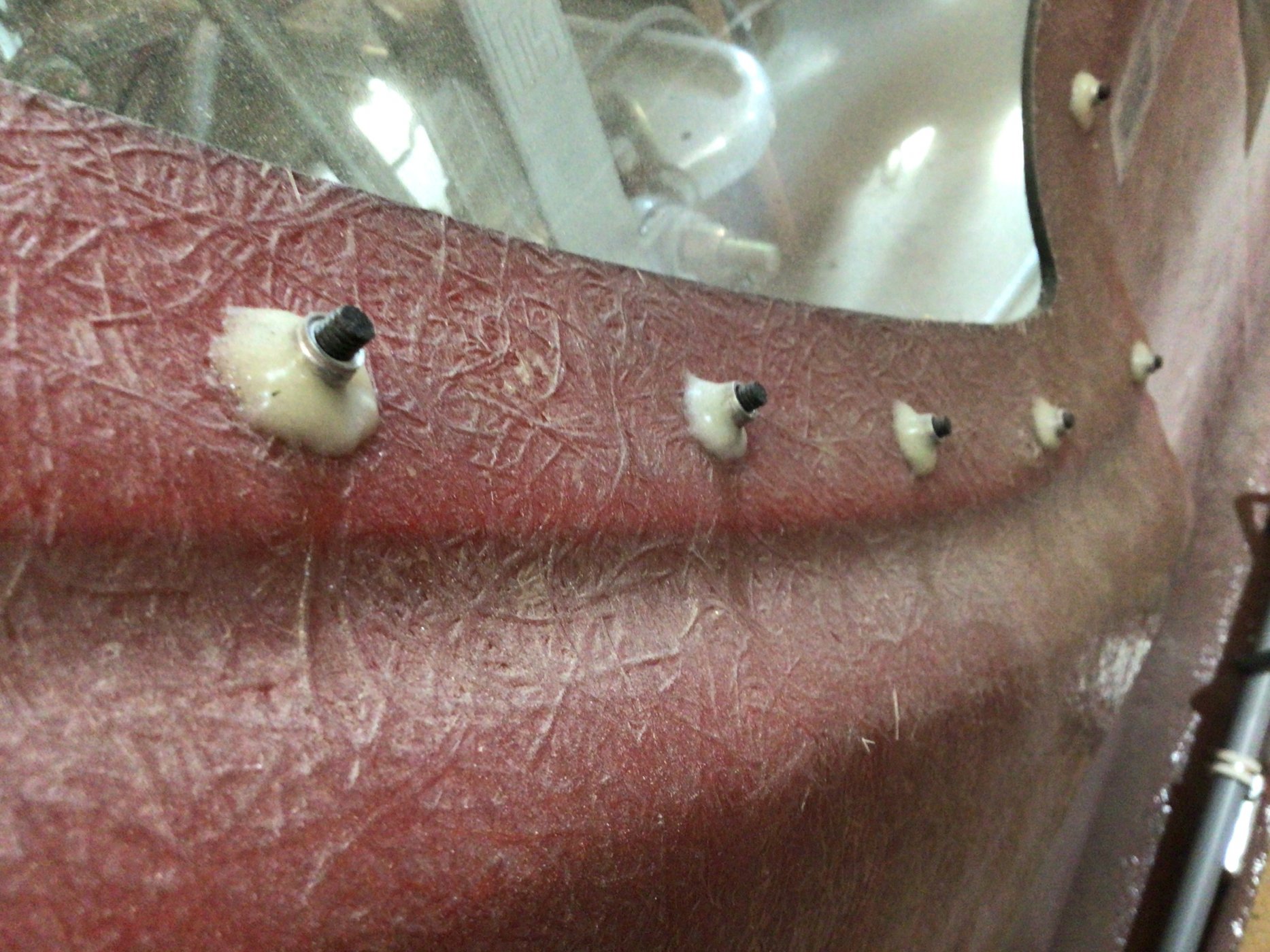

I used M3 aluminum riv-nuts, but super-glued them in. As the screws aren't going to be that tight, this is fine and if it does come loose, it's easy to remove as the body of the riv-nut has not been distorted
Andy
Neil

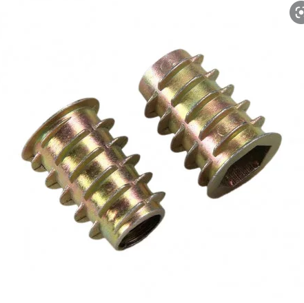

I'd thought about a nutsert suitable for wood backed with epoxy but like I mentioned, I'm considering ALL options :-)

If you're still working with an unfinished panel, the for-wood nutserts installed with resin/glass in a snug-sized hole works well. I've used this for the rear spoiler on a fiberglass panel, and have never had an issue. For finished panels where you don't want to mar any of the existing work, a superglued Helicoil is the best option. Clean, and holds very well. I've done this for the windows. As always, you want the affixed part to make contact with the insert itself, and not the panel material around it, else you create divots or dimples over time when torqued down.
