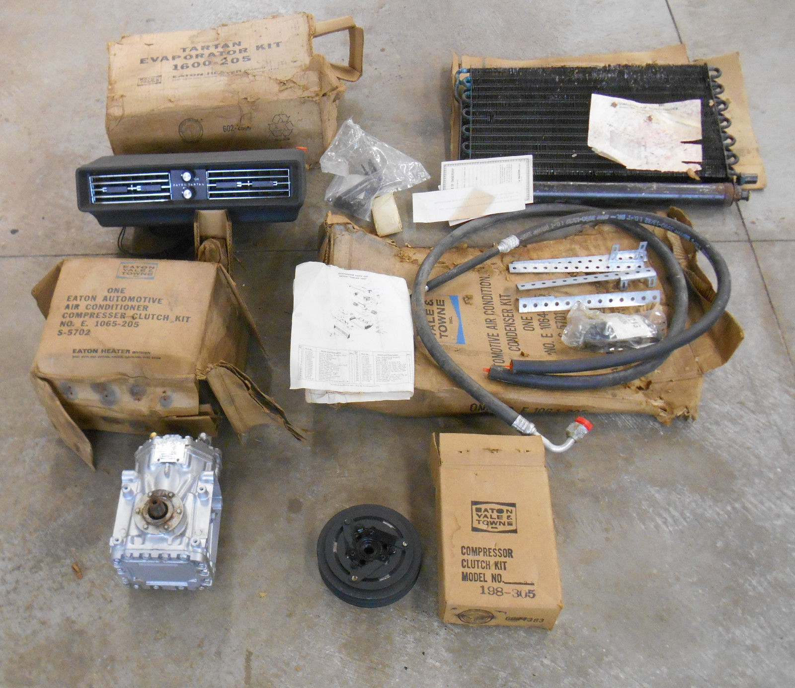

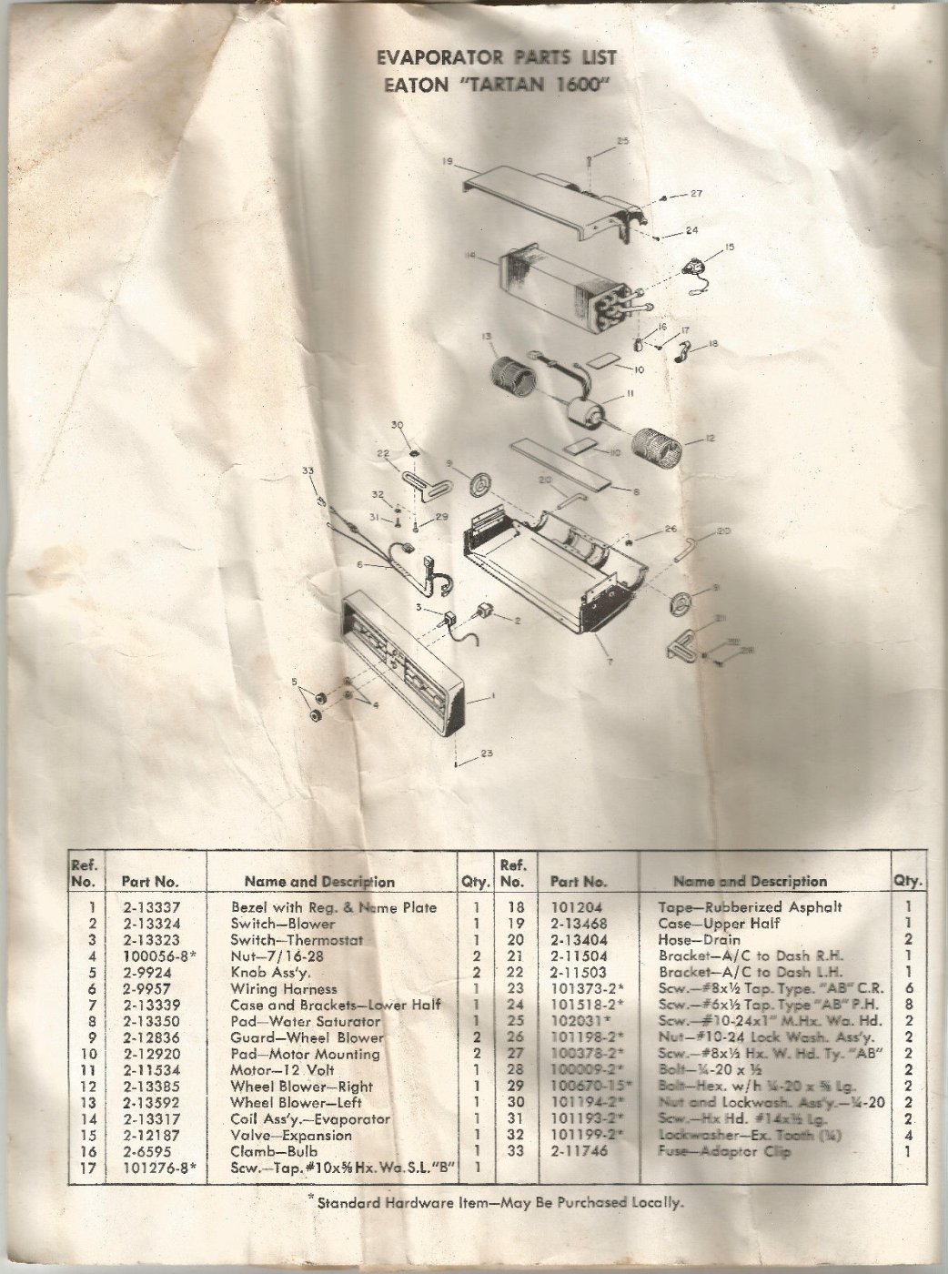

Some cars fitted with AC
JimmyMac
Eaton Tartan
Aftermarket made in USA

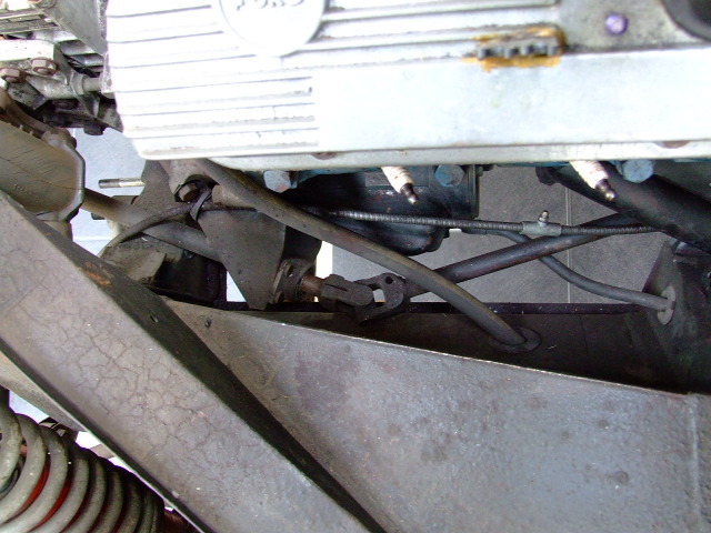

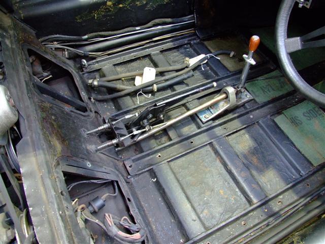

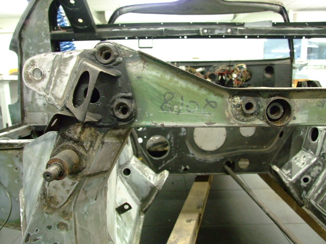

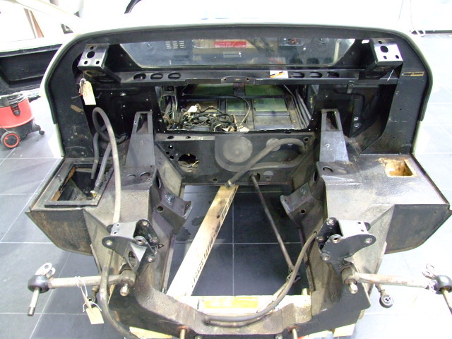

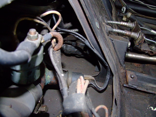

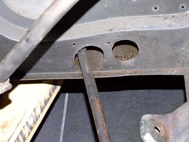

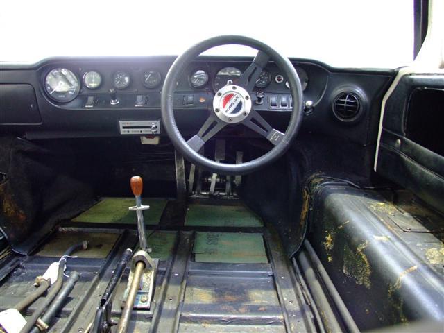

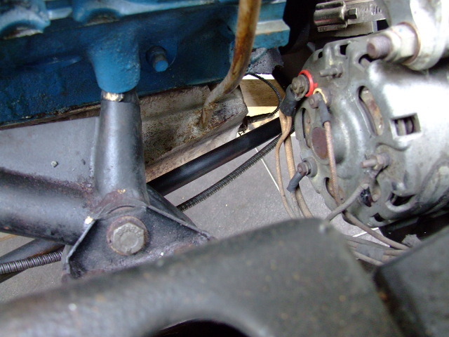

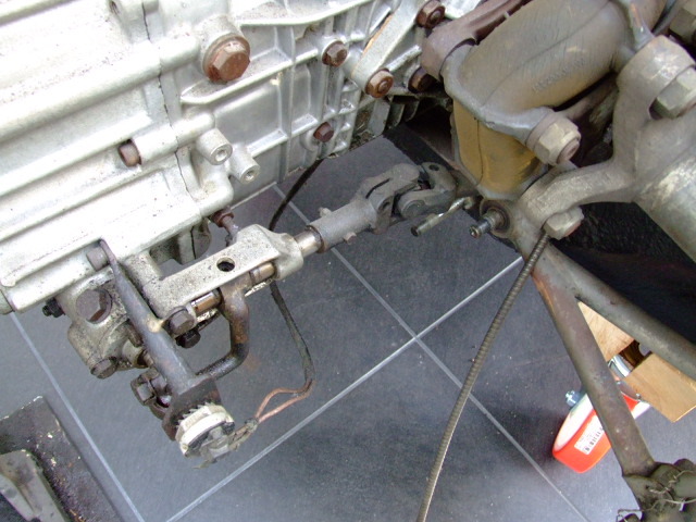

Does anyone have any information on the gear shift linkage used on the right hand drive Mk III cars? I am assuming it was a rod shift with u-joints similar to the Pantera but on the other side of the car out back? Any pictures would be very helpful. thanks
Pedro
Guest
Here are a few pictures

It's my understanding that within the various iterations of GT40 about thirty Mk1s were built as "road cars" to be sold to the public as part of the GT homologation requirements in order to race the car in the "GT" class. These road cars were all RHD, more trimmed out than the race cars and slightly detuned.
Some of these cars. in private hands, were upgraded to full race specifications.
The MkIII was built to what we know think of as a "globally federalized" specs. These GT40s had unique many features including flat floors, bumpers, raised headlights, extended rear clip, rerouted coolant pipes to the sills rather than central tunnel and some were built as left hand drive cars.

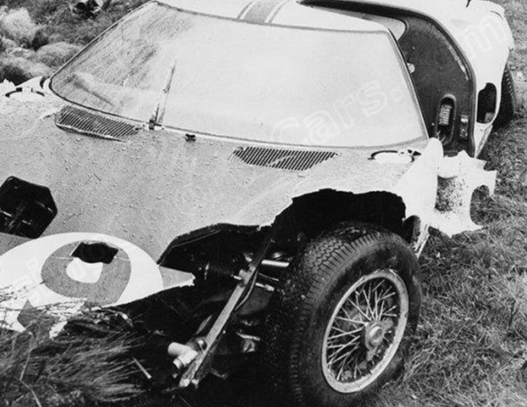

Road Cars Tyre Choice
Dunlop Front - 5.5 X 15 - Rears 7.25 X 15 - Oh Yes
Goodyear Front - 5.5 X 15 - Rears 7.00 X 15 - Oh Yes
There's an original photo of GT40 Road Car around after it crashed during a race with these tyres clearly fitted - probably why it's crashed.
Here's the photo which appears to show a road car used for racing probably/possibly on the original "road tyres".
Turning Circle - 37 Feet
The "Road Car" also had an engine bay illuminating light.

Going by the shape of the nostrils, the vents at the rear of the front clip, and the ducting in the B-pillar, I believe the photo posted above is of a very early prototype.
