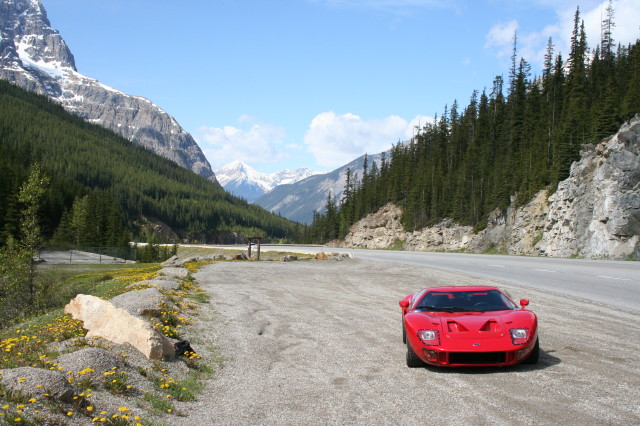

I just completed my first long road trip in the GT40 – 1400 miles through the Canadian Rockies to Calgary Alberta and back.

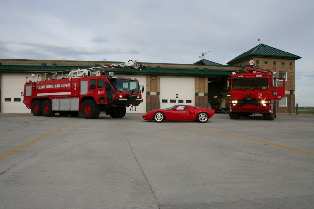

The car handled well at highway speeds on the very, very rough roads – I got a little sore in the rear after the constant pounding; only thing that came loose was a harness clamp and an acorn nut on one of the side vents. The car got pretty dirty so I visited the local fire hall to use their vehicle washing bay.

Nice looking car Col. and great scenery, very picherskew. (picturesque)
