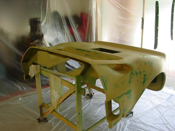

Second round of primer. Trying to apply color in two weeks over Memorial Day weekend

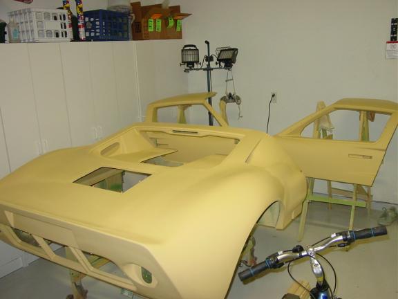

And after priming. Adjusted gun and actually sprayed much better.

Looks great Pat. What type of primer are you using? How many coats do you plan to use? I used Dupont 32430S high build primer. I averaged at least six coats before things started to look good, then sealed it. I thought I had all the defects out but more showed up in the paint booth.

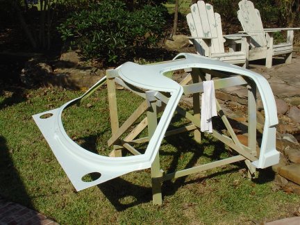

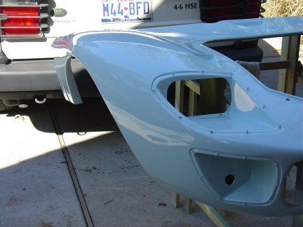

Well after many months of forced time off, I have been able to start back work. This past weekend I got color and clear on the front clip, spider, nostril and sill covers. Started on one of the doors but got a run and had to abandon it. Next step is to shoot the rear clip and doors, then mount it back on chassis in time for Christmas when my brother is here so I can make him help lay out stripes. Long day - 10 hours to do just this much work!

And spider. Color is from 1968 by Ford called Diamond Blue. Stripes to be Acapulco Metallic Blue.

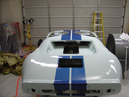

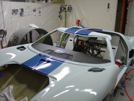

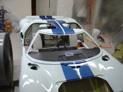

Well, yesterday I got the stripes done on the three main body sections. What a job! It took longer to lay out the stripes than it did to paint, touch-up and clear. Feels like I cleared a huge impasse, and may be actually see the finish.

And another. Still need to sand, buff, all that stuff, then coat the undersides.

I can safely say, that while happy to have done this (for over a year now), I will never paint another car!

That's a really nice color combination. How many coats of clear did you use? Keep me posted if you ever bring your car to any shows on the Gulf Coast. I'd love to check it out.
Re: RF52
Very different and very nice combination. Are the wheels going to be painted? One of the english guys had similar color combo with wheels painted the same as the strip, looked good.
