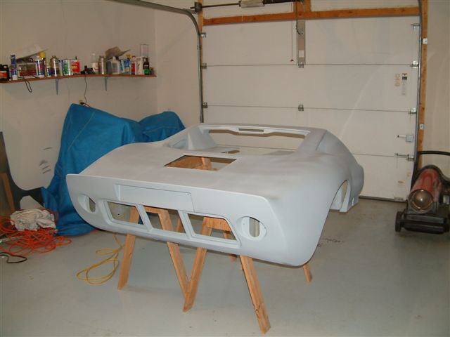

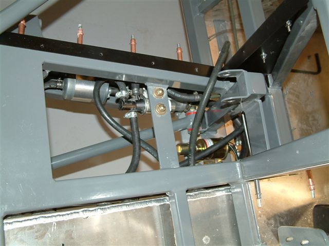

I haven't posted in a while, so I thought I would show the reverse progress. We have been dissambling to get the body ready for painting. Fuel system is pretty much in. Can't hook up the swan necks until after the body is painted. /ubbthreads/images/graemlins/cool.gif

Rolf,
The fuel caps should be fitted before the front clip is preped for painting as the over center release on the filler cap can foul the appeture (hole) in the front clip when it is opened and closed. This fouling must be fixed with a little to spare for the thickness of the paint prior to the paint job.
Phone me tomorrow if this is unclear (it seems a clear as MUD to me on re-read).
Best wishes,
Robert & Hersh /ubbthreads/images/graemlins/smile.gif

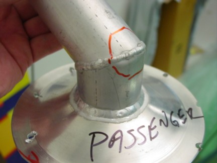

You should also mount the swan necks before painting so you don't tear up the front of the spider. You'll need to drill for the covers, then fit and drill the swan necks. I bought an extra fuel filler cap and drilled a hole in it, ran a bolt through it to a beam over the hole. This held it firmly in place while I drilled and fit the swan neck. Make sure your tanks are in so you can line up the necks with the tanks. I actually had to cut the outside bend of swan neck and have it welded shut to be able to fit in properly.

Robert Logan
Pat,
We have never had to do this on one of our cars. Please send me some more photographs so I can check out the reason for such work.
Robert
Hershal fitted the filler caps when he was out here last November. I'll dummy fit everything again before I pull the spider off for priming.

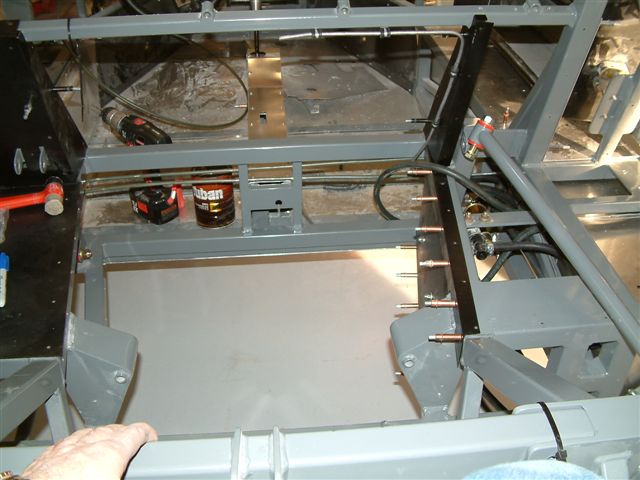

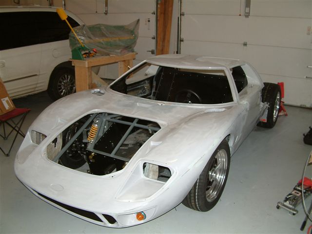

Well I've had a few good weekend when I could work on the car. It now can stand on its own legs (tires). Steering works and the brakes work too. Clutch hydraulics installed. Next I start on the coolent system. Aft clip is primed. Pics to follow (hopefully). /ubbthreads/images/graemlins/cool.gif

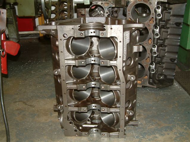

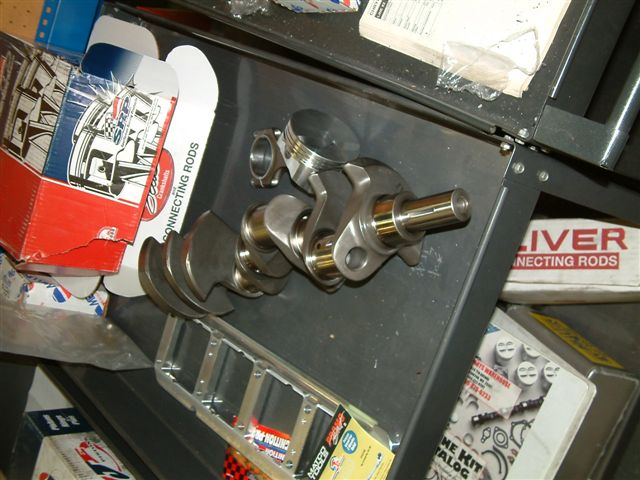

Just an update. The engine is starting to go together. The transaxle is done. The body panels are going to be sealed this week end. There is still Hope! Enclosed some pics of the engine.

Rolf,
Your tanasity is paying off. I am amazed at the progress!!
I can't wait to see this GT finished. You really are doing a super job.

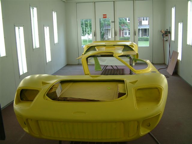

Spent all day yesterday in the paint booth. It took ten coats of base coat to hide the primer! I hope to finish the stripes and clear coat it this morning. Here /ubbthreads/images/graemlins/smile.gif are some pics of the base coat. Still negotiating with Motec re the wiring loom.
