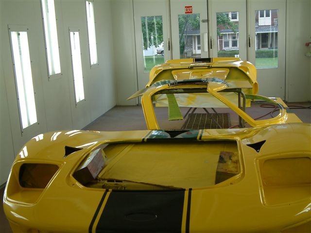

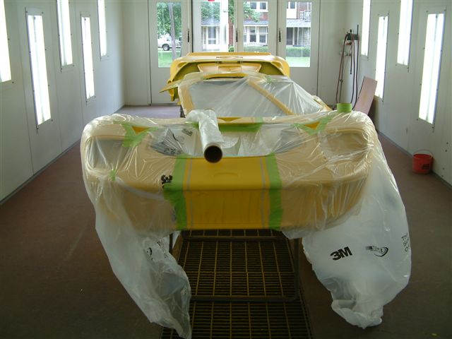

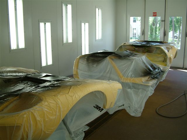

Spent another day in the paint booth. I decided to go with a 12 inch center stripe with 1/2 inch boarder stripes.
To follow are pictures of the masking and stripe followed by clearcoat.
Rolf /ubbthreads/images/graemlins/smirk.gif

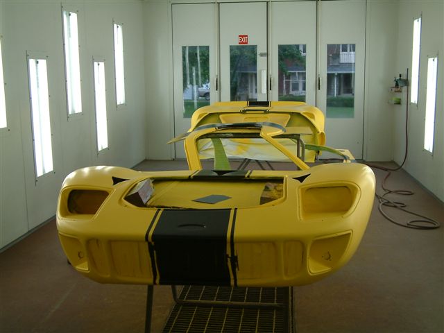

and more painting /ubbthreads/images/graemlins/tongue.gif

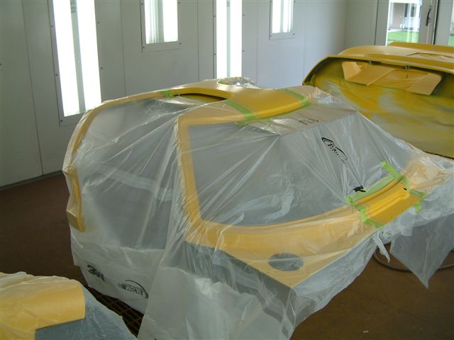

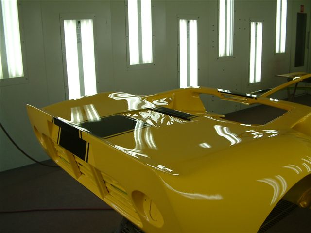

another view of the rear clip /ubbthreads/images/graemlins/laugh.gif

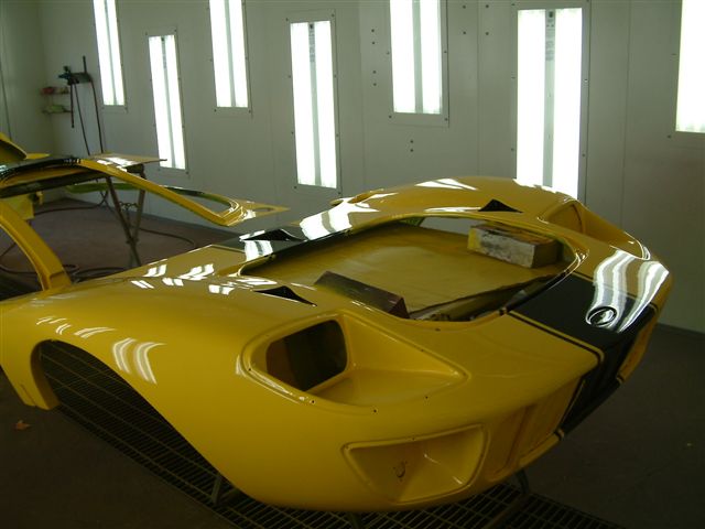

front clip /ubbthreads/images/graemlins/cool.gif

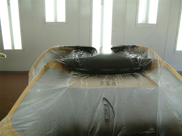

the spyder /ubbthreads/images/graemlins/laugh.gif

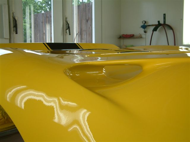

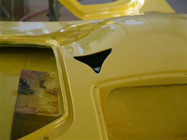

and a naca duct. Ok, I got a little carried away. Tomorrow I'll start learning how to buff and polish! /ubbthreads/images/graemlins/grin.gif

Very nice! How did you lay out the stripes? Did you take measurements before dissasembly? I was thinking I'd have to re-assemble after color, lay out stripes, then dissassemble and paint stripes. I'm curious about what paints you choose. The guy I've been talking to wants me to paint and clear, then sand with 600 grit, paint stripes and then clear again. I would beat with your method there is not much of a bump where the stripes are.
I will be very interested to hear about your specifics!
Rolf, it's looking great...your rate of progress is astounding. AFter reading your posts and Pat's, I went out and burned through about 15 sheets of sandpaper today. I'm motivated!
Pat
We did the front clip,spyder and rear clip together in the booth. We laid the stripes out using the clips in approximation with the spyder /ubbthreads/images/graemlins/crazy.gif. When the car is further along we will base coat the doors, then hang them on the car with the spyder and mask them out. I think we spent over six hours masking out the car. If you do the stripe after the clear coat you will get a ridge. Its probably not going to be that obvious but it will be there. We did not do any sanding once the base coat was on. Duponts product info sheets suggests that the clear coat should go on within 24 hours of the base which we observed. You can download all this stuff from their corporate web site.
