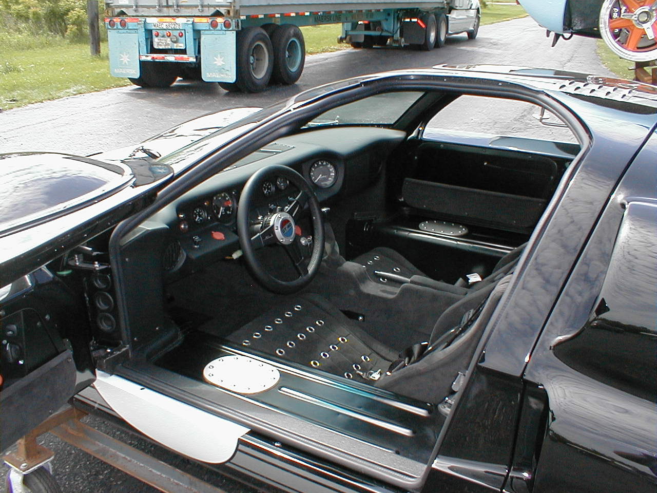

On the superformance cars, how are the side fiberglass rocker panels attached, at the top where the sill panel is, not just the attachment points underneath, thanks
-Steve
Rick Muck- Mark IV
GT40s Sponsor
They are attached with countersunk machine screws as per this picture (the only one I can find right now)
