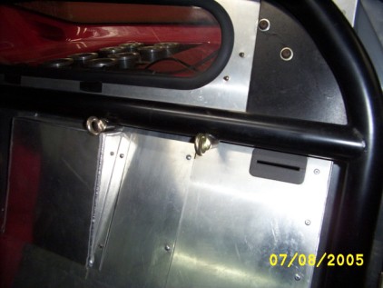

Here's my setup Chris
Thanks Ross. I have the same eyelets provided with my roll bar too but the problem is that they sit immediately behind the seat and would force me to move the seat forward (or modify the seat). Did you have to deal with that problem?
Ross Nicol
Ah yes the difference may be that I have the fibreglass race seats with holes for the belts to come through and you have the stock seats.Unless you change the seats Chris I reckon you could make brackets that utilize the eyelets to raise belt pickup points.My seats do have enough room behind them for the buckles too.
Ross
