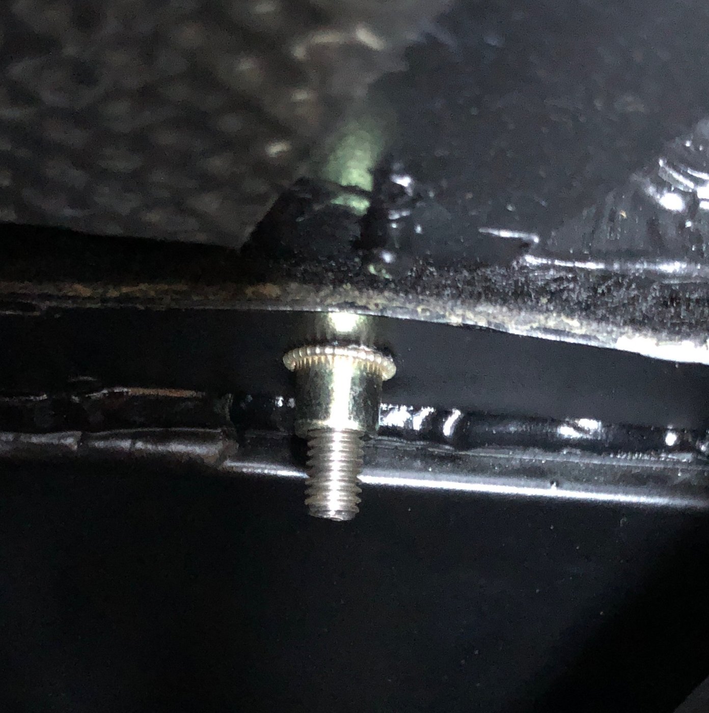

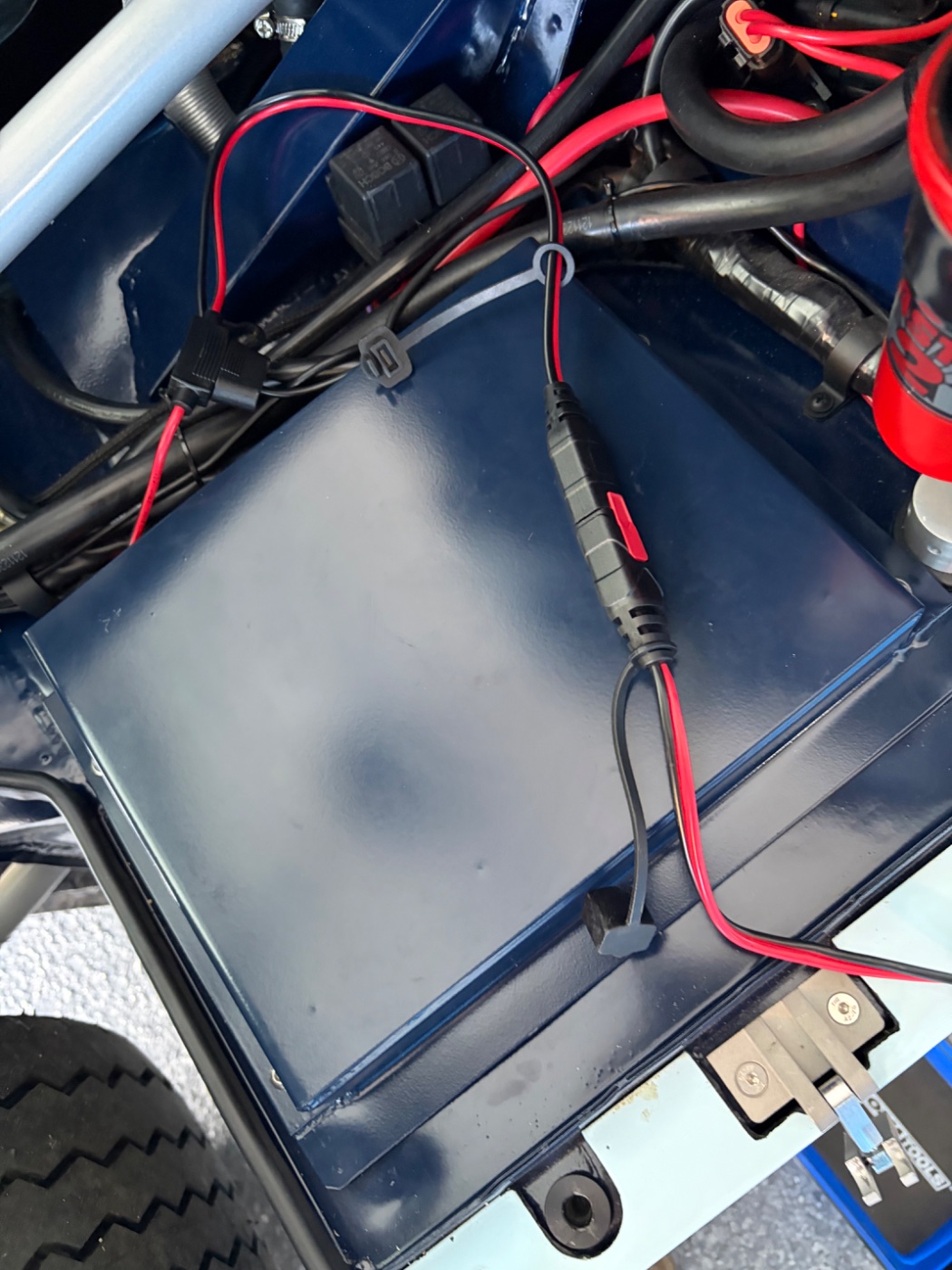

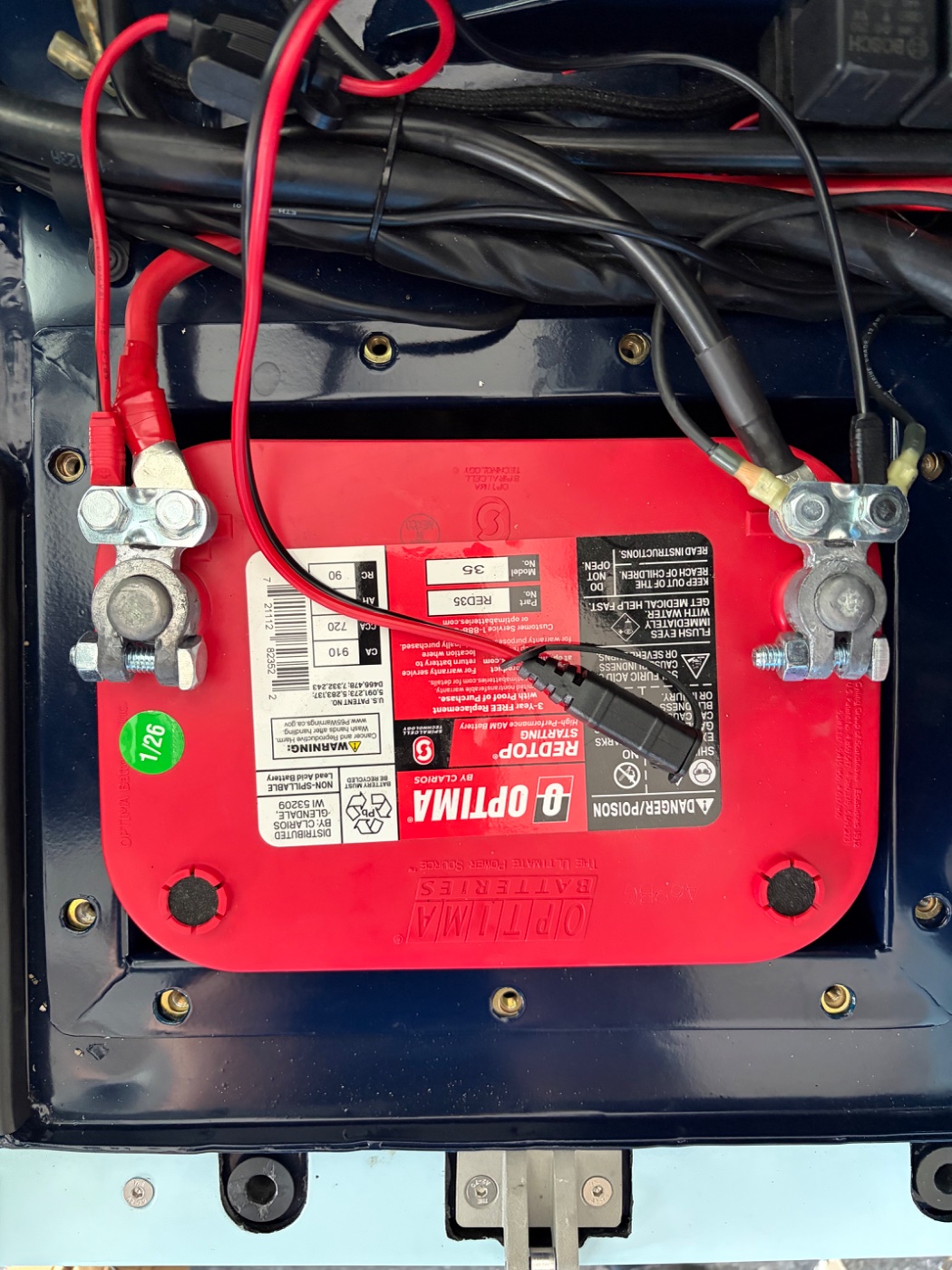

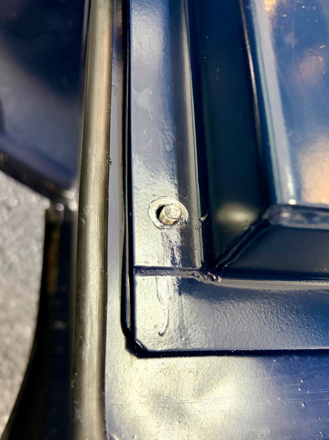

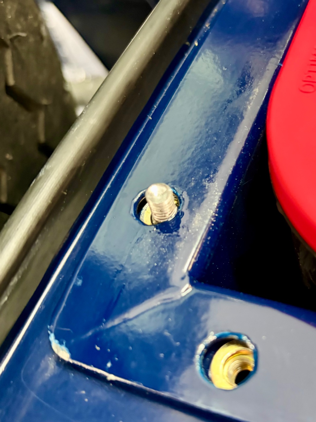

Adding battery tender quick connect, everything was going fine until last battery box screw reinstall. Looks / feels cross-threaded, spins all day but neither inserts or removes, so I’m guessing the screw nut fitting below is now loose or something. Of course, there’s no clean way to swing the battery cover away to look-see even with the other screws removed—tried that.
I suppose the good news is that the tender pigtail and eyelets are on, good to go, so we won’t need direct battery access near term. Open to suggestions for what to try or cut next. Figure it makes most sense to sacrifice the screw head … Not a lot of room to operate a dremel or saw though.
Thoughts?

I took a cutting wheel to my bat cover to allow access. If I remember correctly, the nuts are a nutcert into the tub below the actual battery box. One must have broken loose. You would have to remove the battery and battery box to see what is broken loose. My BatteryTender wires run to the back and hang along the tub.
Riv-nuts work well in thin sheet metal due to their bulbed expansion behind the drilled hole. Nutserts, on the other hand, exhibit poor retention in sheet metal, but are fine for thick material or blind holes. Are your threaded fasteners really Riv-nuts?
Don
OH, so that's what's spinning below. Well, tried the pry up and back out approach, nogo. Wonder if I can drill the button head to fall off then just use & cap the exposed bolt threads as a stud for now, taking on / off the battery cover as needed going forward.
