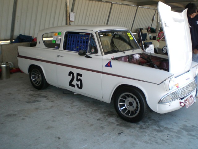

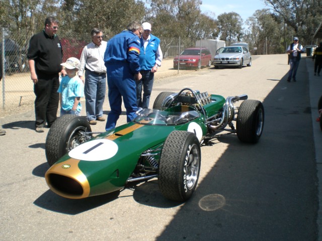

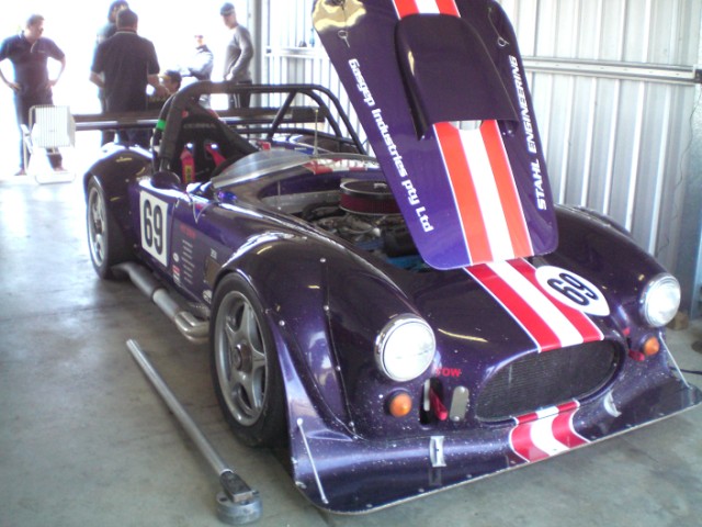

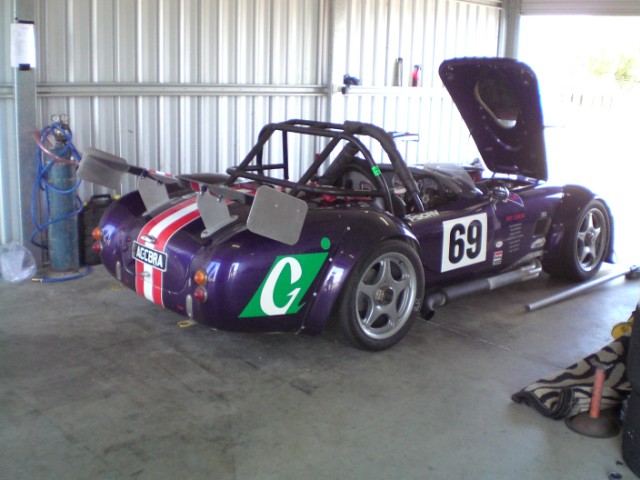

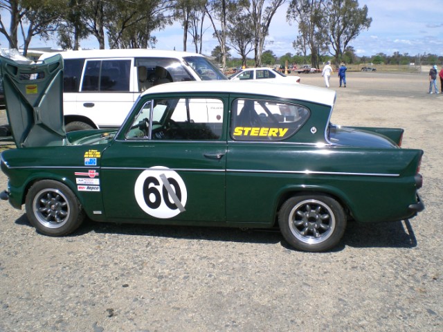

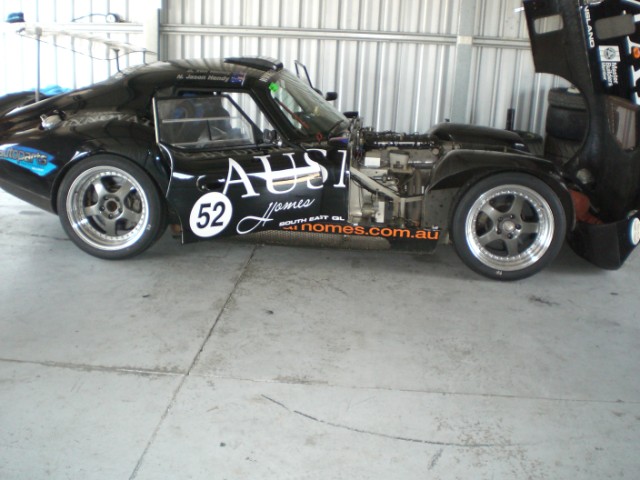

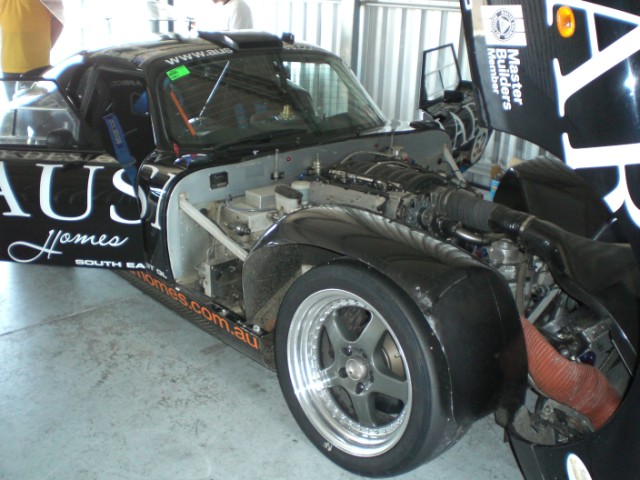

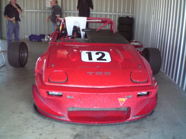

Here are some pics I took, among them are my competitors TR8 (red open top),Black Daytona Cobra, Purple DRB Cobra.Also 2 Ford Anglia 105E with slant back window, I raced one of these back in 1971 seems like yesterday.
