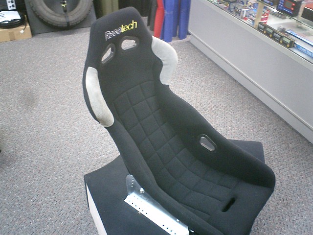

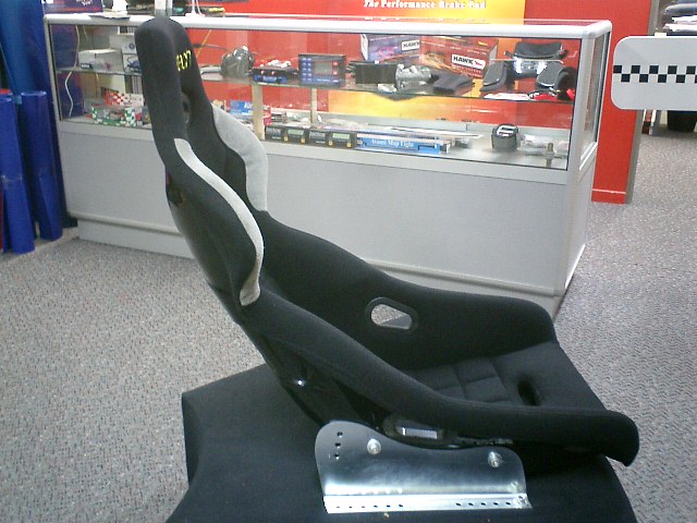

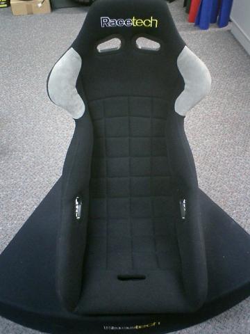

Here are a few pics...
is that the 28 degree layback? Seems a bit "upright" in those pictures compared to how racetech describes it, or is it just mounted on different brackets to make it sit up higher?

I took my trusty angle finder and checked out the different angles that are in the Saker seat. First off, the angle of inclination in a GT-40(DRB) is only 20* from vertical. The slope of the Saker is built to replicate the spine in the "average" occupant. At the level of the lower spine(waist) the angle is 38*. At the mid thoracic region(chest cage at the nipple line) the angle is about 28-30* to almost truly vertical at the head. These measurements are general in that the shape of the seat is somewhat rounded. The angle given is probably an average of the various angles.
The back of the seat truly matches the shape of the GT-40 even with the differences in the angular measurements. It fits very close to the fire wall. Pushed back it is difficult to get ones hand behind the seat.
In my car the rear wall goes vertical from the floor about 4 inches and then begins its slope. The ledge of the gas tanks is about8 to 10". So you don't see the "gap" at the very bottom of the seat, just the mid thoracic level which is matching the angle of the rear wall.

Bill I love this stuff :) Taking you specs there and plugging them into CAD to see what works here. Where I luck out is the rear firewall in this chassis I'm building isn't nearly as constrictive as the DRB seems to be.
They do appear to be a bit more upright than I had imagined, but in the application I'm planning here laying them back a bit more looks like it will achieve what I need here. The mounts themselves will be part of the tube chassis and can be configured as I see fit.
