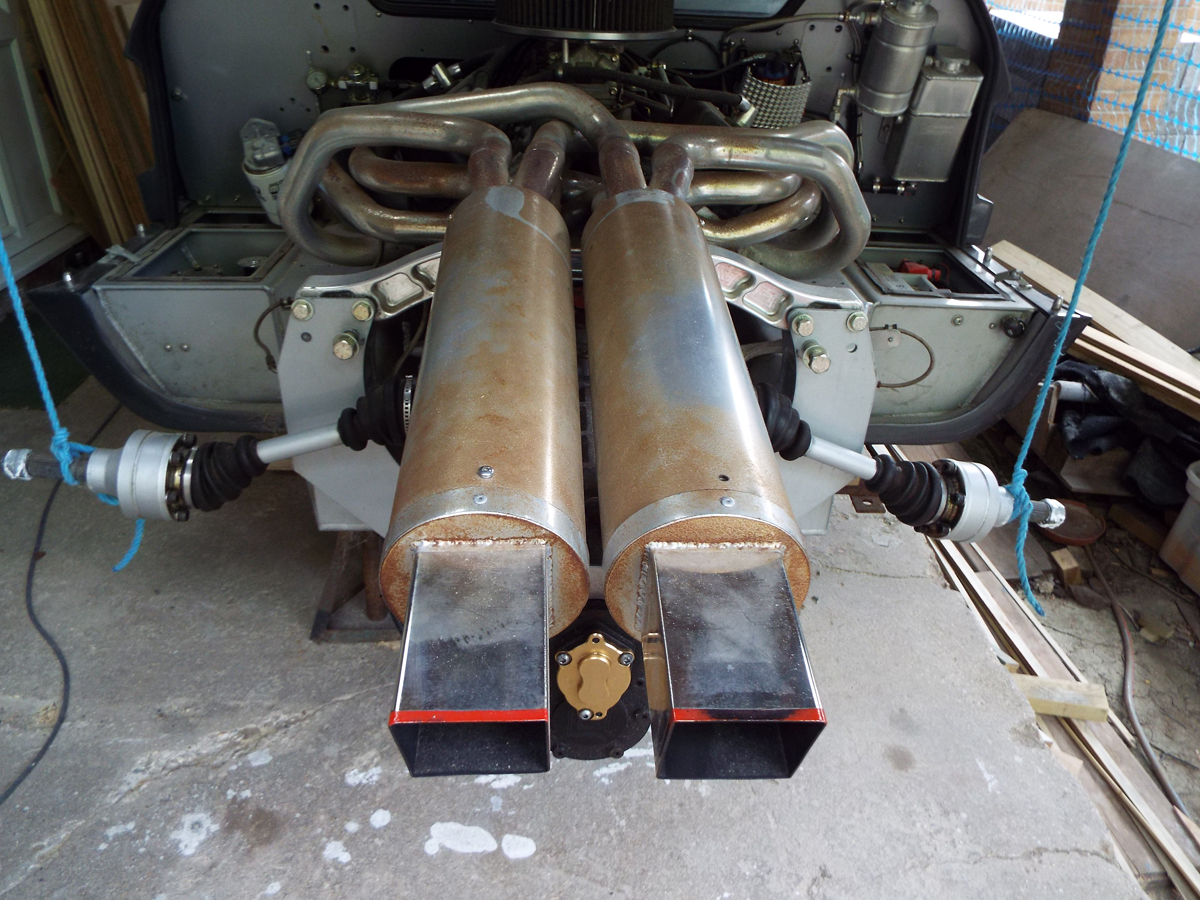

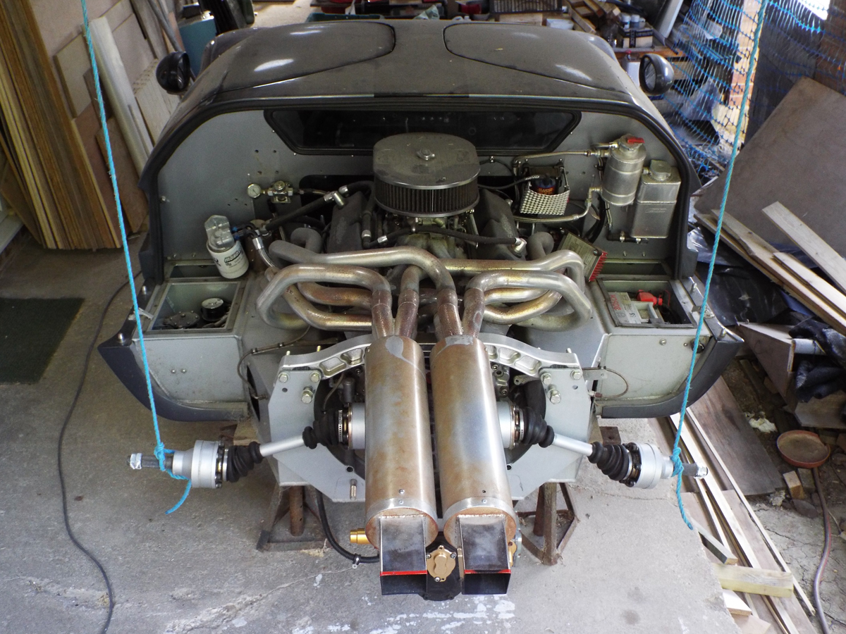

Will it be alright to do this , with it out of gear of course ? or will the driveshafts flail about like some medieval torture device ? Driveshafts are resting on horses at the moment . No rear wheels or hubs fitted. Quaife gearbox. Could do with a run .

I'd remove the 1/2 shafts just to be on the safe side if for no other reason. They can't "flail" if they're not there.
You should have some sort of exhaust in place as well. From what you've stated about having an exhaust system made, it sounds as though there is none in place presently. It may be an old 'myth', but, the idea of warping a valve or two from cold air hitting them after the engine is shut down doesn't seem worth the risk to me either.

Well, I've tested a new gearbox install by "driving the car" with the rear on axle stands, so there are levels of risk here :) I'd certainly do it. Just on the starter you'll quickly see if there's any movement, but out of gear it seems pretty unlikely.

Take te cv's and axles off. I ran on idle my GTM (successfully) with wheels on but... The oil friction in the transaxle caused the wheels to rotate. I applied the e brake and wheel rotation stopped, all was good. I believe your axles would try to rotate but no real power transmission unless you put it in gear.

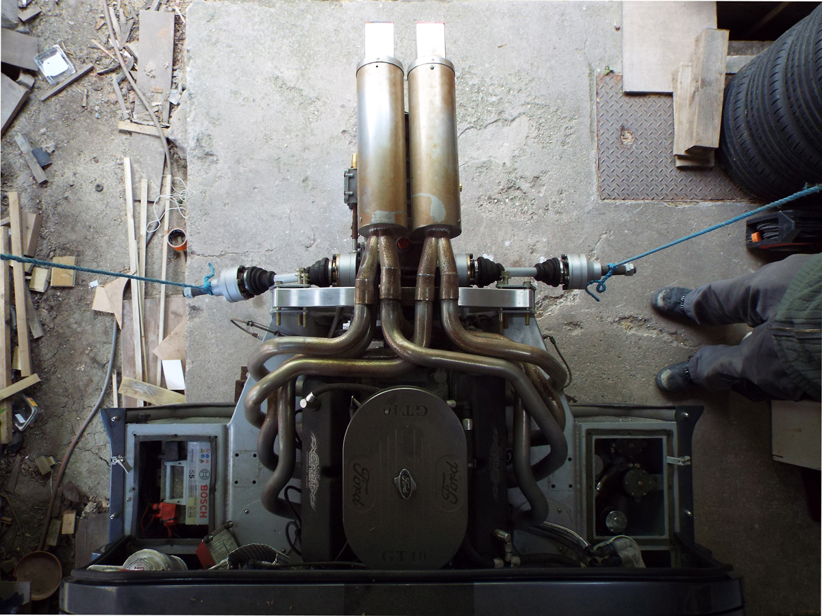

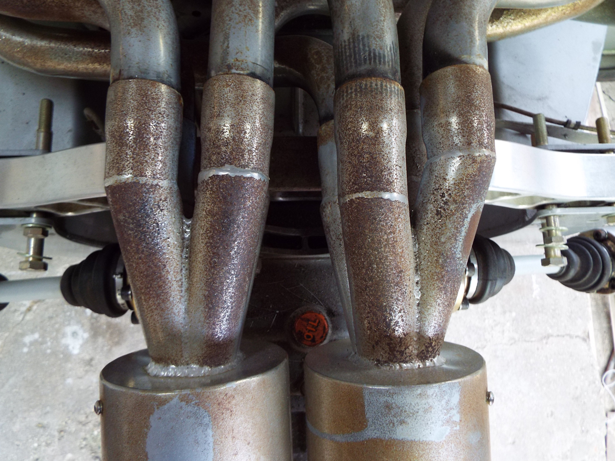

Thanks for the advice everyone . The old exhaust is still fitted. It works alright , just rusty and the back boxes are crooked , so not sure if they could be straightened up. Stainless does look blingy though . Will try to rejuvenate the one that is on first.
Never thought about the trailer option , depends if the place is local or not.
I see the back boxes / 4 into 1 / tailpipes are available off the shelf but the front pipes would be to order ?

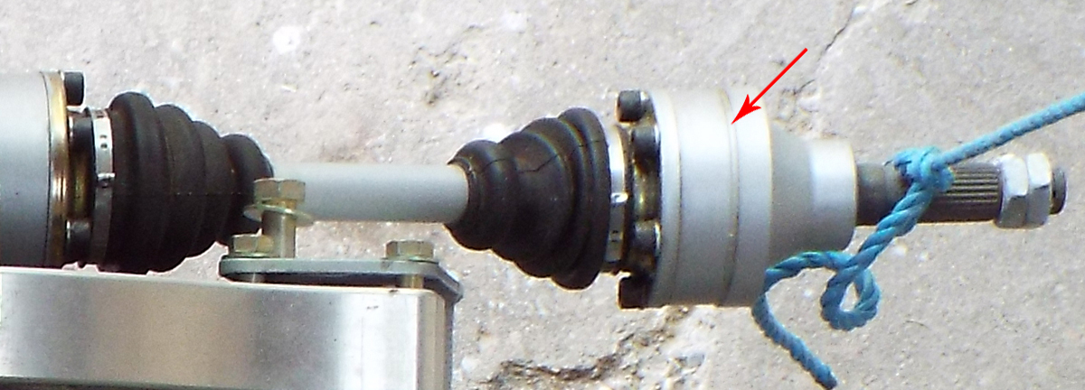

Not familiar with this type of driveshaft , do I remove them by taking out the six allen bolts ?
I take it there is an oil seal so I don't get a gusher :confused:
Is it normal to get a bit of a drip from the joint in the pic ? bothends of both shafts. Over a period of weeks not in any great amount .

Oh and the rear end is off , with the tail lights disconnected , it'll be alright to start up ?
